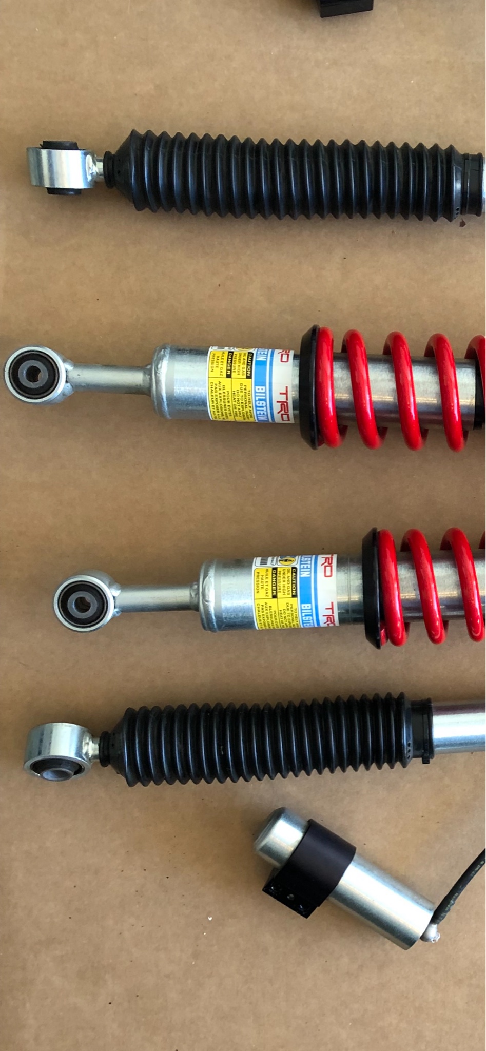

Just received the 14x3 600lb coils from a 6112 kit, I will be replacing the stock pro coils and the toytec spacers from the pro lift kit with these coils. I’ll post my results in a few weeks after the install.

No clip setting. The shocks are from a TRD Pro. They have no clip settings like the 6112 shocks. The rears I kept stock. Same as the front, just replaced the coil.
Great looking truck :) Are you sure about no clip settings on the trd pro ? Here are mine. The driver side is set higher for the driver [emoji56]
QUOTE]
That clip setting on the Pro shocks is only there to level out the driver side lean. As you they are set differently, left and right.
