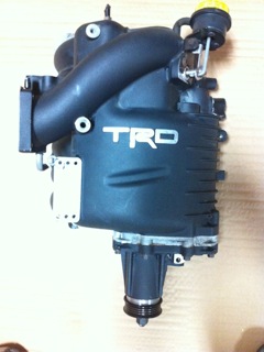

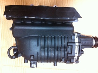

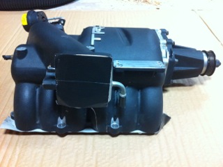

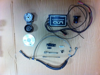

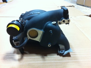

So I bought a TRD supercharger w/7th injector tonight, ill add pictures below of exactly what it comes with. It does come with the tensioner and manifold gasket but i don't believe they are in the pictures. The things that i know I'm needing are new belt, and fuel pump, I'm unsure whether to get the warblo 190 or 255?? I do plan on doing the 2.2 pulley but maybe not for a little while. Which fuel pump do you guys recommend running? Am I fine with my stock injectors with? Do i need to get oil for it? I would like to do the install myself, are there any tools that i will need to order to complete this install? Also after I install it am I going to need to tune it or should it run correctly if installed correctly and run 91 octane fuel?? Anyone in So Cal area that would like to help install that has completed this before?

Based on the pictures above you are missing the tensioner bracket and bolts. I really hope they are just not pictured because they are not sourceable besides the complete tensioner kit which is about $250. Also you will have to splice wires and solder them in for the 7th, so if you don't have experience with that then find someone who does. You don't want to goober up the ECU at all. I would suggest getting some new oil before putting it on and pending the mileage I would replace the coupler in the supercharger as they tend to wear out over time and very easy to replace.

So true about the tensioner bolt. The SC that I bought is missing that flat head bolt, holy crap that thing is impossible to find. I'll probably be ordering the $250 kit next week, all for a $5.00 bolt.
