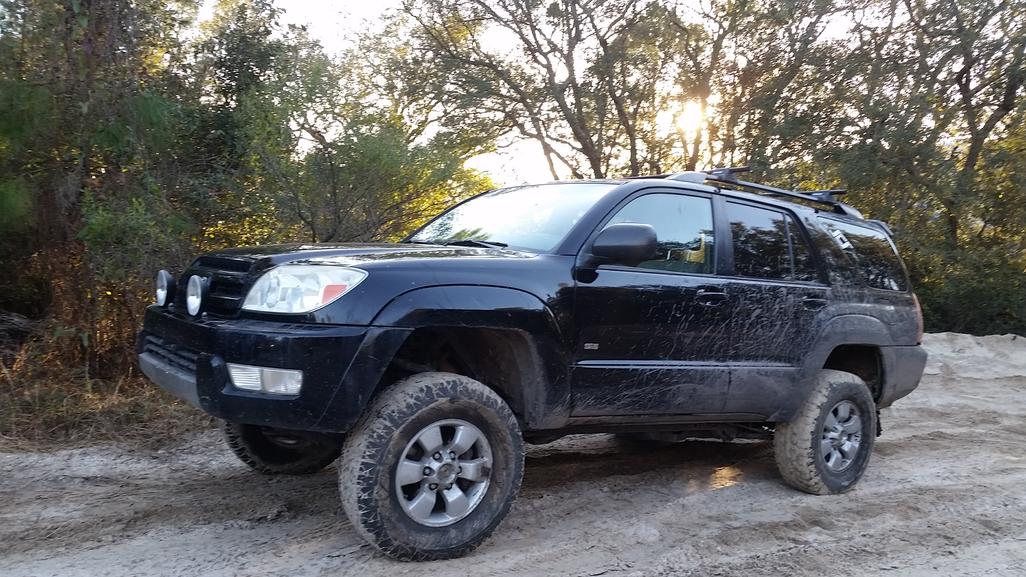

2012 trd tacoma shocks and 1.5 inch spacer
265/75/16 BFG rugged terrains

im running the same tire as above but 255/70/18
stock
IMG_20140321_131046_zps1e185998.jpg~original
trd offroad coils on 5100's set at .85
