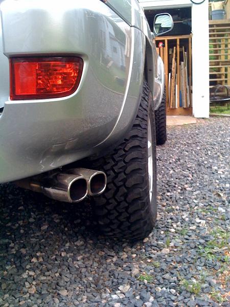

***I took my rear mudflaps off but I am concerned about the opening thats there. Has anyone devised a housing that can cover that?????****
you can trim the mudflap off right where it goes to a single layer of plastic, start from the inside and follow the line on the flap, you can do this with a pocket knife or razor blade, heres a pic i can send more if you need. it keeps the hole filled and removes the lower part of the flap.
Awesome dude... I was thinking of that but wasnt sure if I would "eff" it up....looks good.. would you mind posting some more pics of it? Thanks again!
