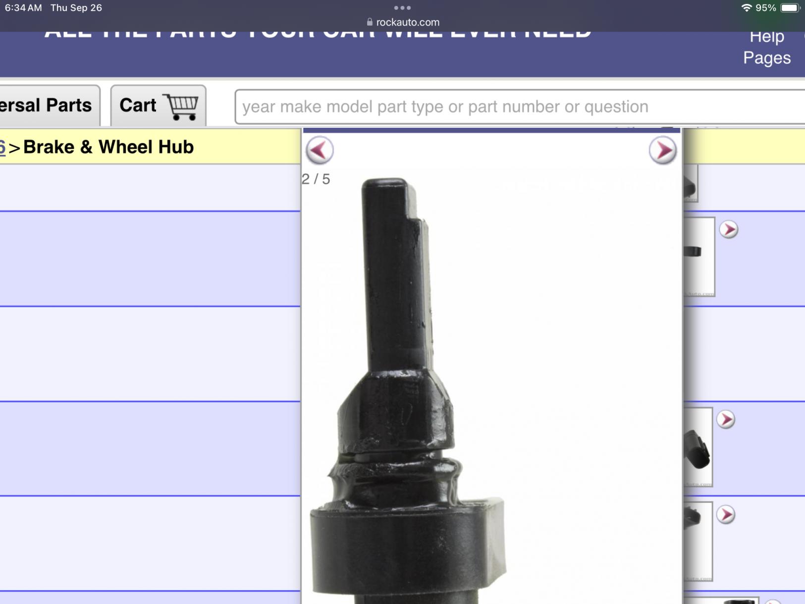

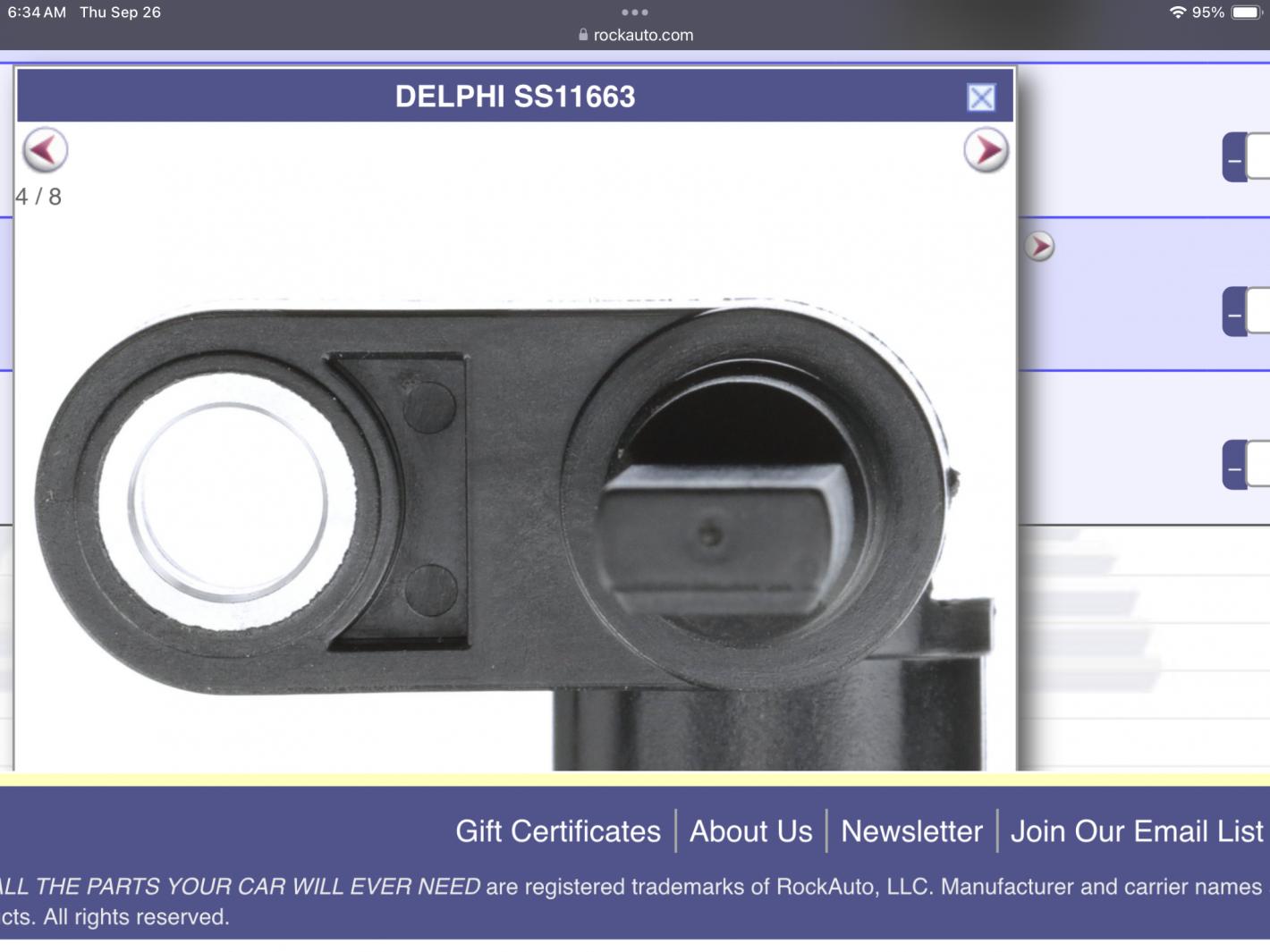

Find a drill bit that matches the diameter of the new sensor ream the hole. Open the hole so the sensor can fit. The tolerance isnt that specific for the sensor to function. Its more important that it seats to the correct depth.
That said, are you sure you dont have the drivers side sensor?? IIRC there is a step in the hole that aligns the sensor. If you have the wrong sensor, it will not seat the full depth. Double check yours
I managed to clean the hole out with a dremel wire brush. The sensor fit it nice and easy. I have the connector plugged in and went for a drive. I figured the ABS light would reset and go away after some driving but it didn’t.
