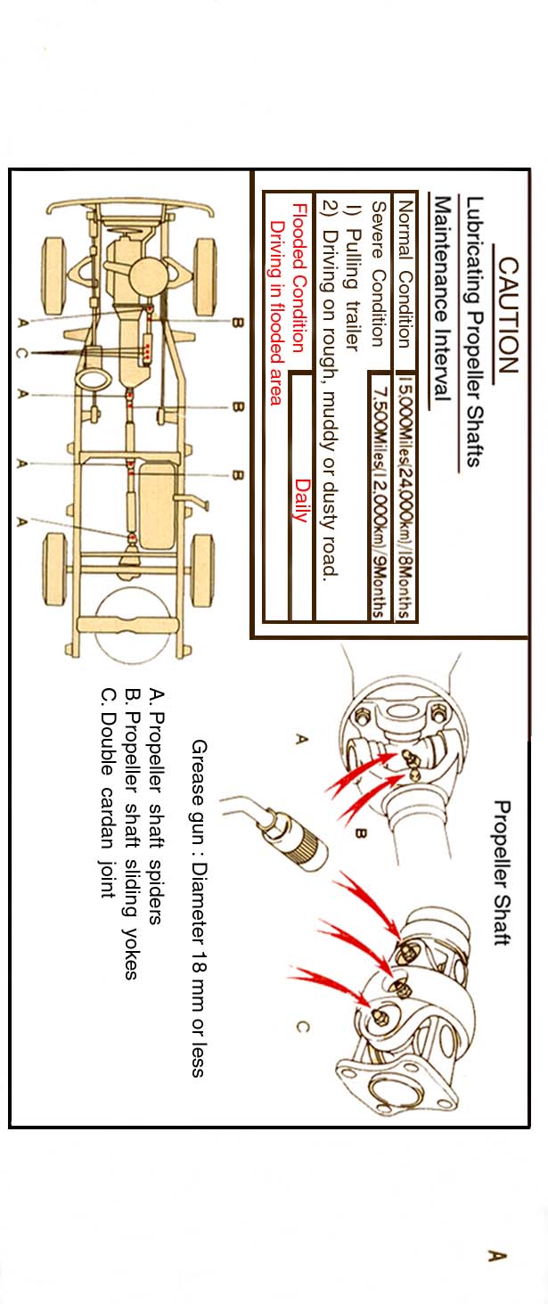

Truck/4Runner grease diagram (on driver visor)
Johnny0
I scanned this almost 2 decades back. Just found it for my son. if you print it on heavy weighted paper it is identical to what came stock
I have a high resolution scan of this at 2.7 MB. too large to upload here. I can email if anybody wants this version
