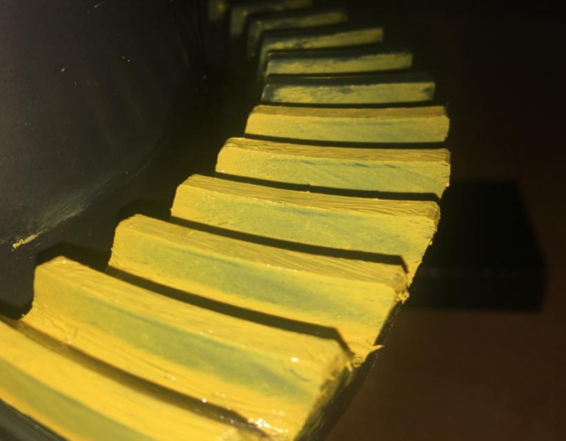

I am wrapping up My TrueTrac install. The pic attached is my current drive side pattern. Looking for some thoughts. I may try and move it to the center a little more. Carrier Bearing Preload is about 5 to 7 inch-pounds. Pinion + Carrier Bearing Preload is around 12.5 to 14 inch pounds
Thought I would post before I close it up for good. I have taken a lot of pics of the process so I can create a write up on a rookies approach to the install.

Pattern looks acceptable. A little more inboard would be ideal, but I think you're good with what is shown in the photos. What's your backlash at?
I didn't check the backlash yet. It is kind of a pain to set up the gauge so I was just trying to get the preload and pattern right. Now I wish I had checked it.
But I agree. I will try and get it a little more inbound.

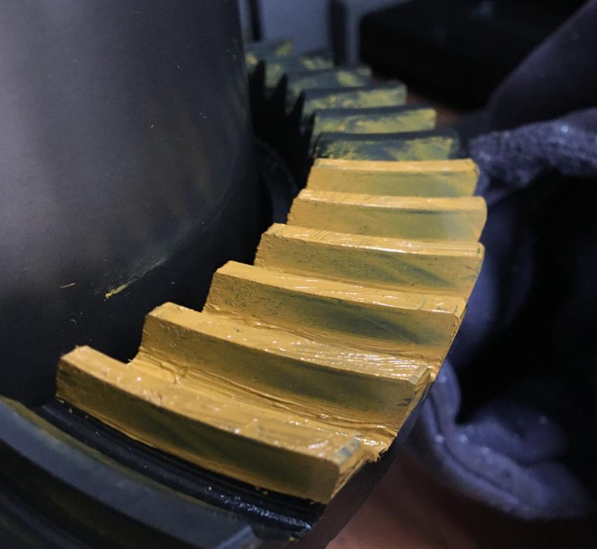

Current Pattern
I took the make up shim on the bowl side down from 0.02" to 0.016", while still using the factory shim on the lid side.
Backlash = 0.007 inches.
Pinion Preload = 7.5 to 8.75 in-lb.
Pinion + Carrier Bearing Preload = 8.75 to 10 in-lb.

Looks dang good to me. Nice work!
