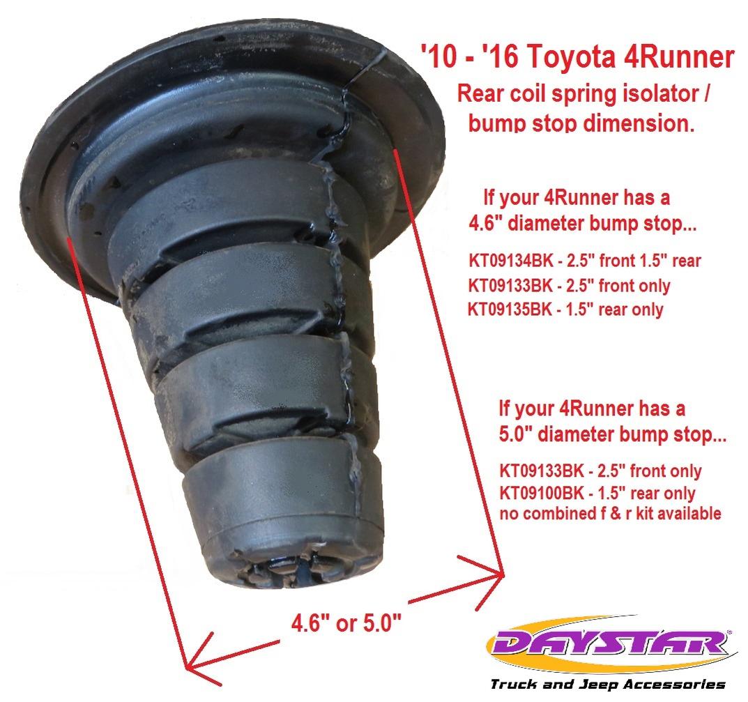

Hi Everyone,
I've researched the issue with the rear bumpstop fittment on '10-'16 4Runners. According to Toyota, there is only one part number for the 4Runner rear coil spring isolator / bumpstop.
Having said that, I've found that there are 2 different dimension bumpstops in use that will determine if your rear coil spring spacer will fit or not.
Most 4Runners have an isolator with a 4.6" maximum diameter top ring (not the topmost isolator part).
We have recently found some with a 5.0" maximum diameter top ring.
The 4.6" diameter ring will use Daystar kit KT09135BK (rear only) - KT09134BK (front and rear) - KT09133BK (front only).
The 5.0" diameter ring will use Daystar kit KT09100BK (rear only) - KT09133BK (front only) - no f & r combo kit available.
See the attached pic for where you should measure your bumpstop.
