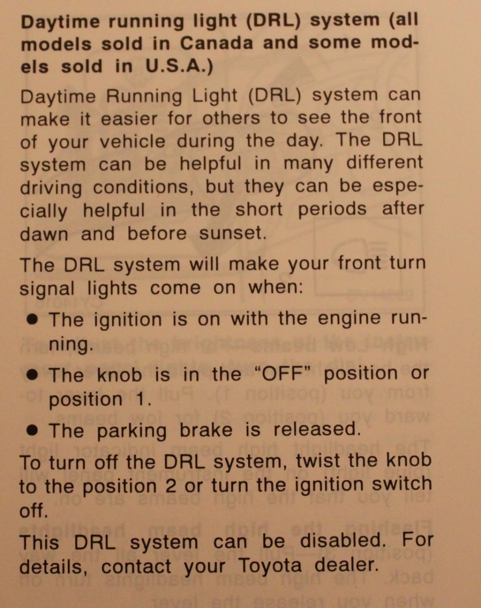

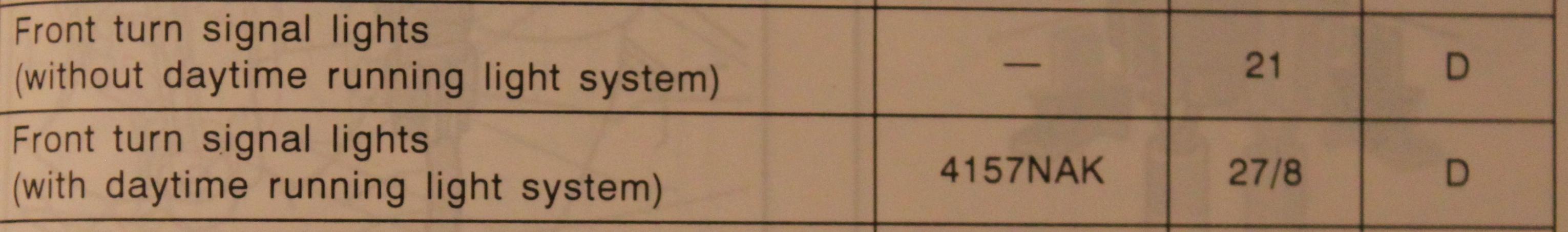

Here is the only thing i could find in the book.
sorry not much help.

The only thing i could find in the manual actually states, take it to the dealer to disable.
I would guess that's Techstream? The dealer uses. I know nothing about but there is chatter here on the forum about it.
AWESOME, thank for the picture, I couldnt find anything in owners manual. and this morning I did stop by the closest dealer (mountains states toyota) they said NO, we wont do that. Thanks again I will try this.
