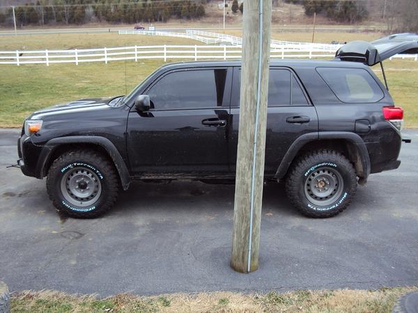

I took the 255/80R17 BFGoodrich KM2's on FJ Cruiser steelies off my FJ40 and put them on my 4runner before the lift and they fit with no rubbing at full lock turns. Articulation would more than likely have caused them to rub, but that was all pre-lift. Those KM2's will be my next tire when my A/T's run out of tread.
I think I have some pics of those tires/wheels on the 4runner in My Garage if you wanna see, put they are not so hot cell phone pics.

lets see those pics.. something worth considering depending on looks lol

Like I said they were quick crappy cell phone pics. There are a few others in my members photos section but not of good quality. I did this last winter on a whim and it was too cold to take detailed pics (I hate cold weateher :D )
This was before the lift and before the SpiderTrax spacers I am running now. I think spacers with this wheel tire combo would be needed to make it "look" right. This was also before the fender liner mod, and on paved roads all went well. i did not take it off road.

that actually looks pretty good. def goin w the km2 when my duratracs wear out.
