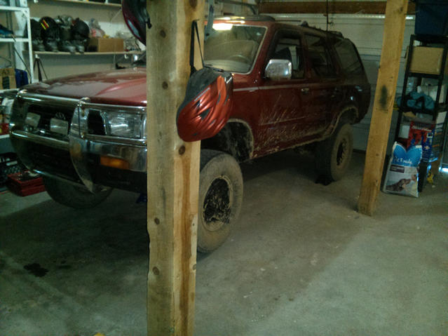

Putting it up today and starting on dropping the diff and oil pan to verify.
EDIT: We'll see how it looks. If the bearings are worn but the crankshaft measures out good and doesn't look awful, I may just replace the bearings. If the crankshaft is beat up I may go for a used reground shaft. The rest of the engine appears to be in good shape at this point, HG not leaking, etc, so for the sake of time and money I may put off a full rebuild.
If I find upon opening it that a bunch of stuff is hosed, out it comes.
Time to get this party started!
