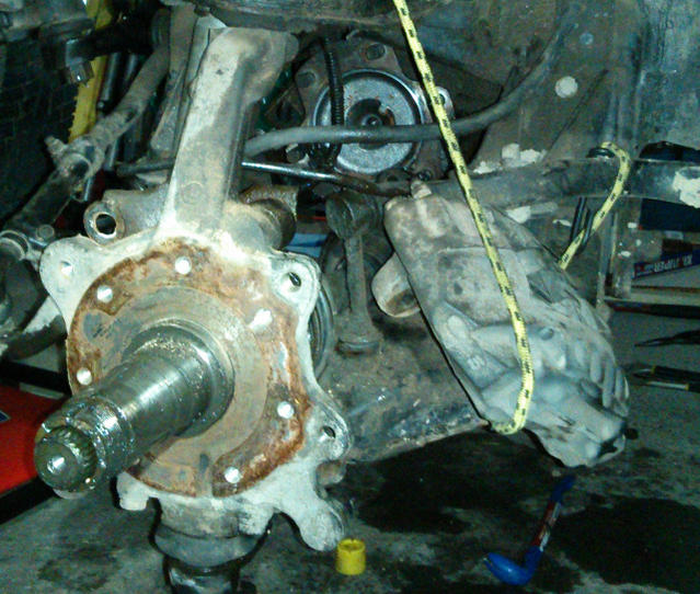

I'm having some trouble loosening the propeller shaft, can't use my 2' torque wrench because of lack of space. I soaked it thoroughly with PB Blaster and will try later.
As you can see in the photo, I'm removing the bracket that holds the brake line, as the brake line is in my way for getting a socket around the castle nut. Once that's done I ought to have the castle nut off pretty quickly. Am I going to need a way of pushing the arm down or something to get clear of that bolt?

The top arm is tied to the torsion bar, so before you pull anything off, jack the control arms as high as you can, then stick something thick between the top control arm and the bumpstop to shim it. Then when you unbolt the ball joints, the lower arm will just fall away.

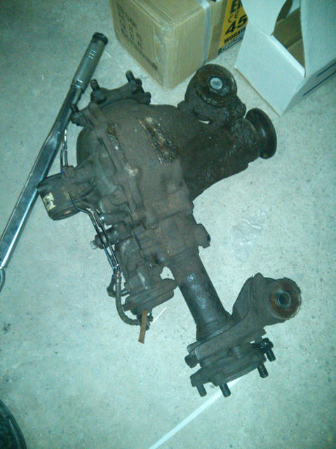

Success! Diff dropped (literally), despite using the jack. Next time I'll take it off with the support bar. Luckily it didn't fall very far and looks OK. Oil draining now.

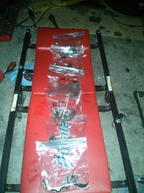

Success! Got the rod bearings out. A few of them look a bit rough around the edges, but none of them wore down to the copper. I just need to measure the crankshaft journals with some calipers to double-check and then time to order some new bearings. Makes me worry maybe the main bearing is going or something though. Need to figure out how to check that.
EDIT: OK, I need to get some plastigauge and check my rod bearing clearance.
QUESTION: Can I take off the main bearing cap while the engine is in the car? Will the crankshaft stay in place? I guess if it will then I can't check the upper bearings anyway. Hm.

yes, you can pull the mains. just do one at a time.
also, you CAN get the upper bearing out. loosen ALL the caps, but only remove ONE. then use something like a thin plastic ruler, or even a wood shim(anything but metal) to push against the bearing. it will spin around toward the bottom and fall out. installation of the new bearings is just as easy.
oil it up, stick it in place, and spin it around until its on top.
Awesome, thanks!
