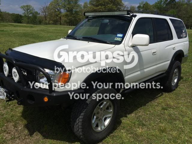

I got my 1996 SR5 in November 2012. Her engine was rebuild at about 242000. I removed the running boards and started painting and touching up all the plastic trim...then nickel and dime'd it over the next few months.

I did most of the work over Christmas and Spring breaks. I am really looking forward to summer...three best reasons for being a teacher? June, July, and August. I've got a lot of parts sitting in the garage, so here's the to do list
Suspension:
OME 3", diff drop, new lower ball joints, ITRE, OTRE installed.
LR UCAs installed, rack bushings installed, guide installed and lower control arm bushings installed.
Locker:
Aussie Sitting on shelf. Probably get to this toward the middle of summer. Gonna replace a lot of things in the rear....still researching.
Interior:
Gonna rip everything out and pressure wash the interior along with the carpet (done), install new front seats, cup holder/arm rest mod, and install the stereo (installed)
Armor
4xinnovations front bumper and sliders installed and painted.
Researching skids...
Other:
B and M Trans cooler sitting on a shelf (done). Deck plate Mod (done), Big 3, almost finished with my satoshi mod (finished)...and I've got a CEL for both knock sensors (fixed). I'm going to replace the harness and hope that is it before I spend the cash on two new sensors. Need lights (got a few)...roof rack...rear spoiler (installed)...winch (bought)....tires (got a good deal on some)...weather tech (Merry xmas to me, thanks dad!).
I also have a bunch of parts for the projector retro-fit sitting around because I...can't do that damn mod..
That's about it...for now....
