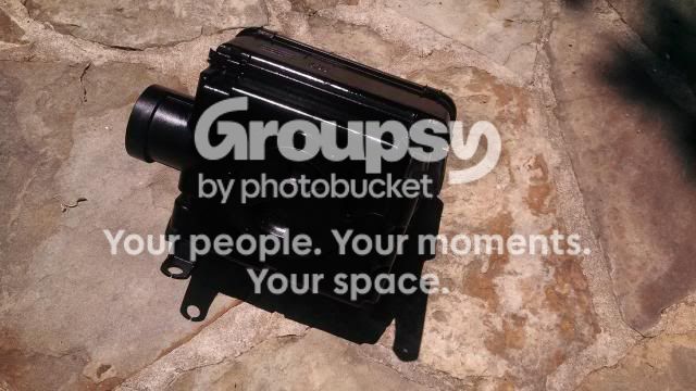

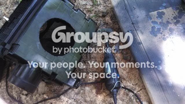

Well I woke up late today and with a headache so I decided to do something easy. I've been saving the deckplate mod for a day like today so here it is.
buildpictures017_zpsd02b82ce.jpg~original

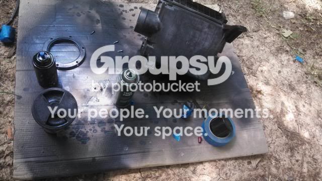

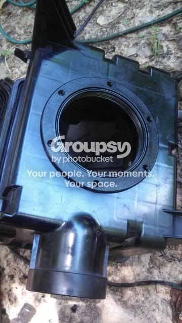

A little Dremel action a hole saw woulda been easier but I didnt have one and I wasnt going to the damn store today.
buildpictures018_zps495edb10.jpg~original
Test Fit
buildpictures019_zpsd79845b2.jpg~original

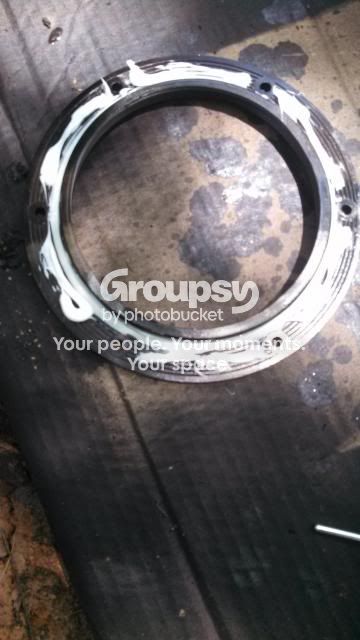

Silicone
buildpictures020_zps462aa985.jpg~original
All Done
buildpictures021_zpsb478b168.jpg~original

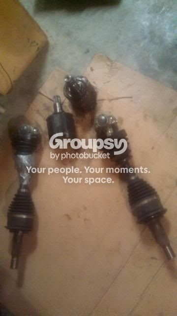

I guess I will be rebuilding these by the end of the summer or maybe it will give me something to do Christmas break. Any suggestions on what type of reboot kit?
2cv_zpsd9bd977d.jpg~original

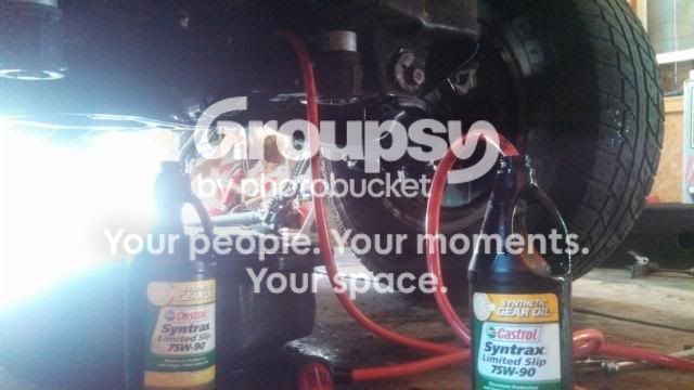

Got the diff fluid changed and put in the relay so I dont have a fast blinker anymore. Now headed into town to find a harness for this radio.
I tilted her up to get all that fluid out. Its was black!
cv001_zpsb0930861.jpg~original
I read a few write ups on this and was happy to say that both my fill and drain plug came out with little effort. The fill plug was 10mm hex but the drain plug was 19mm nut.

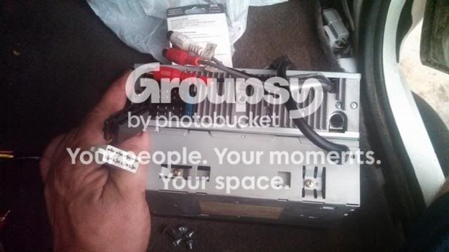

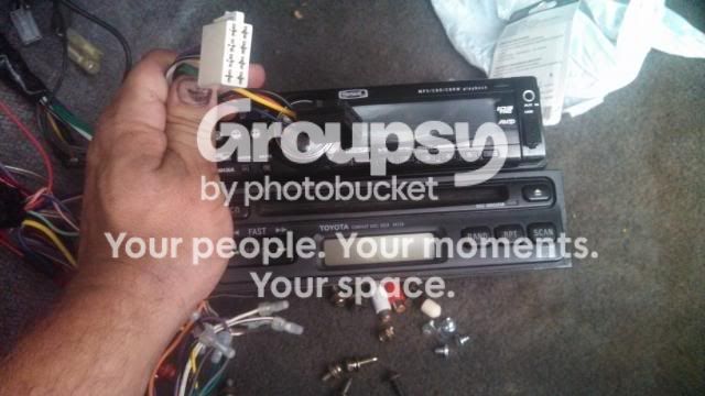

On to the stereo!
This is what came out.

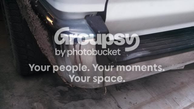

oh yeah and i gotta fix this too...
bumper_zps6d3538fc.jpg~original
Congrats on making it to state!
Nice job on the runner. Keep up the good work. I'm following along as ill be doing the trans cooler and stuff once I finish interior.

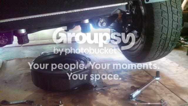

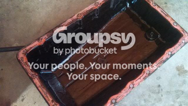

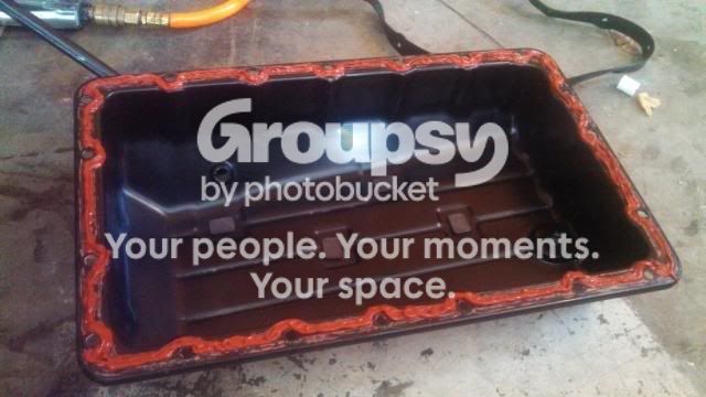

Trans pan before
transbefore_zpse210b4da.jpg~original
After
I almost used the gasket that came with the new filter but it sucked...
transafter_zps97b6b551.jpg~original

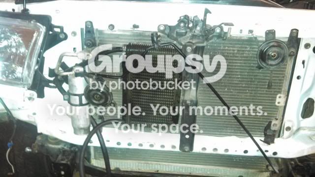

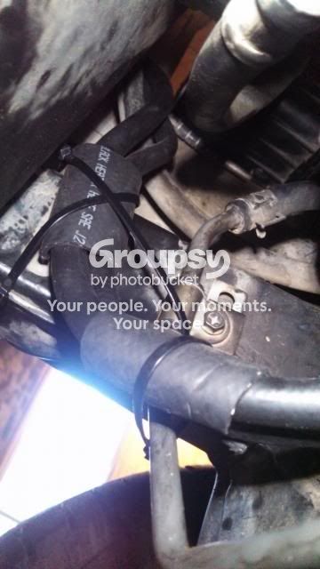

Trans cooler pretty much installed. I changed all the fluid while I did this. I followed BFAD to the tee.
bandmtransinstall_zpsb7ce7f76.jpg~original
bandmcloseup1_zps1805d5a2.jpg~original
bandmcloseup2_zps9c674e81.jpg~original

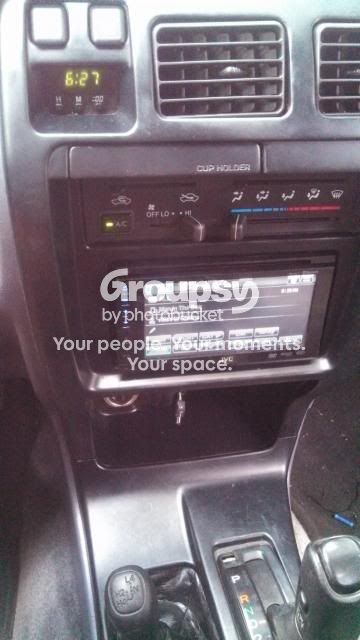

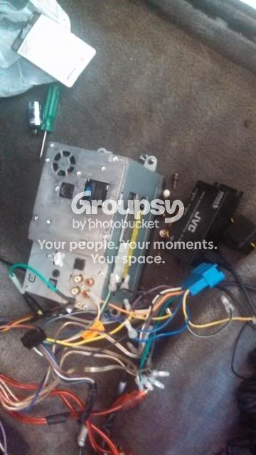

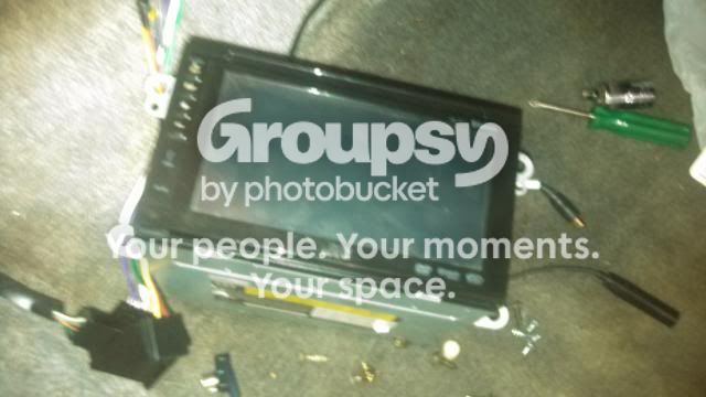

Radio Before
radiobefore_zps14f9571d.jpg~original
Radio After
radioafter_zps9b323ecd.jpg~original

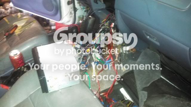

As it turns out, the guy who put the crappy aftermarket system in just cut all the wires and twisted and electrical taped everything together...no harness at all! So basically I did the same except with butt connectors and crimpers. I think I need to reground my amp and find another acc for the hot on the radio otherwise it almost sounds great, but it looks awesome. I love the clean interior lines of the early 3rd gens.
