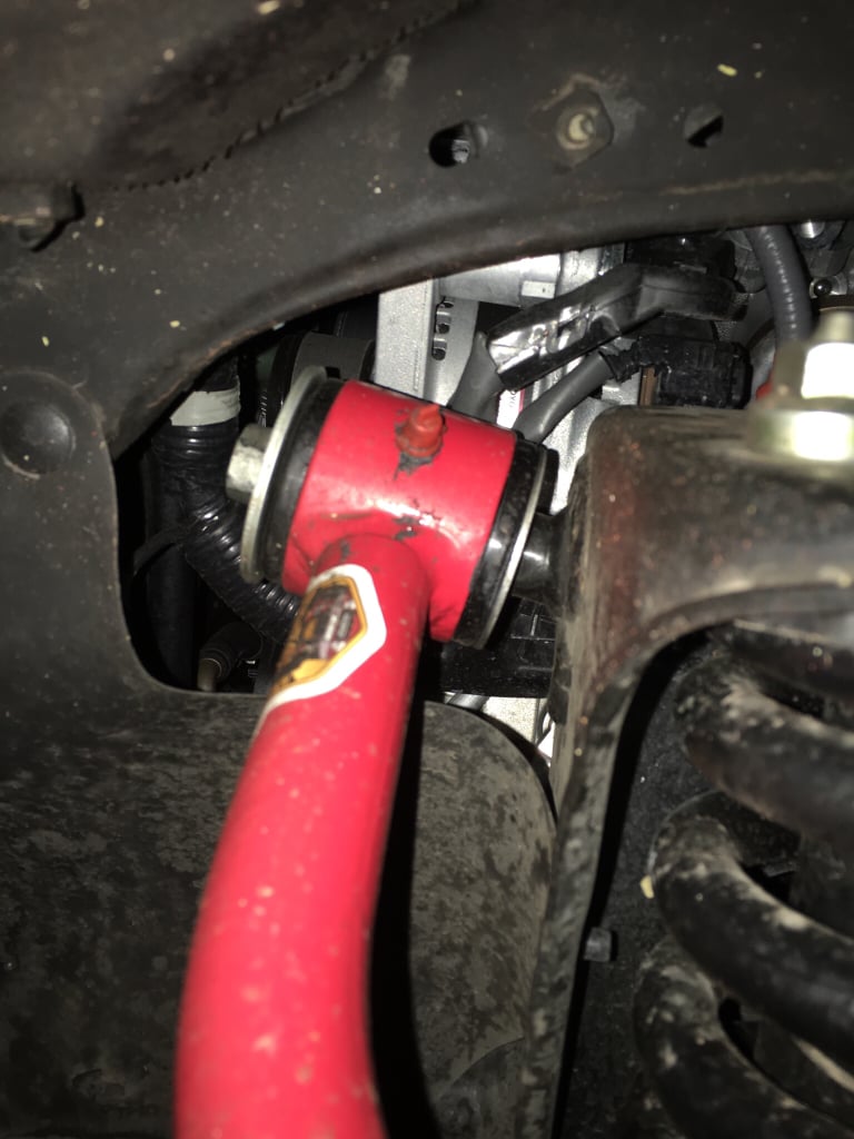

Just did a further inspection of the UCAs, and I noticed this:
It looks like a small tear in the bushing. I can move the small flap. As a reminder, I torqued things to spec as the vehicle was in the air. This is my first suspension job, and no where in the instructions did it mention to have the vehicle's weight on the suspension before tightening. Followed them to a T for better or worse. I missed this common knowledge somewhere along my shade tree mechanic'ing. As another reminder, I drove it this way for about 800 miles before redoing the preload on the bushings, ie. loosened the through bolt, cycled the suspension, and then torqued when the vehicle was on the ground.
Can this small tear be the source of the creaking? What is the likelihood that the bushing was destroyed when the 4Runner was returned back to the ground during original installation? I've spoken with a few mechanics by trade, and they've all mentioned that it would take some extended driving for the bushings to be destroyed, but it would happen much faster than if the installation had been done correctly. I mean, I guess there is no way to see if there is more damage without removing the whole arm(s), but anyone have a couple cents to add here?
is there supposed to be a zerk fitting where that set screw is?
*edit - I guess that might be for an optional zerk if you choose to run poly bushings
Yes, but I believe that is in case an owner decides to go with something other than the stock Toyota style rubber bushing that comes with it, such as polyurethane. From everything I've read, JBAs should be quiet right out of the box. This is their hallmark.
Not sure if I'm clear on your question. I greased the ball joint as JBA's have zerks there for easy maintenance. I greased the ball joint after I lowered the vehicle back down and torqued the uca through bolt to spec. They do not have zerks on the bushings since they utilize stock rubber bushings.
You sure you have JBA’s? I just installed them on my 2018 and they don’t use stock rubber bushings and they most certainly have zirks on them.
I called JBA and spoke to Marlin about torquing them with droop and he said it isn’t a huge deal because of the type of bushing they use. I did use my floor jack under the spindle and lifted it up before torquing the bolt. I didn’t think I could do it with the wheels on and on the ground. Mine are silent.
When you used the large OEM washers on that long bolt did you make sure the dished in cupped area faced towards the bushing?
I just saw your photo. These look like an old version. The new ones have different bushings and zirk fittings.
Here’s mine. Zirk fitting with cover. Just bought a couple weeks ago and installed last week.
Must be a very recent update to their product. I purchased mine In the October time frame, I believe. Just installed towards the end of last month.
