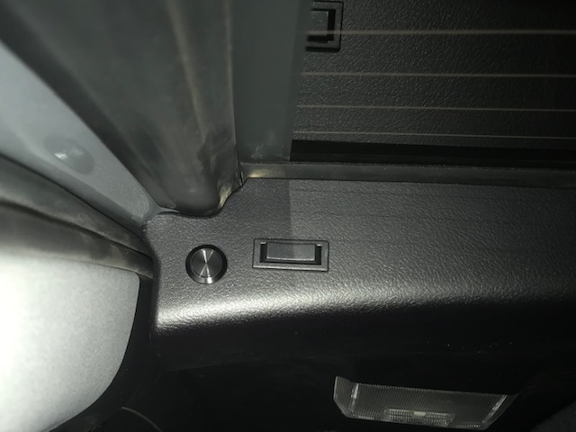

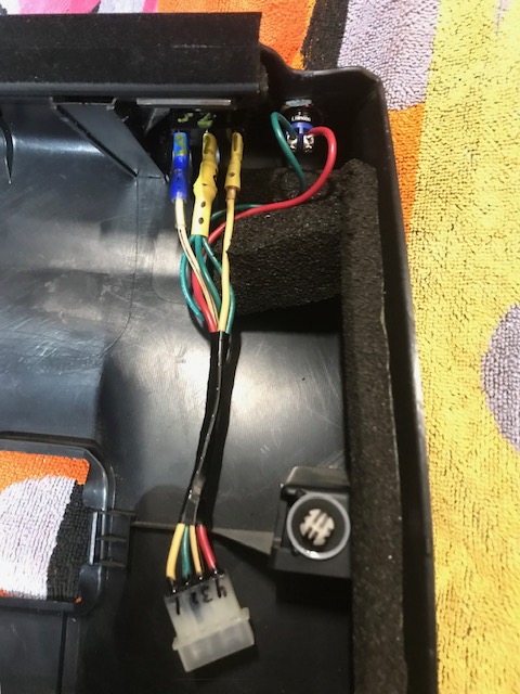

I ordered the kit last year and finally got around to installing it. However I tweaked it a little and used my own smaller rocker switch and low profile push button to be a little less noticeable from outside eyes. Installed them in the rear hatch sill. Wired through a connector for quick disconnecting the next time I need to remove the hatch trim panel.
Rocker E-Switch from DigiKey (ON)-OFF-(ON) RB14DE1100
https://www.digikey.com/products/en?keywords=EG5640-ND
Momentary Pushbutton Ulincos U16A1 black 16mm
U16A1 Momentary Pushbutton Switch Black Metal Shell for 16mm Hole | 16mm | Products | Ulincos
