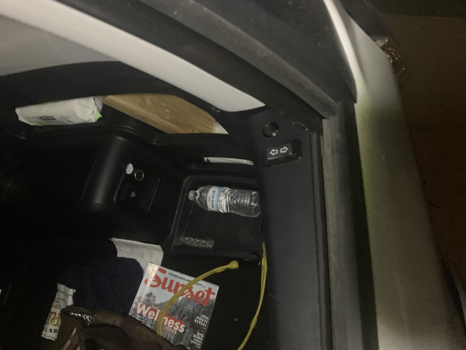

Some folks prioritize the switches being small and low profile. Less visible to prying eyes.

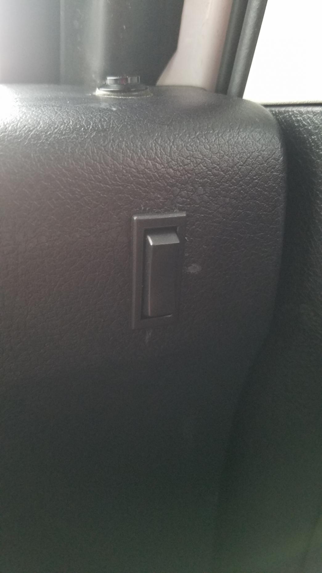

If I were to guess, it has something to do with the hole. A factory clean cut hole with a factory switch seated at the appropriate depths may be (too) difficult to accomplish in a spot not intended for a switch or unnecessarily costly for such a simple mod (factory switch, plug to fit etc). My switch was $2.50 or something, its discrete and installed easily with spade lugs. Im not a fan of the switch with arrows. Mine is invisible from outside the car but in a very useful spot when car camping.

Points taken....I like the idea and would have the switches hidden under my Canvasback cover to mitigate the risks of visibility.
