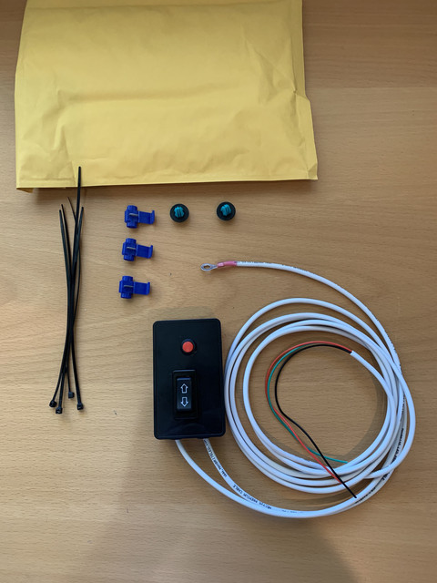

Sold the first hobby box kit! I am curious what peoples thoughts/comments are on it.
Looking at the setup photo, you could make it a little cleaner with only one cable coming out of the hobby box. Eliminate the second cable that contains the ground wire by using a 4 conductor cable instead.
I considered that, problem is I'd have to strip the jacketing say 5' from the box and pull the ground wire. I would have another 10' or so of cable after that and it would be a pain to pull that cable if at all possible. I could leave the additional strand in the run and just splice, but it would make it even harder to run the cable if it has a larger OD. I wish it would work easily! Maybe I can do a splice with two different cables?
Thanks for this Kit. the instructions were very good and clear and the install was pretty simple. just takes time and patience to do it cleanly.
I did redo a few of the connections and change everything to heat shrink tubing, but thats only because I am OCD about electrical work and hate electrical tape.
The instructions are truly what make this kit worth it.
