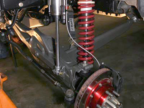

Not that I take it as an attack...but the fact remains, other than a complete tube chassis setting the engine back over a foot or two, to narrow the frame enough to set the pivot points of an A-Arm front end together close enough to increase travel over the 12 to 15 inch range...you WILL NOT find a stronger, easier system, with less breakage because of geometric issues, with a broader selection of gearing...and the most travel than this...if tire wear is a concern at this level of modification(s)...you will probably ask how many miles to the gallon a Corvette gets too.
