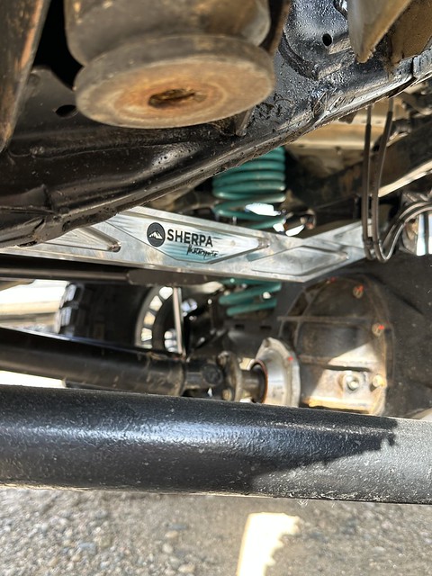

We have new billet upper rear links in the car now as well as some gorgeous new Nomad Sahara Forged Beadlocks!
