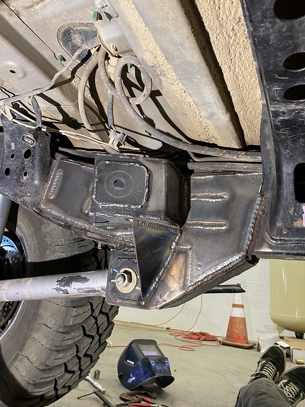

About 2/3rds through the second lap we were hearing a metallic light clunking sound on the rear of the car. It sounded light enough to not be a major component so we kept pushing on. Till I started to feel like the rear of the truck was getting sloppy. First thought was a flat tire. It was walking side to side a bit but no sounds. We pulled off and Will jumped out to check. No flats. So I told him to start crawling around the rear end and look for anything weird. I shifted into reverse and the whole body shifted. I knew immediately the upper link or mount had broken or had play. Will saw then that the whole upper mount had ripped out of the frame.
At this point, we did a quick inventory of what we had and deemed it stupid to keep racing so that we could keep the car in better shape and do less damage before Ultra4 Nationals.
We called it there and started working up a recovery strategy.
We ended up using our spare tire strap and some other straps we had to center the rear axle and we were able to limp it off the course.
Here is where we sat and watched the rest of our race!
Here is the hole in the frame and the fix we did. This was also replicated on the other side as well.
[/url]Untitled by
Vs what it used to be
Always build stronger than you think you need to was the lesson learned here haha!
