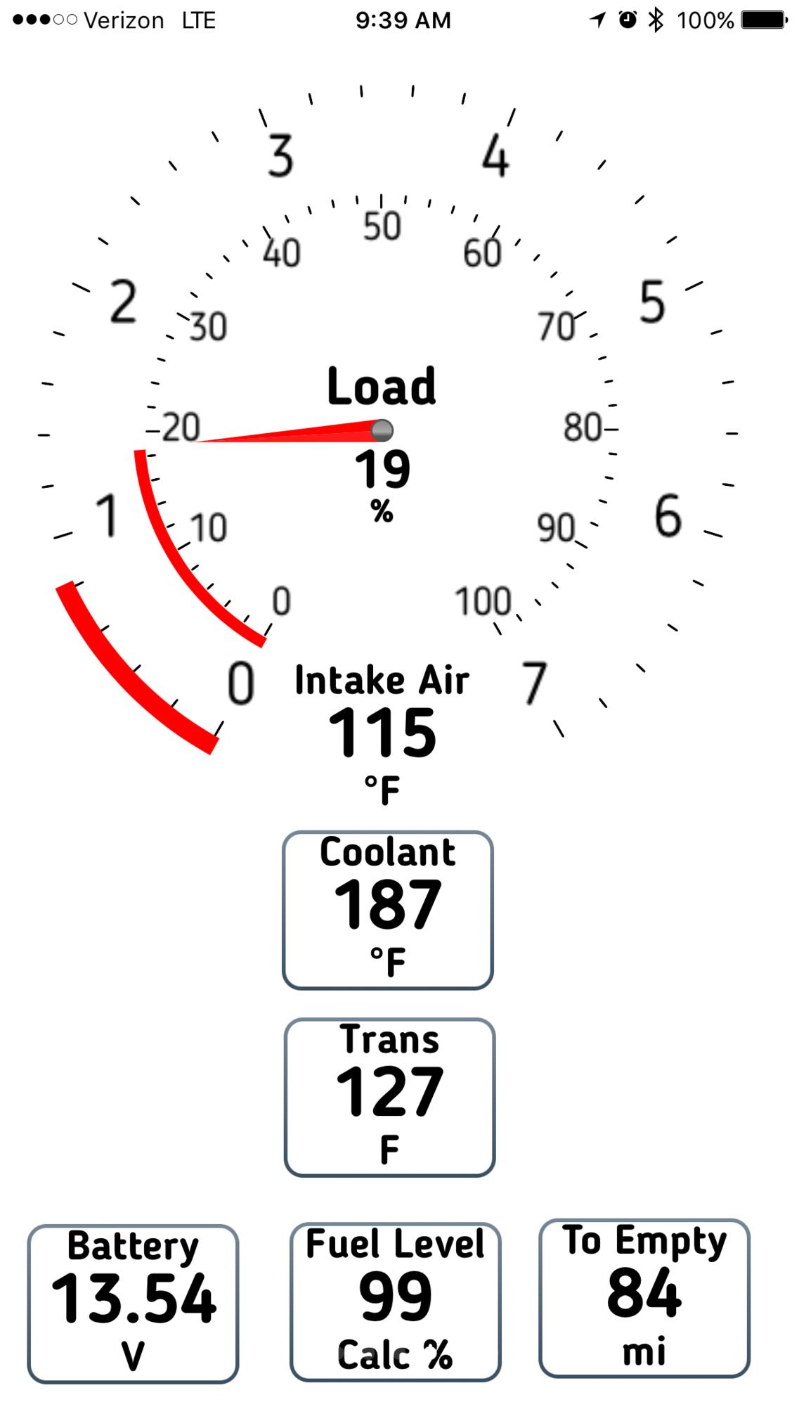

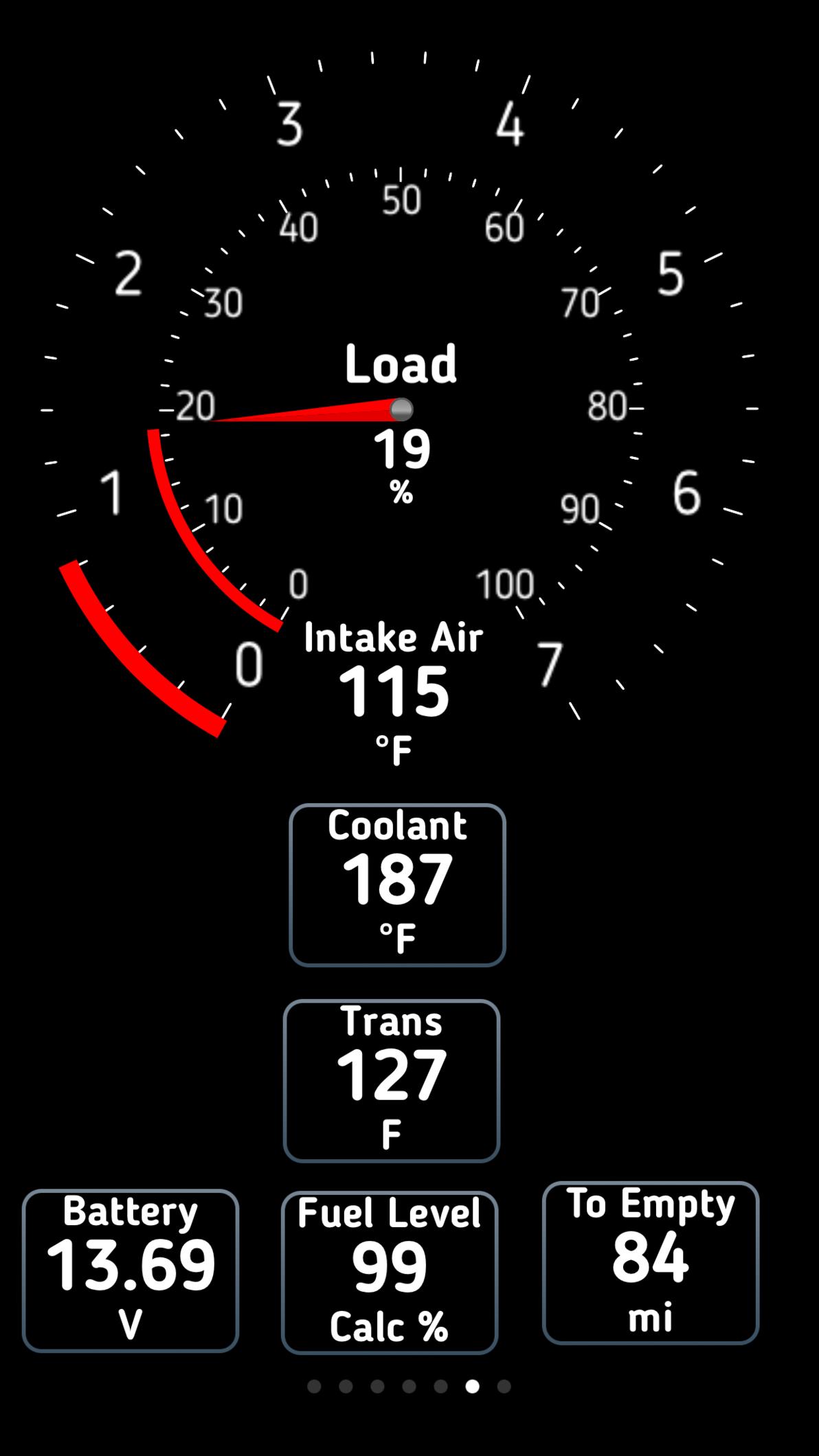

Hey Guys I have great news!
Last week I went ahead and purchased the Ultragauge Blue and downloaded the ultragauge app on my Iphone. I was talking with tech support for about a month before buying the ultragauge blue. They were not much help when it came to getting a PIDs for transmission temp for the 3rd gen 4runner. I know that people with the scangauge are able to get transmission temp using this PID.
Transmission Temperature F
TXD: 686AF101B4
RXF: 044105B40000
RXD: 2808
MTH: 00090005FFD8
NAM: TFT
Well I'm happy to say that the ultragauge app is able to read Xgauge. I was able to create a custom gauge with the data above.
I hope this helps anyone looking at getting the ultragauge set up. I was told by tech support that what ever I can do on my ultragauge blue I can do the same to the Ultragauge MX. I think the MX is harder to program vs the blue.
I bypassed the radiator and have the B&M 70268 trans cooler.
Thanks
Luke

Thanks Luke!
I just picked up 99 auto t4r over the weekend. This is my first automatic transmission I’ve owned in 10 years and want to keep an eye on that slushbox. Any idea if those codes will work on the wired v1.3 MX?
Hey brewmonger
I was told by support at Ultragauge that you can program Xgauge code onto the wired mx. Ultra gauge support is kinda lackluster for our 4runners :(....they told me this wouldn't work but I programmed it anyways and it worked out fine.
Thanks
Luke

Luke, a question for you.
Might you have coolant temp on your UG Blue? Curious how that differs from the tranny temp you added...
I've been in communications with UG and I was told, no surprise, that our 3rd gens use the 9141 protocol and that manufacturer gauges such as trans temp are not available via the 9141 protocol. Only OBDII standardized gauges are available for us, so I was told...
So, I responded that a few of us on this forum have had success in getting tranny temps with the Blue and MX options. I heard back that "there are a few codes running around out there that actually read the coolant temp and not the trans temp", thus my above ask.
Since [MENTION=198376]4Runner4Leon[/MENTION] is about to make a UG purchase, this might interest him too...
EDIT/ADD - Geez, you have an external tranny cooler, bypassed, with different readings for sure. Nevermind.

Before I did my 5-speed swap I was reading the Transmission Temps through my UG MX. The temps on my gauge were definitely NOT coolant temps (not only because I had the coolant temp displayed right next to the tranny temp) cause my tranny temps would spike when expected (up-shifting and down-shifting constantly up hills) and drop and stabilize when switching OD off. The tranny temp readings I saw were always about what I expected given the scenario.
I did NOT have an external tranny cooler by the way.

Indeed, the SG PID does the trick to get ATF temps. Here shortly after start-up.
Played around to create this fuel-focused one.
I imagine I'll refine more over time, but for now, quite happy. northwave161, thanks again.
