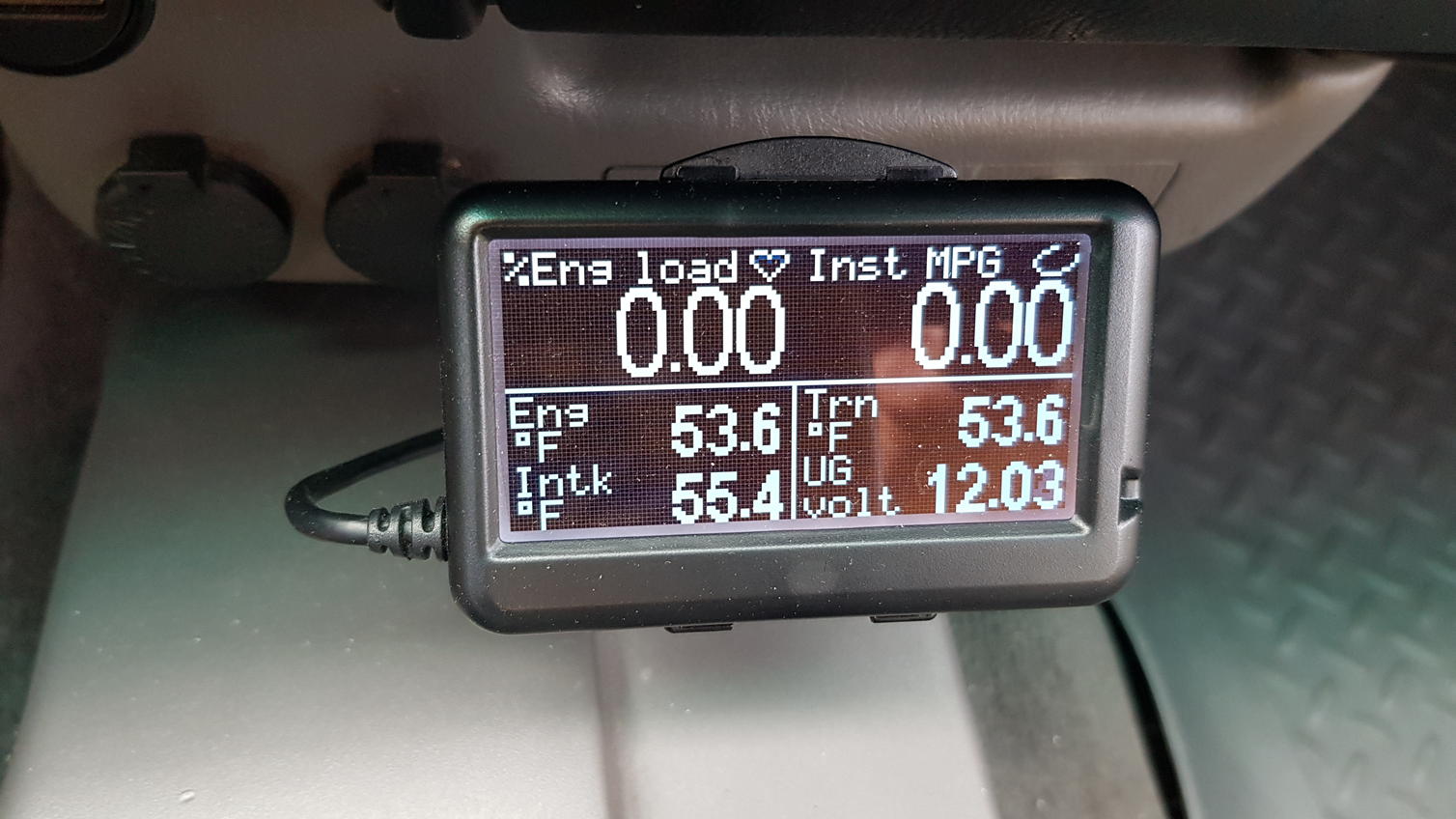

Display coolant temp, air intake temp and trans temp at the same time. When you start up a fully cold truck, they should all match (within a few degrees). That's really the only check you need.

To me if your trans temp and engine temp and IAT temp all line up after sitting overnight it’s accurate.
