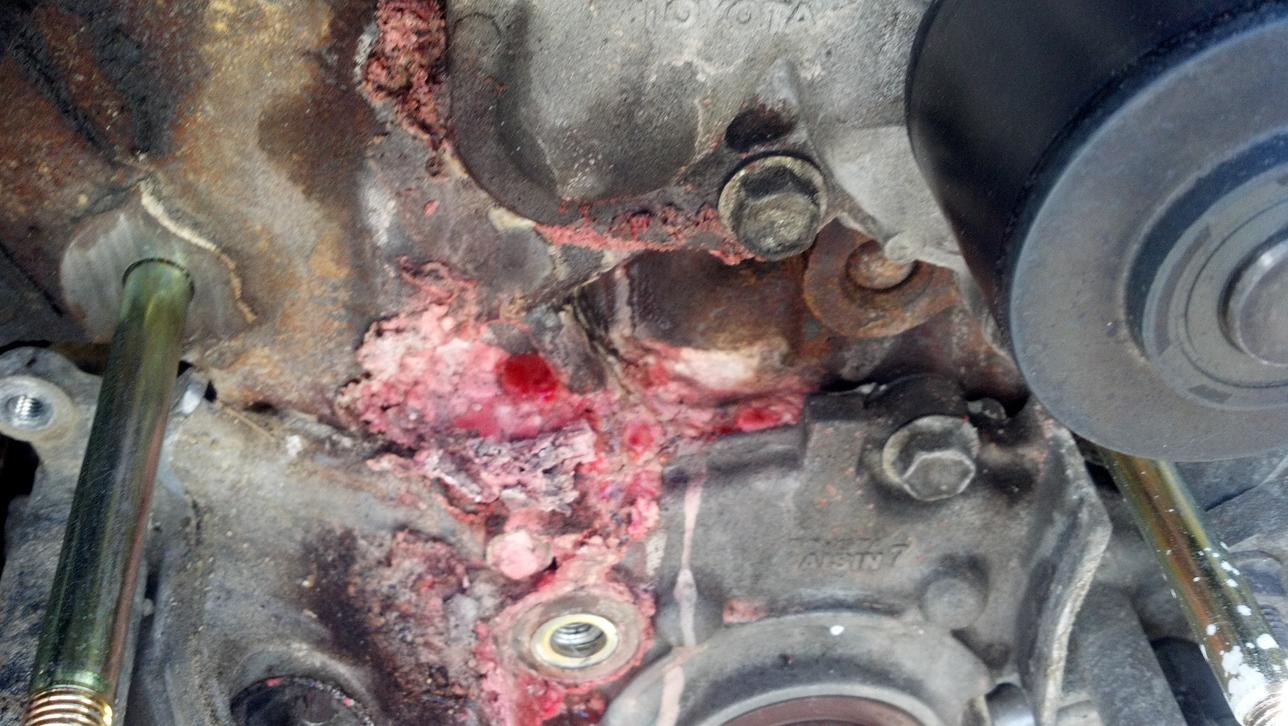

This is a pic of my original water pump, slowly hemorrhaging after 10yrs & 150k. Timing belt probably would have kept going, but who knows about that WP.

After 15 years and 105,000 miles, my WP does not leak at all. No loss of coolant. But the bearing is most likely on its last legs. The only thing that has helped prolong its life is that I installed a new OEM fan clutch three years ago. Steal on CL for $25.
