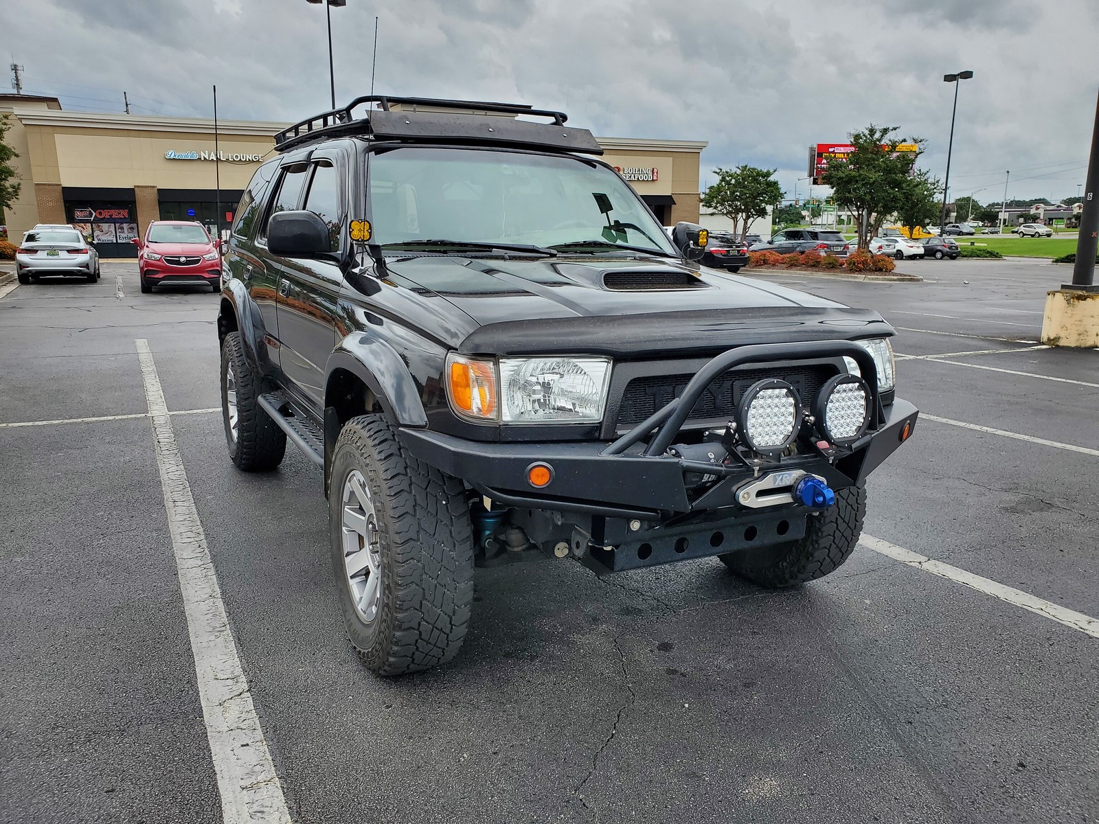

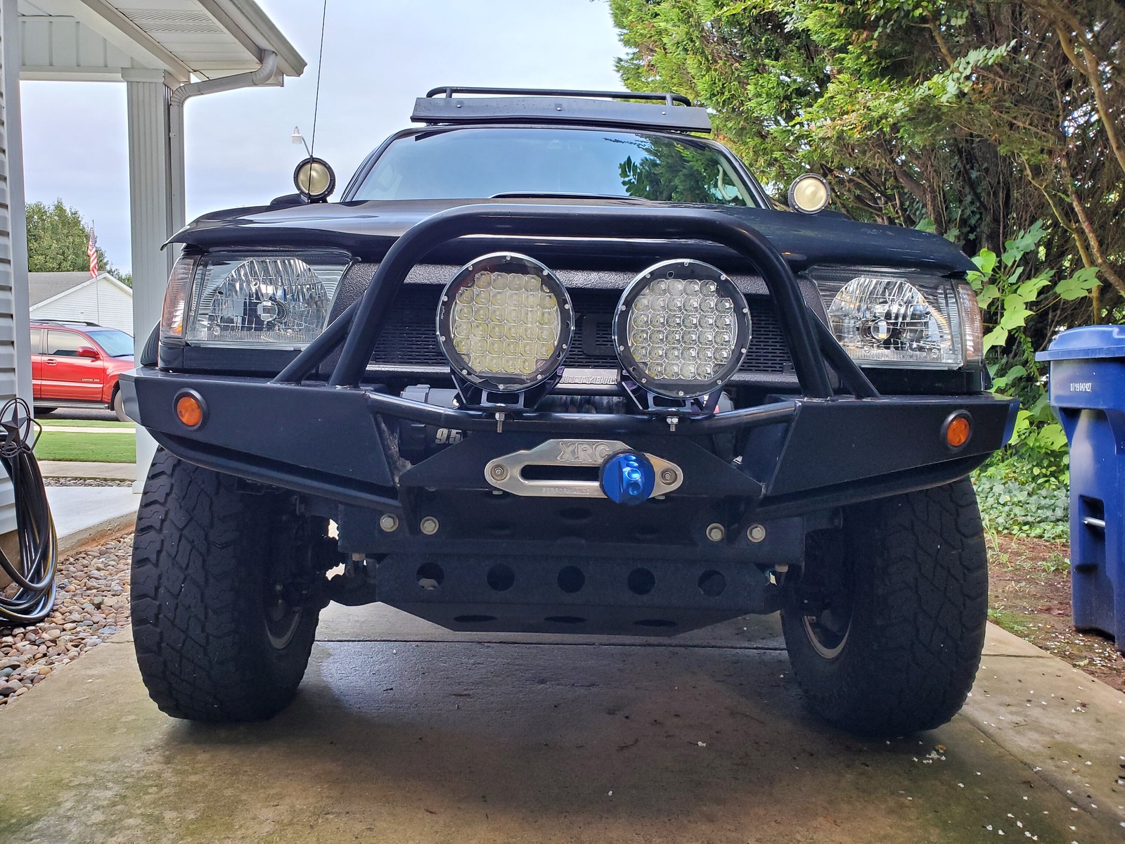

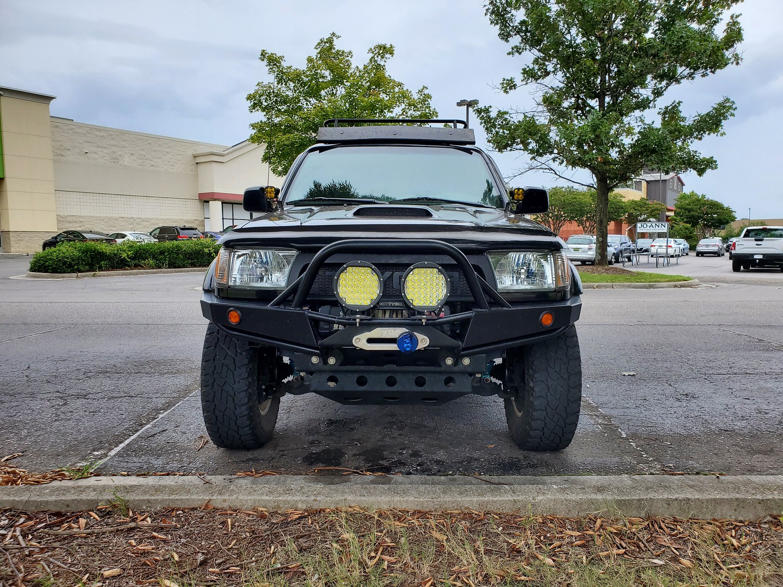

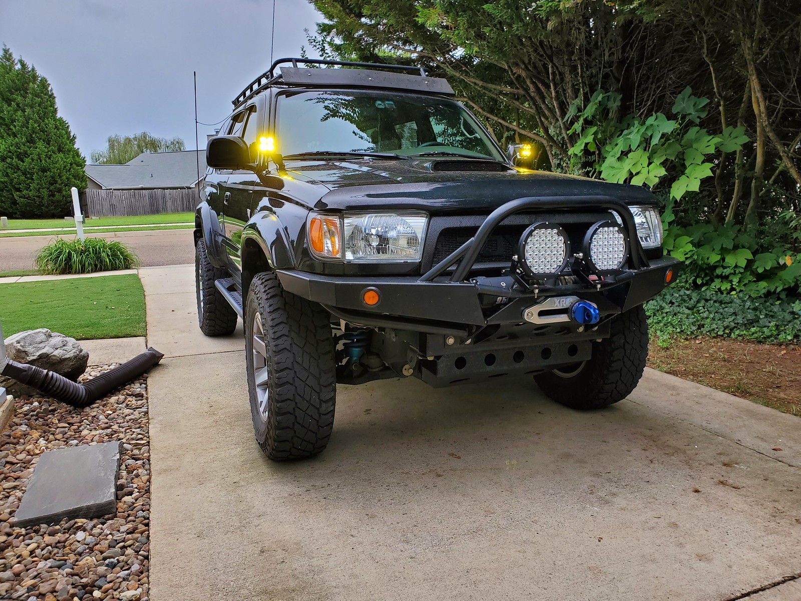

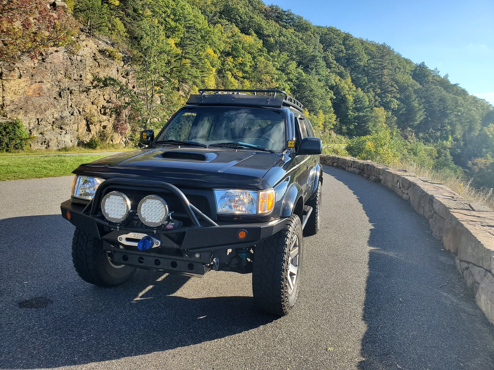

The Primelux LEDs are installed, security hardware is installed where possible, and they are aimed. The Primelux are wired to two separate switches to prevent drawing too much power through the stock fog light circuit. I like having one on there to allow for easy flipping on and off as high beams.
The Baja Designs Squadron Sport Amber Combo ditch lights are installed with security hardware, aimed and ready to go. I wired these into the same harness that the old MRT Vision X Clones were wired into. I did have to cut off the DT style connector and put on Weatherpack connectors. Had to buy the special crimping tools for them as well. The connectors are pretty easy to put together with the right tools though.
20210822_125302 by Unner Unner, on Flickr

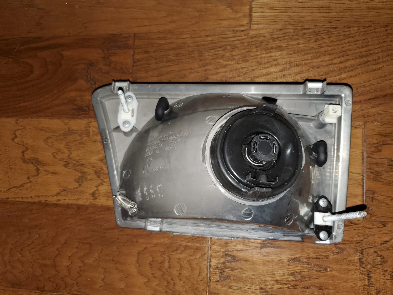

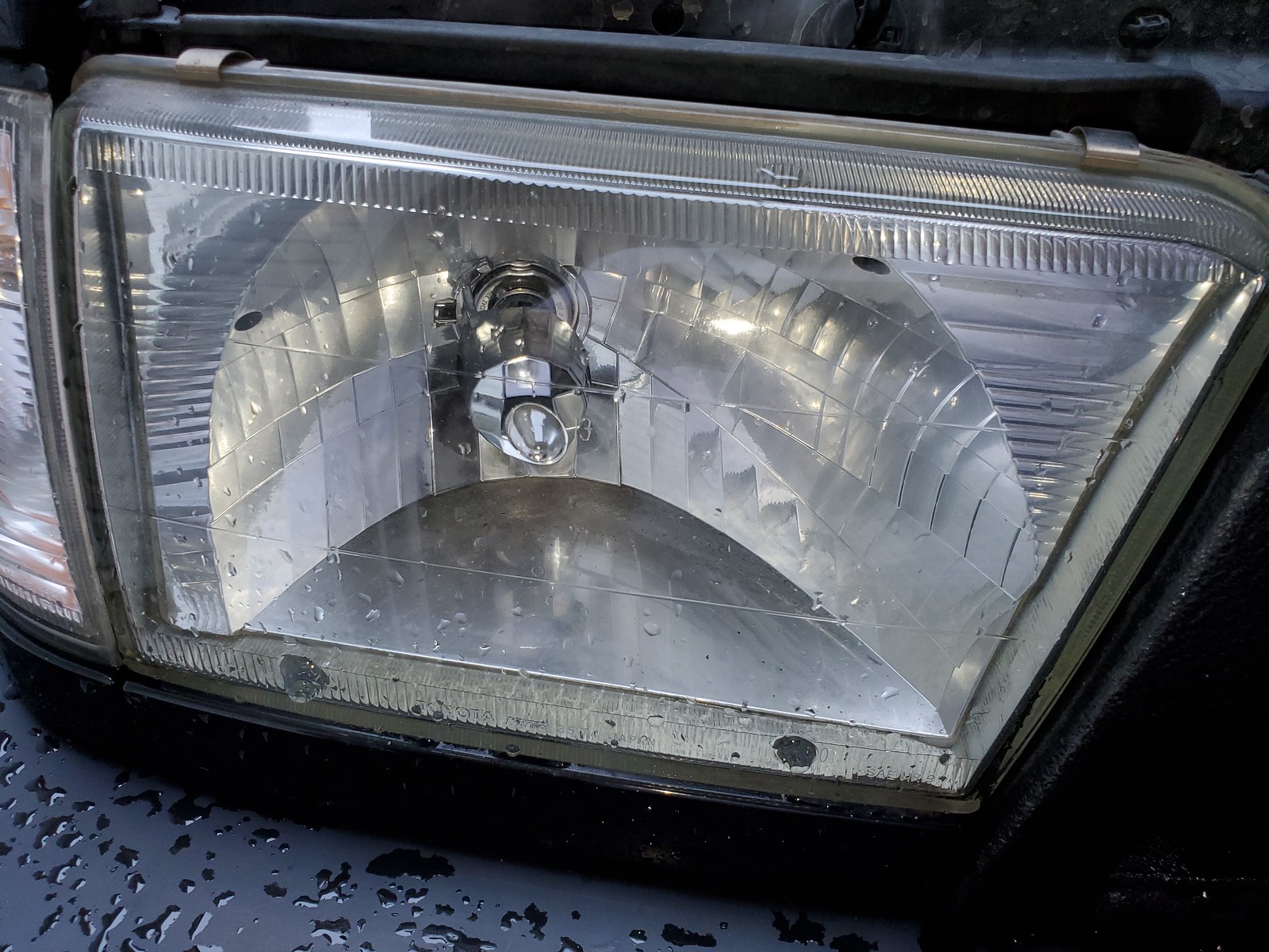

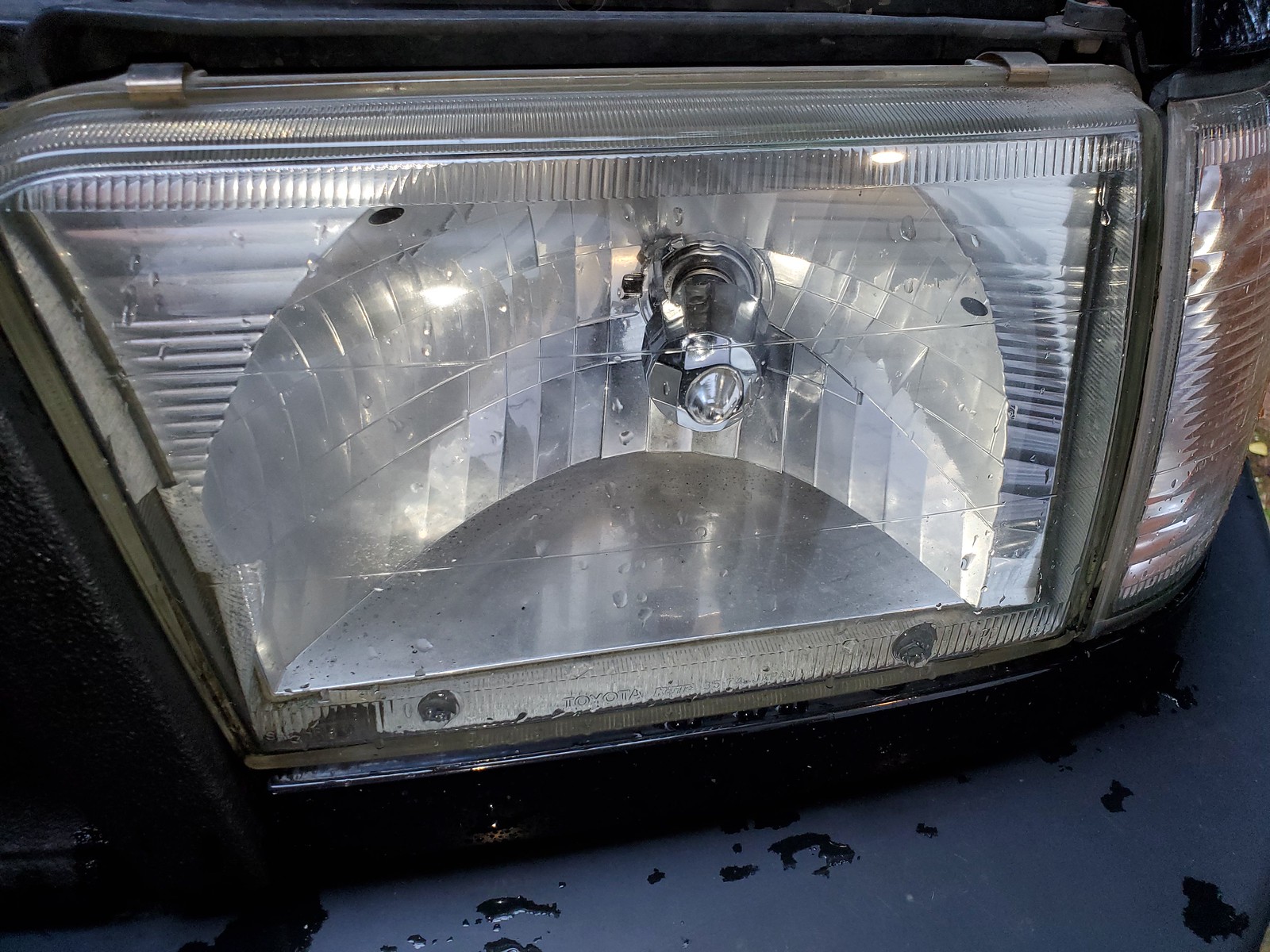

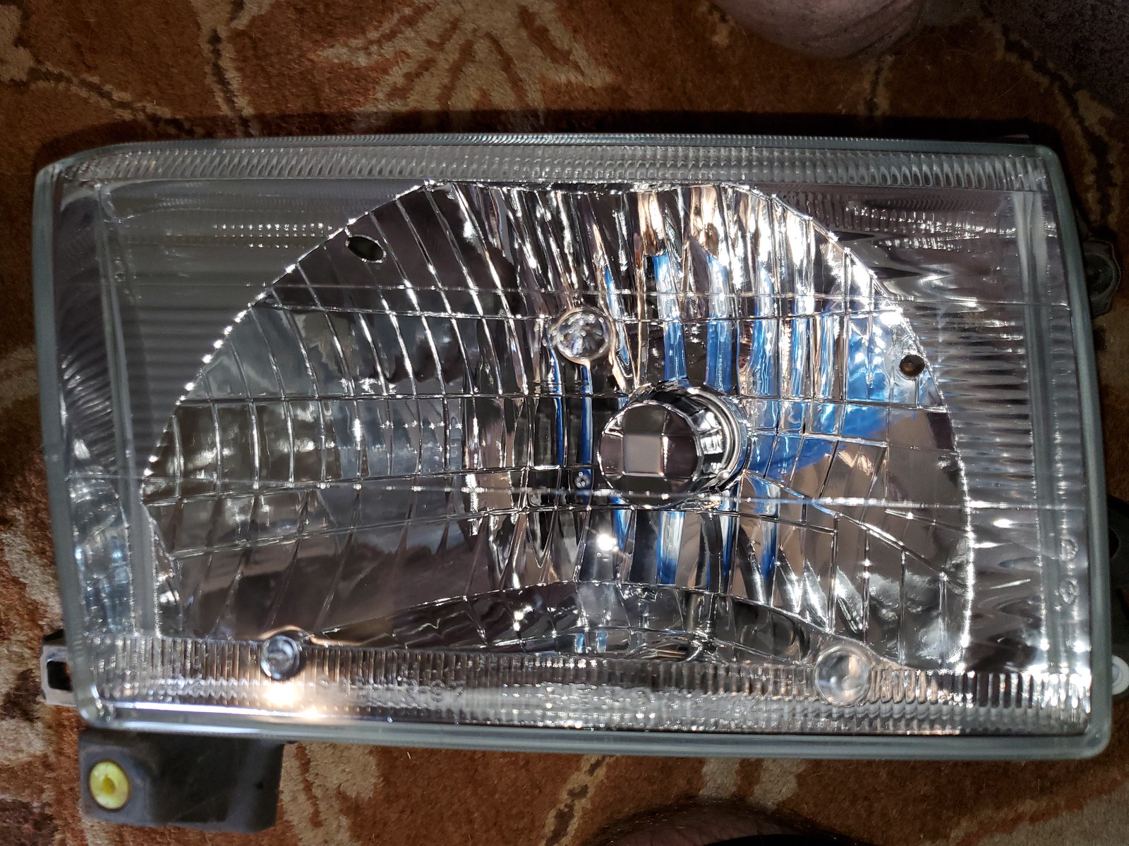

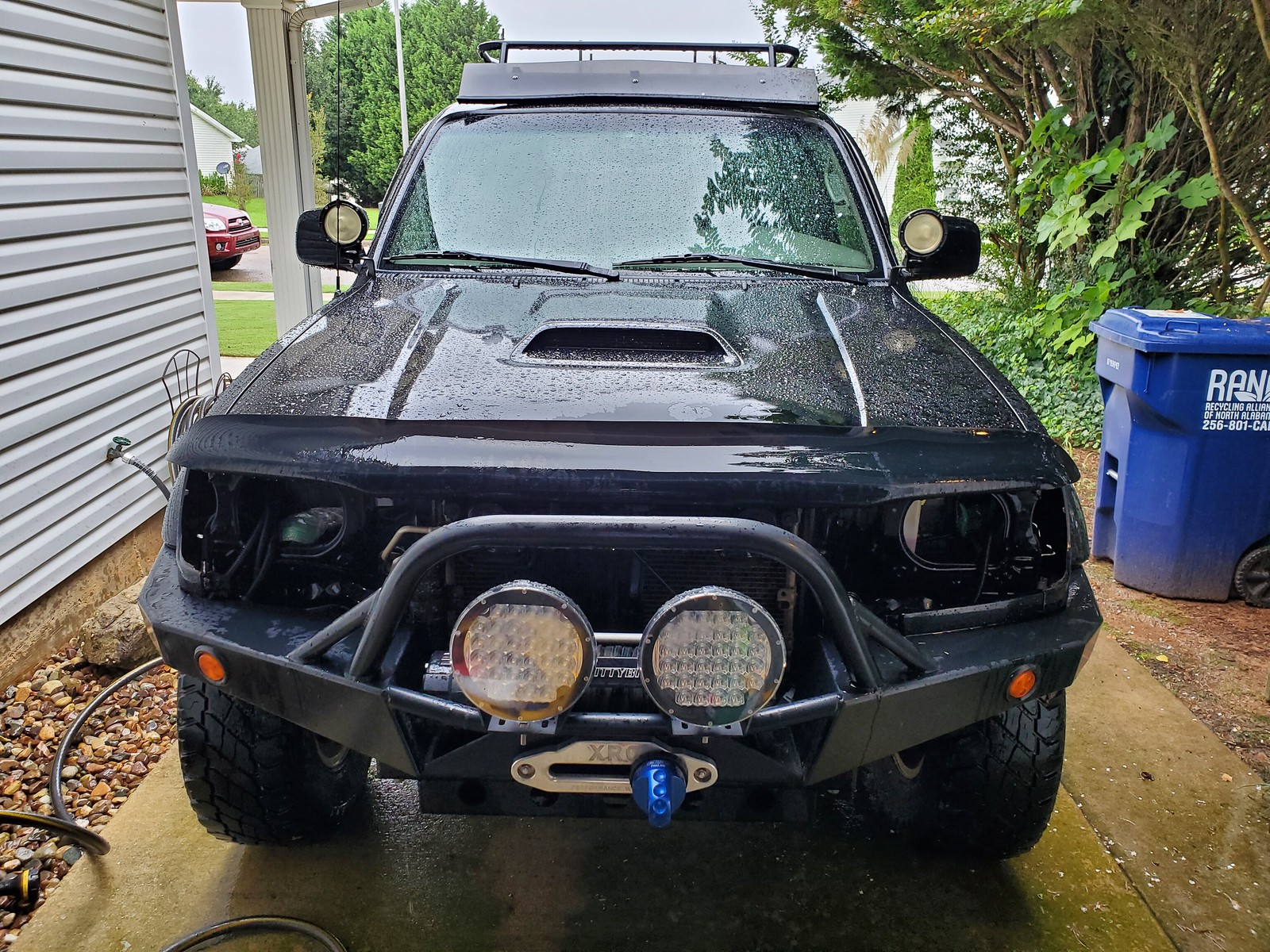

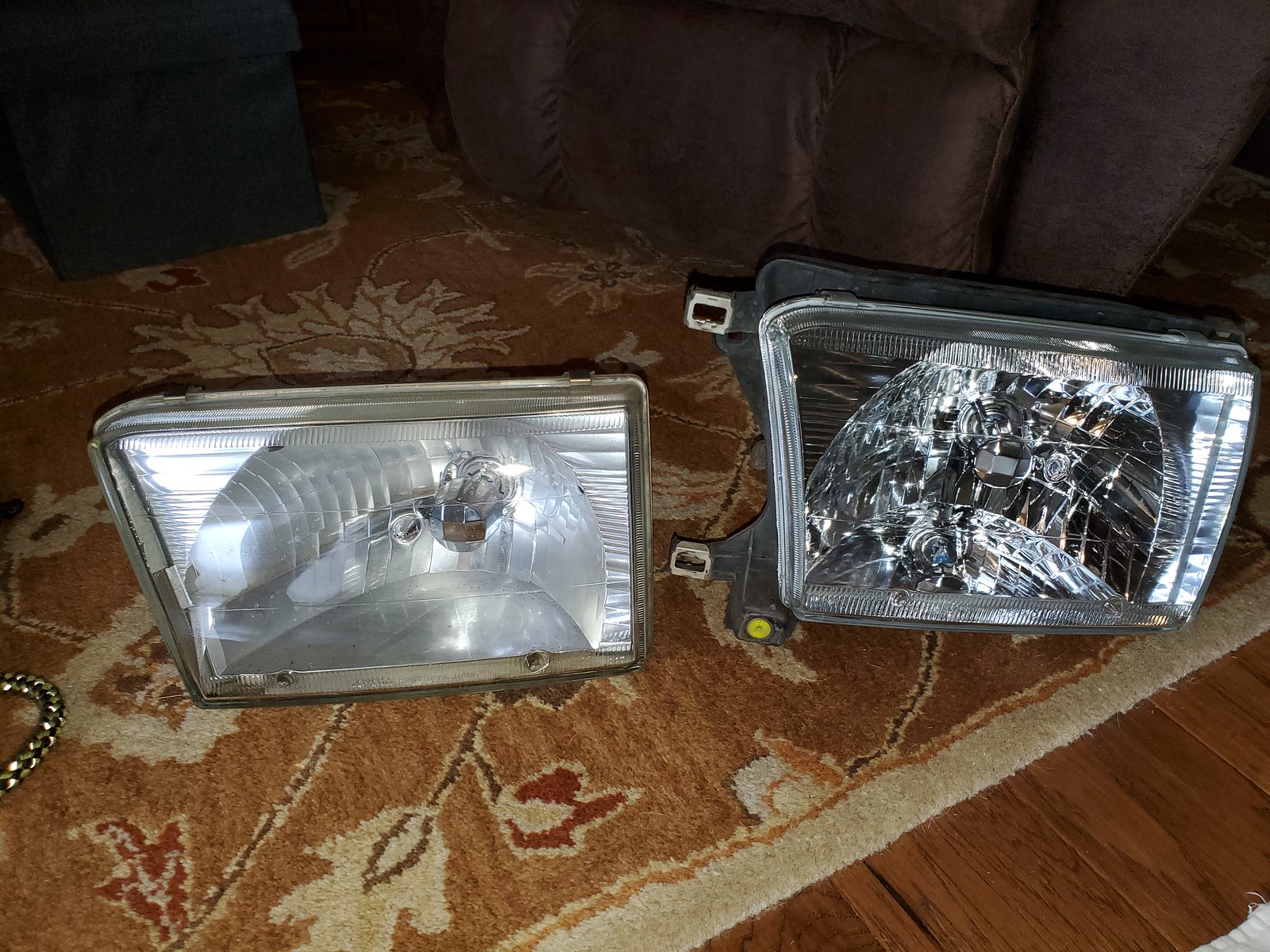

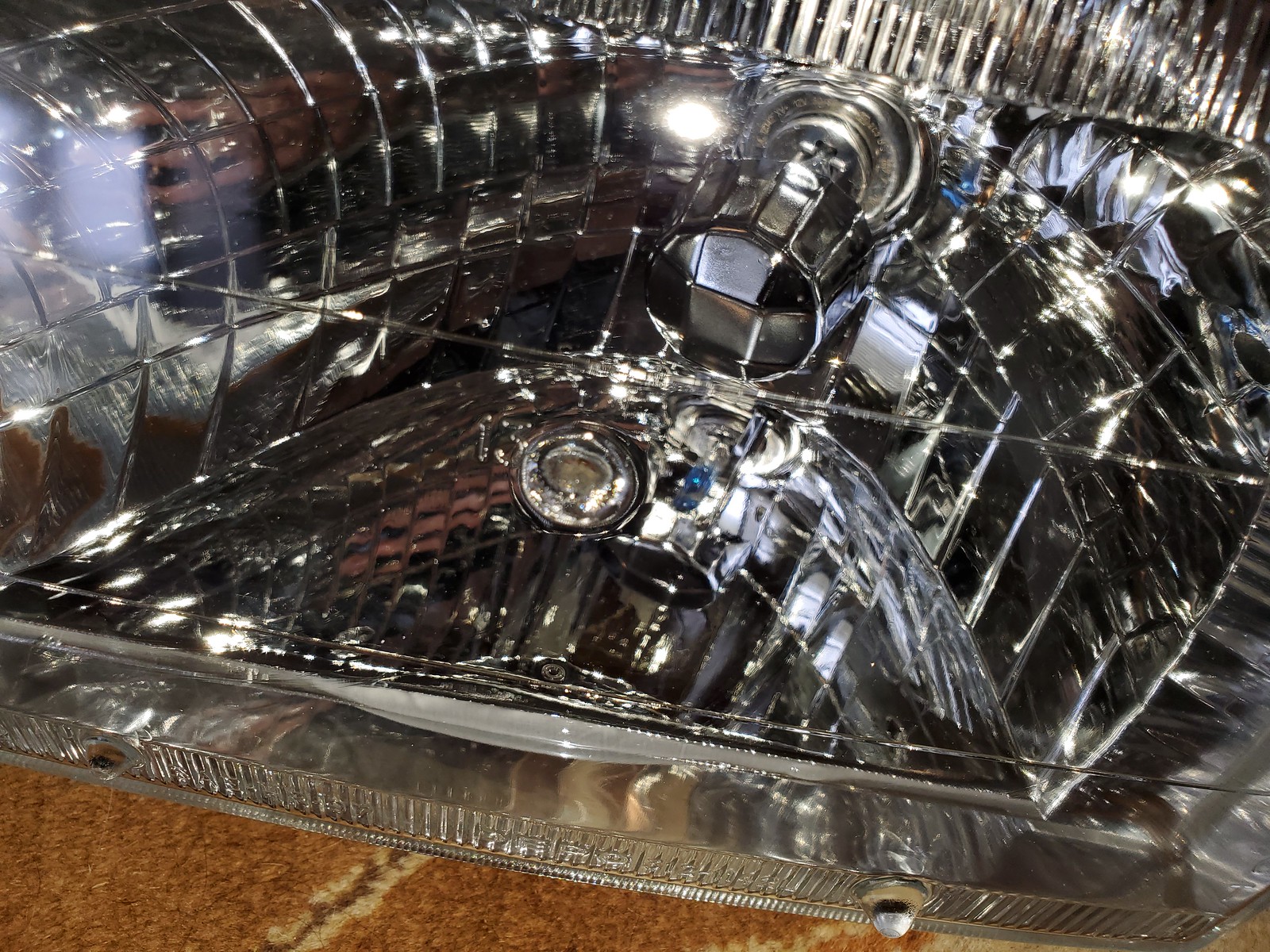

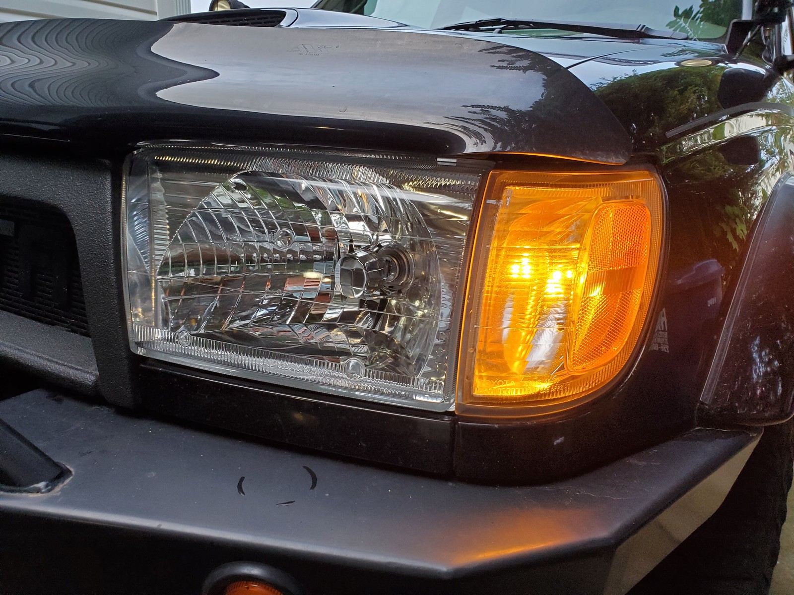

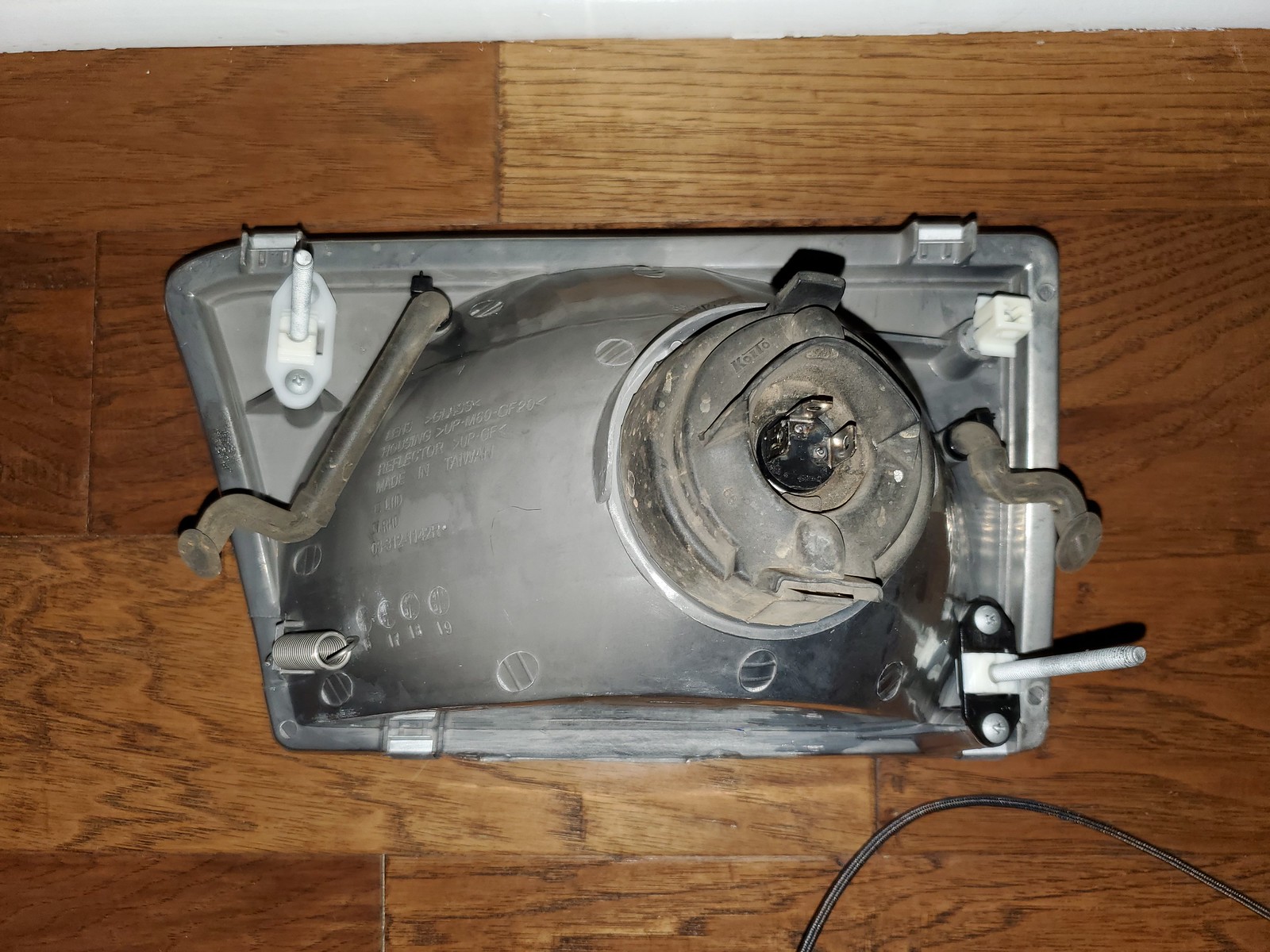

I put my new headlights in as well, and properly aimed them. I went with Depo brand aftermarket headlights. Less than $100 for the pair, versus $350+ for the OEM. The difference in how reflective the insides are is apparent when they are next to each other. Also the light output of the new headlights is incredible compared to the old ones. 280k+ miles of running the headlights took it’s toll on the reflective coating. These new ones shine so much brighter. Sure, the pattern isn’t as great as new OEM ones I am sure, but these put out much cleaner and more useable light than the old worn stock ones at a very reasonable price. I no longer dread driving the 3rd gen at night like I had after getting the 4th gen with its fancy projectors.
I did swap over the frames behind the headlight bucket so I could keep the Toyota ones on the truck. I also swapped over the drain hoses since the Toyota ones are much longer. They were a little loose feeling so I put a ziptie around them to help hold it in place.
I also put amber LEDs in the corner markers. I like how vibrant and orange they are, and when they’re on it gives a bit of an old Land Cruiser vibe. The quick LED flash when locking and unlocking the truck gives it a slightly more modern touch.
Some pics showing the old and new headlights:
20210821_101809 by Unner Unner, on Flickr
20210821_101803 by Unner Unner, on Flickr
20210821_140436 by Unner Unner, on Flickr
20210821_114842 by Unner Unner, on Flickr
20210821_115223 by Unner Unner, on Flickr
20210821_140411 by Unner Unner, on Flickr

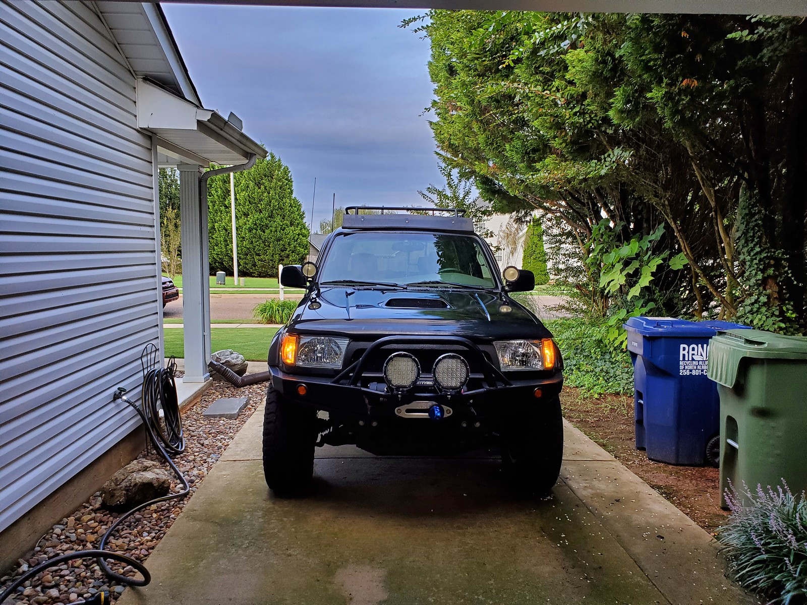

Some pics showing the new installed headlights and corner LEDS:
20210821_182902 by Unner Unner, on Flickr
20210821_140500 by Unner Unner, on Flickr
20210821_183014 by Unner Unner, on Flickr
20210821_182928 by Unner Unner, on Flickr
20210821_183026 by Unner Unner, on Flickr

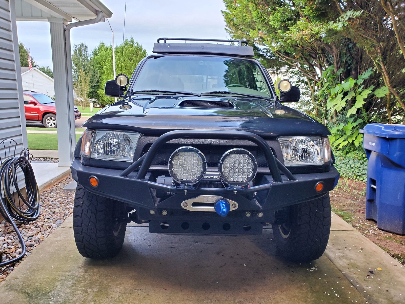

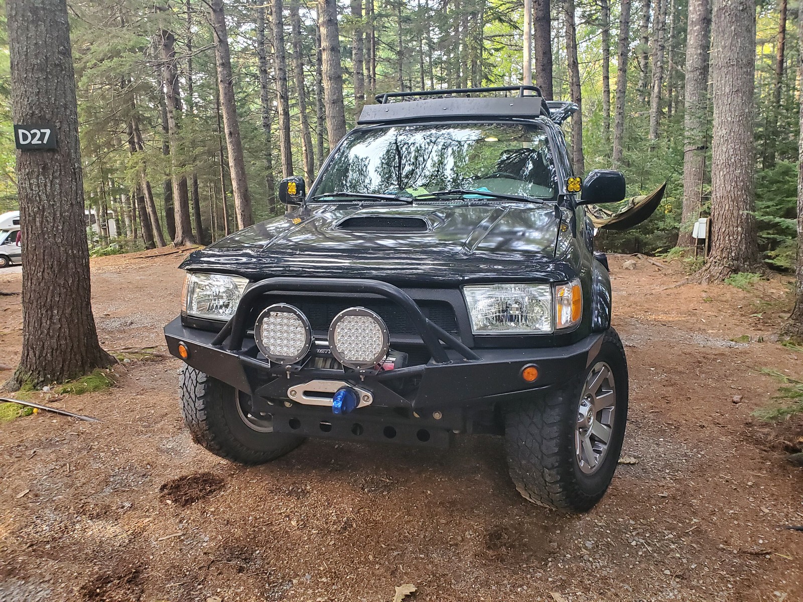

Some pics showing all the new front facing lights (new headlights, Primelux LEDs, and Baja Designs):

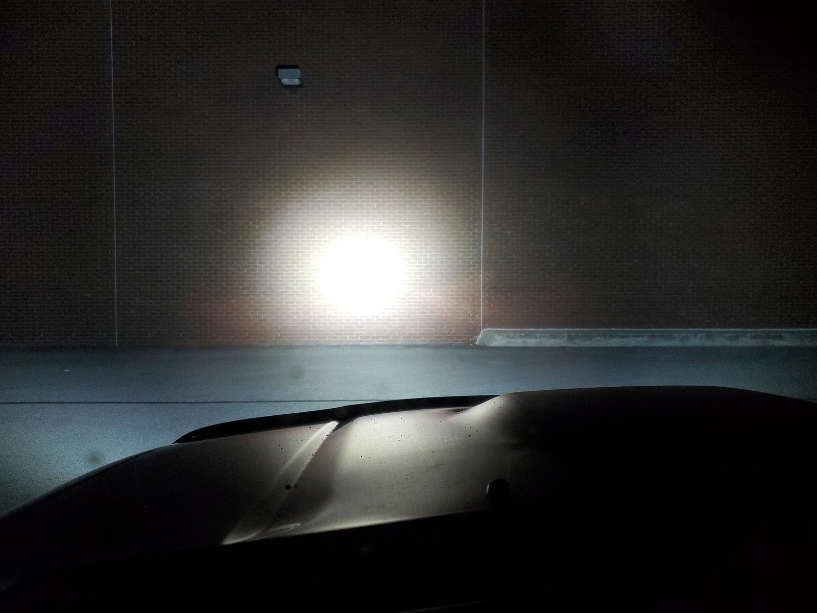

Realized I never took any pictures since I installed the Baja Designs lights the other night. Pictures to come tomorrow in the daylight.

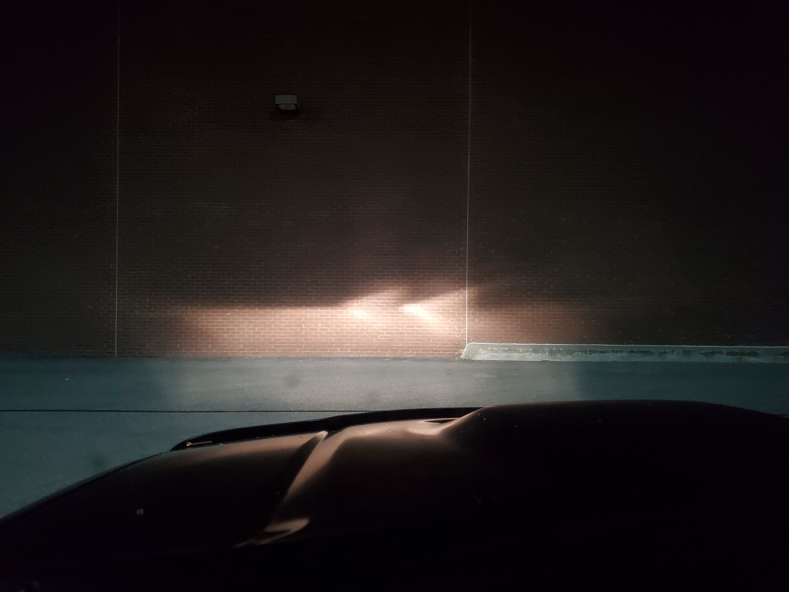

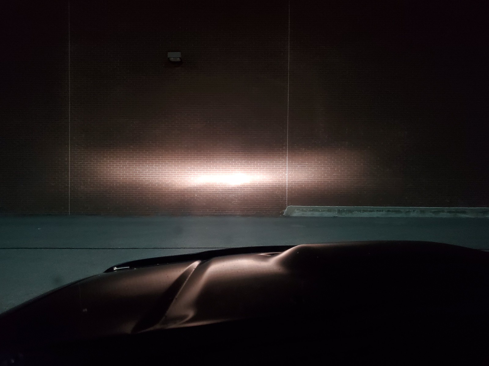

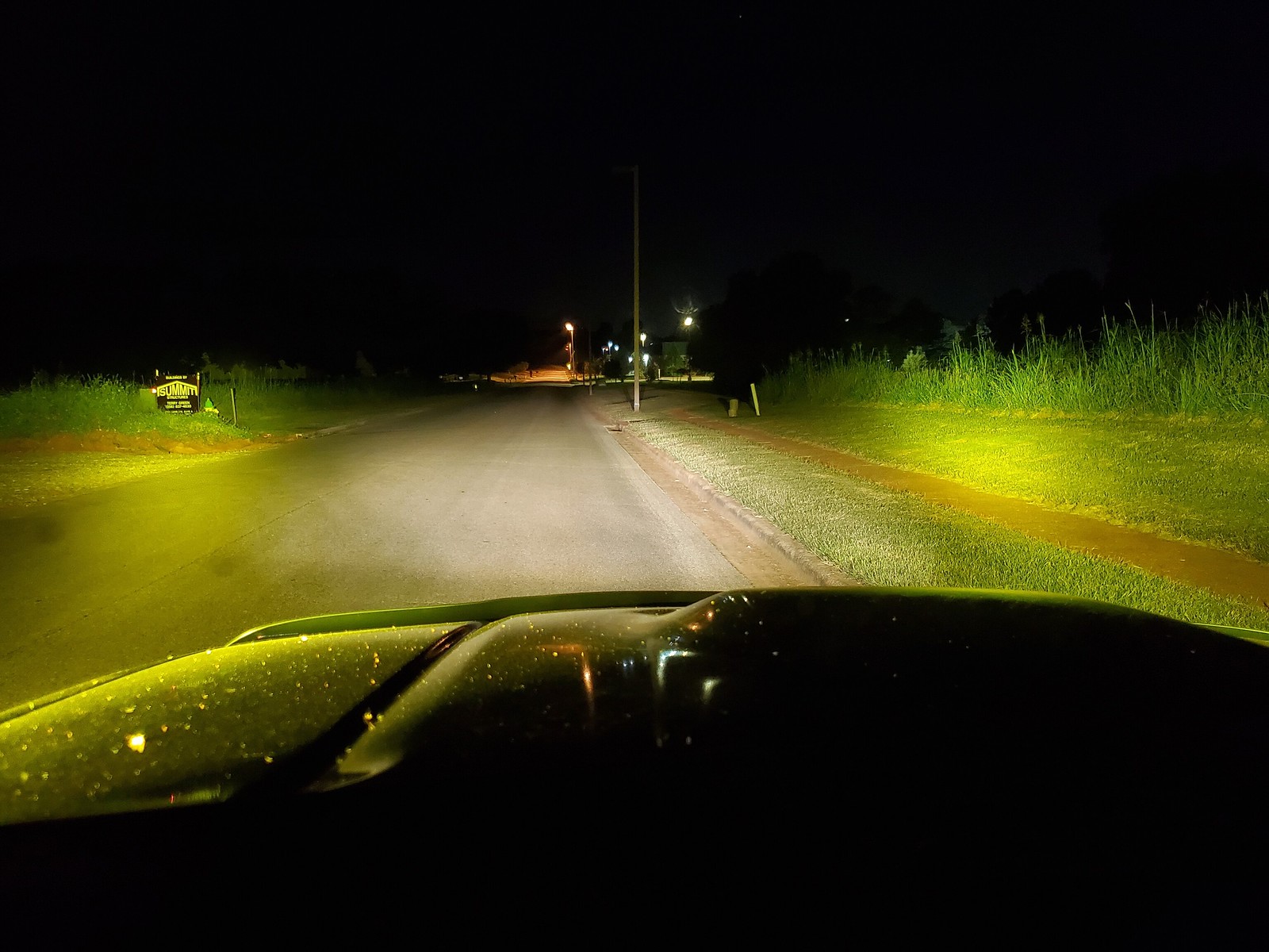

Some pics showing the light output:
Low Beam:
20210826_224815 by Unner Unner, on Flickr
High Beam:
20210826_224818 by Unner Unner, on Flickr
Primelux + Low Beam:
20210826_224833 by Unner Unner, on Flickr
Low Beam + Baja Designs:
20210826_224826 by Unner Unner, on Flickr
20210826_220458 by Unner Unner, on Flickr
High Beam + Baja Designs
20210826_224843 by Unner Unner, on Flickr

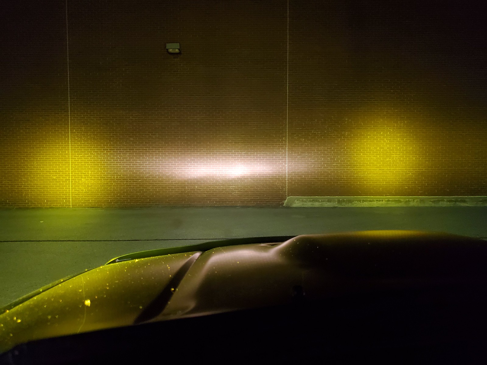

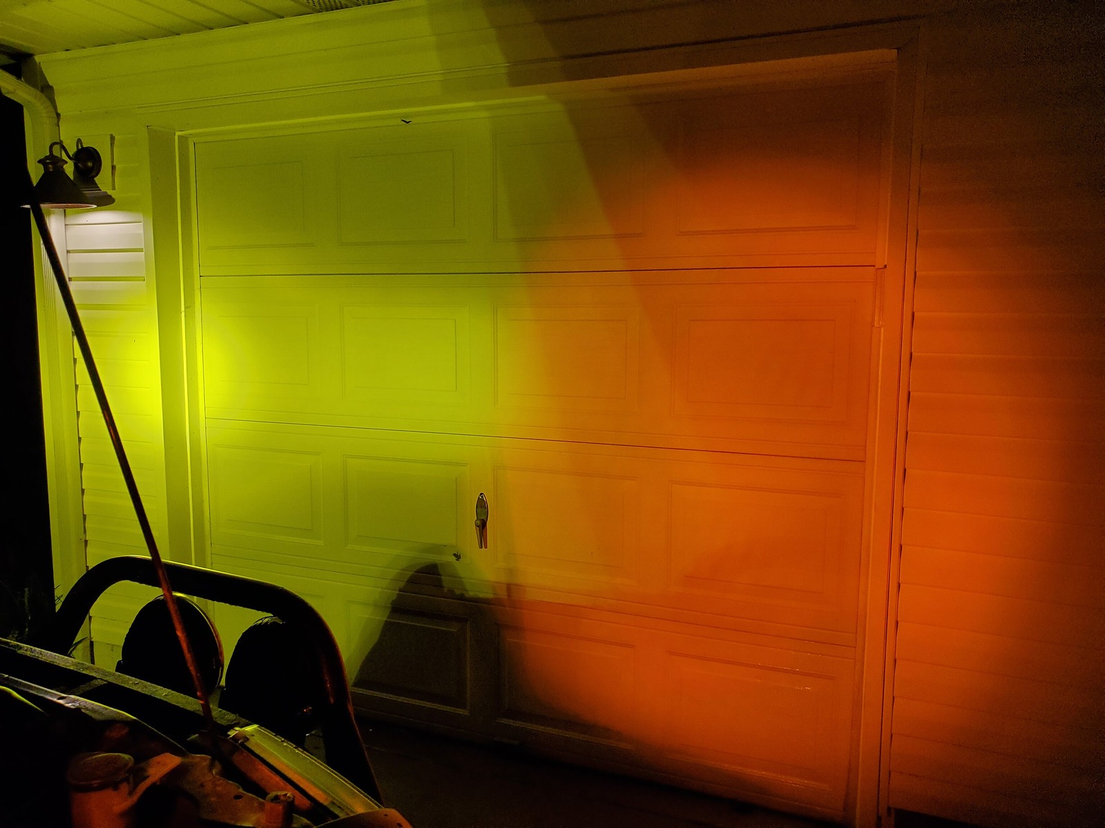

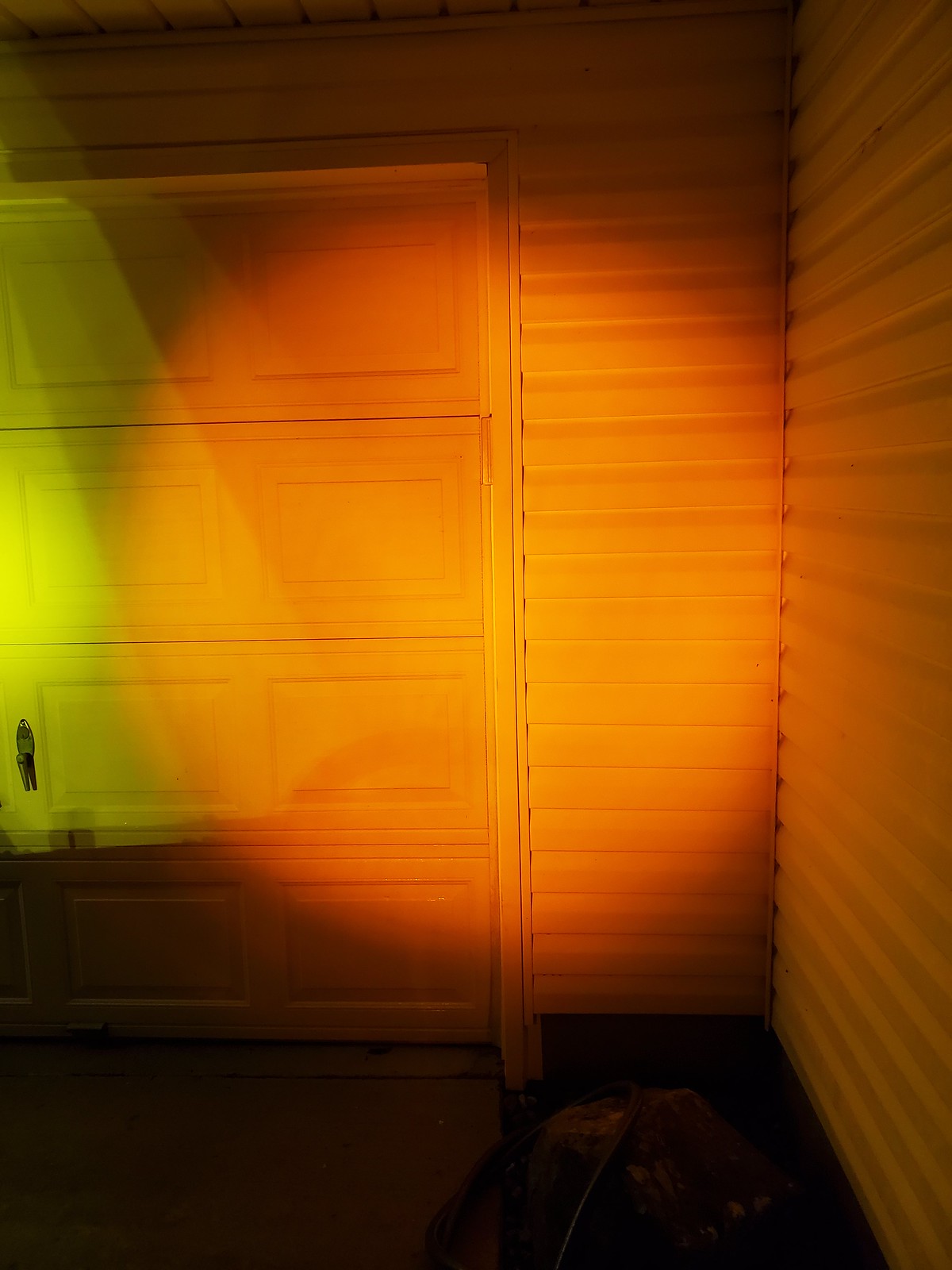

Also, for those interested, here’s a comparison of the color temperature of the Baja Designs Amber lights, versus the Rigid Amber lights. You can see how much more orange the Rigid’s are. This made the Rigid’s about useless for seeing anything at night. Even in intense fog/rain they weren’t much help. I am sold on Baja Designs after installing these. The color is much better for me, and they are much brighter/throw light farther. If only the Baja Designs LP9 wasn’t so expensive I’d have put those on the front bumper.
20210822_001023 by Unner Unner, on Flickr
20210822_001019 by Unner Unner, on Flickr
20210821_235828 by Unner Unner, on Flickr

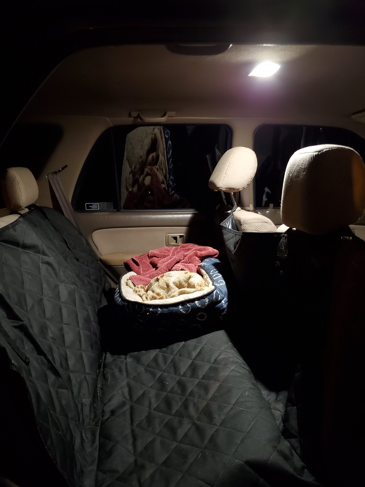

The interior got new LED lights in all the dome, cargo, and map lights. The dome and cargo area lights have given up long ago. The cheap ebay LED panels stopped working, and always had a bit of a blue tint which I wasn’t a fan of. I bought some regular bayonet style LEDs off Superbrighteds.com and they are a much nicer color temperature, and they can’t rattle around like those LED panels (I figured out that cargo one was the source of one of my rattles in the truck).
They are a tight fit so I recommend removing the light from the roof and installing the LEDs inside the house or something. Otherwise you may end up shooting the light up into the roof body and having to pull trim pieces to fish it out with a magnet. Ask me how I know…
The front map lights had continued to work, but were bluer than I’d like. So I got some warmer color LEDs for up there as well. All around this makes the truck much nicer to drive at night. I had forgotten that the dome light turns on when you unlock the truck. Nice to have that feature back.
20210821_200026 by Unner Unner, on Flickr
20210821_200512 by Unner Unner, on Flickr

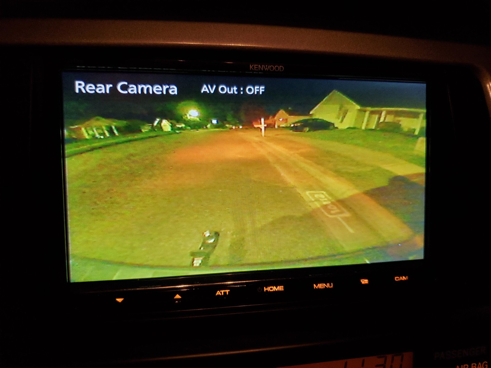

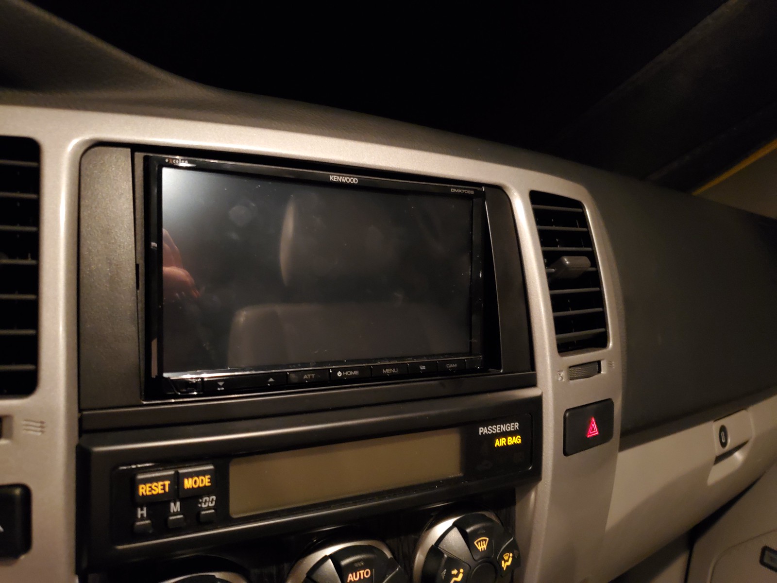

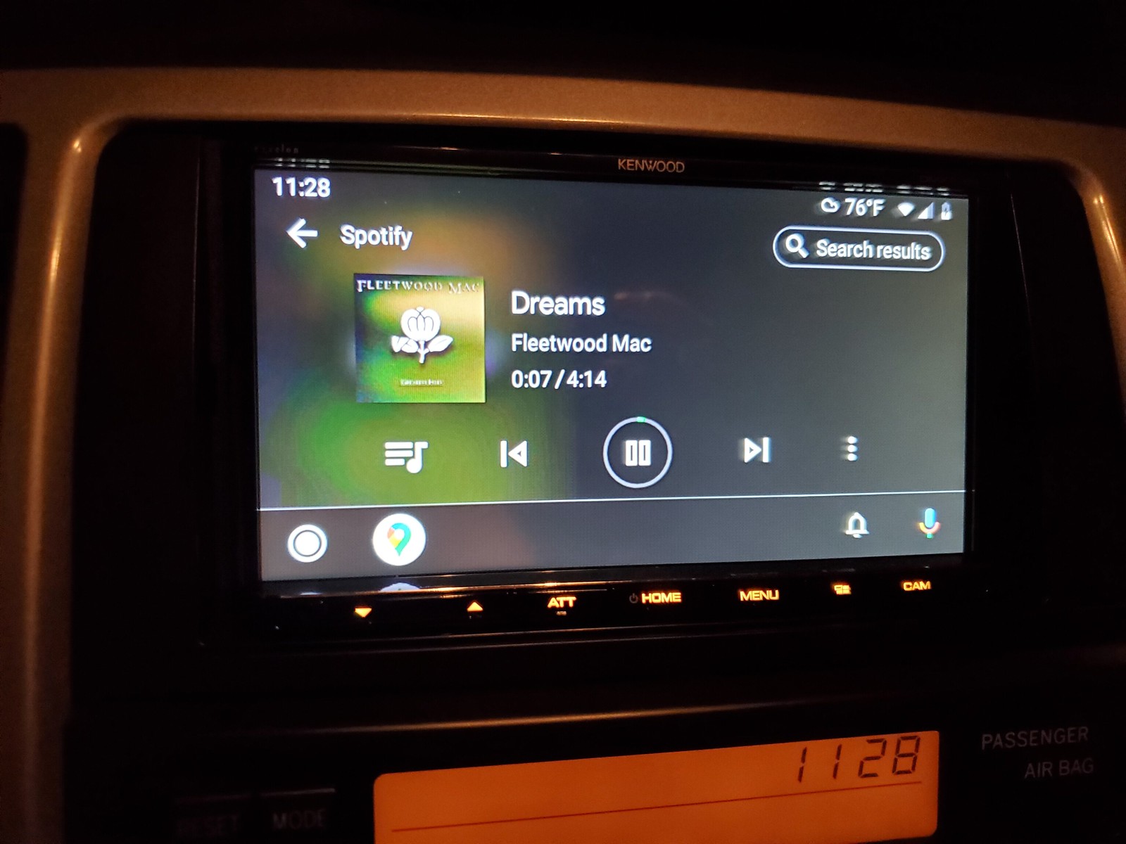

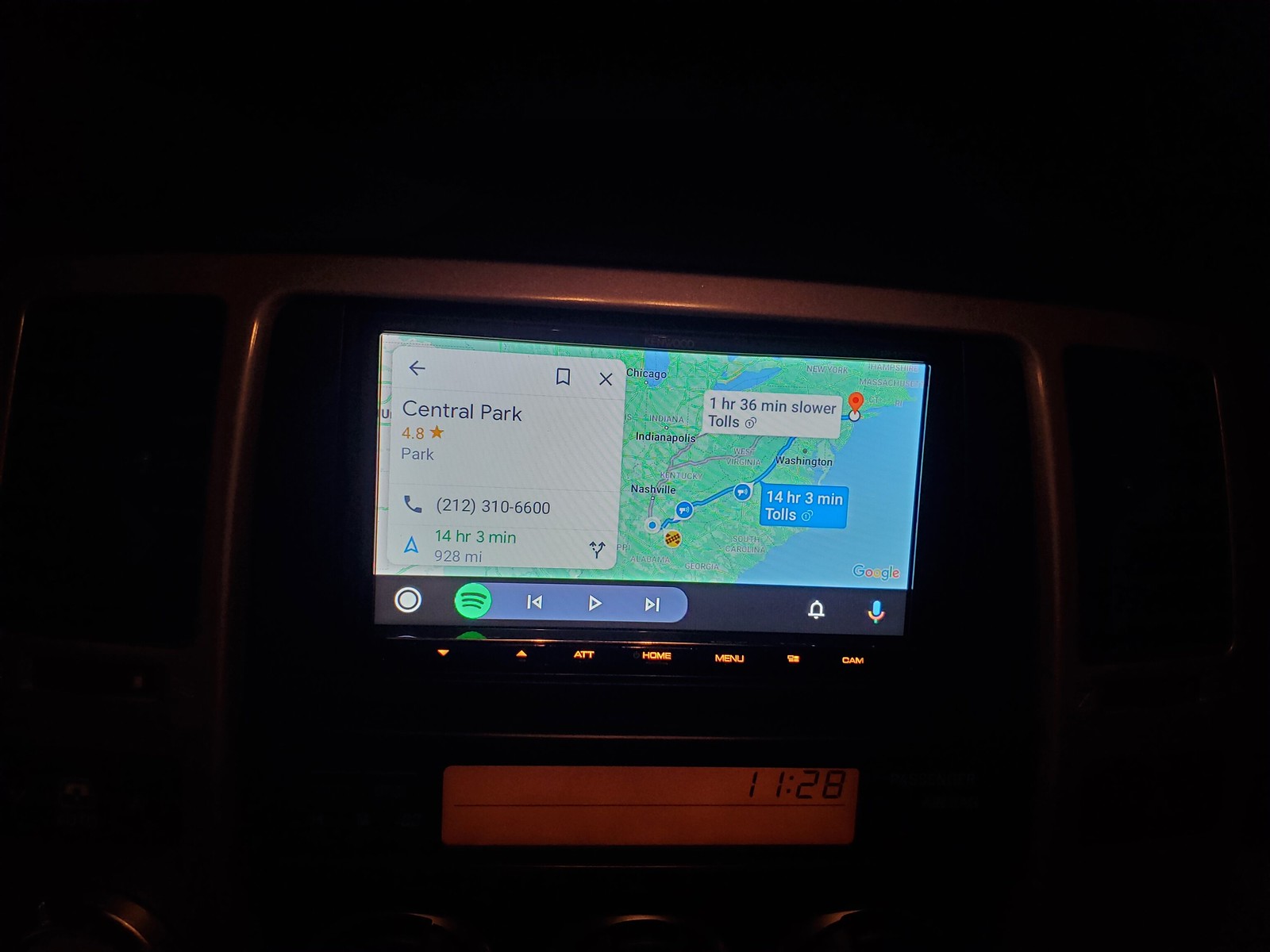

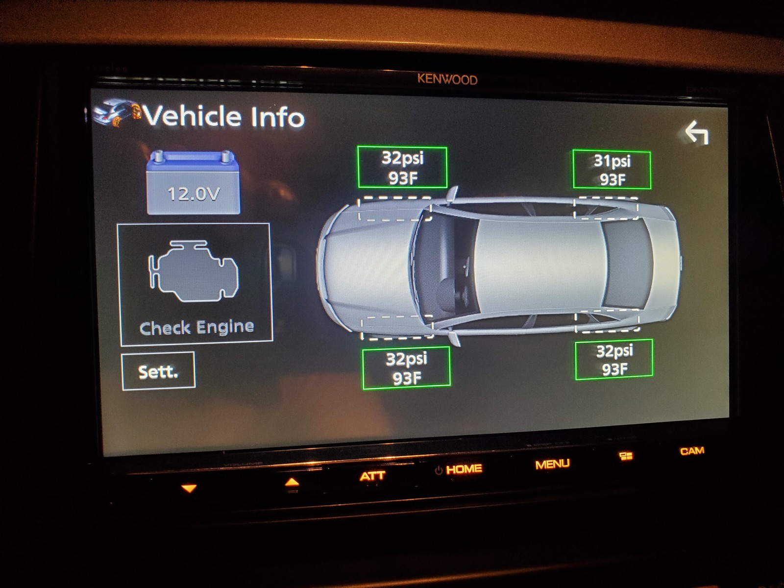

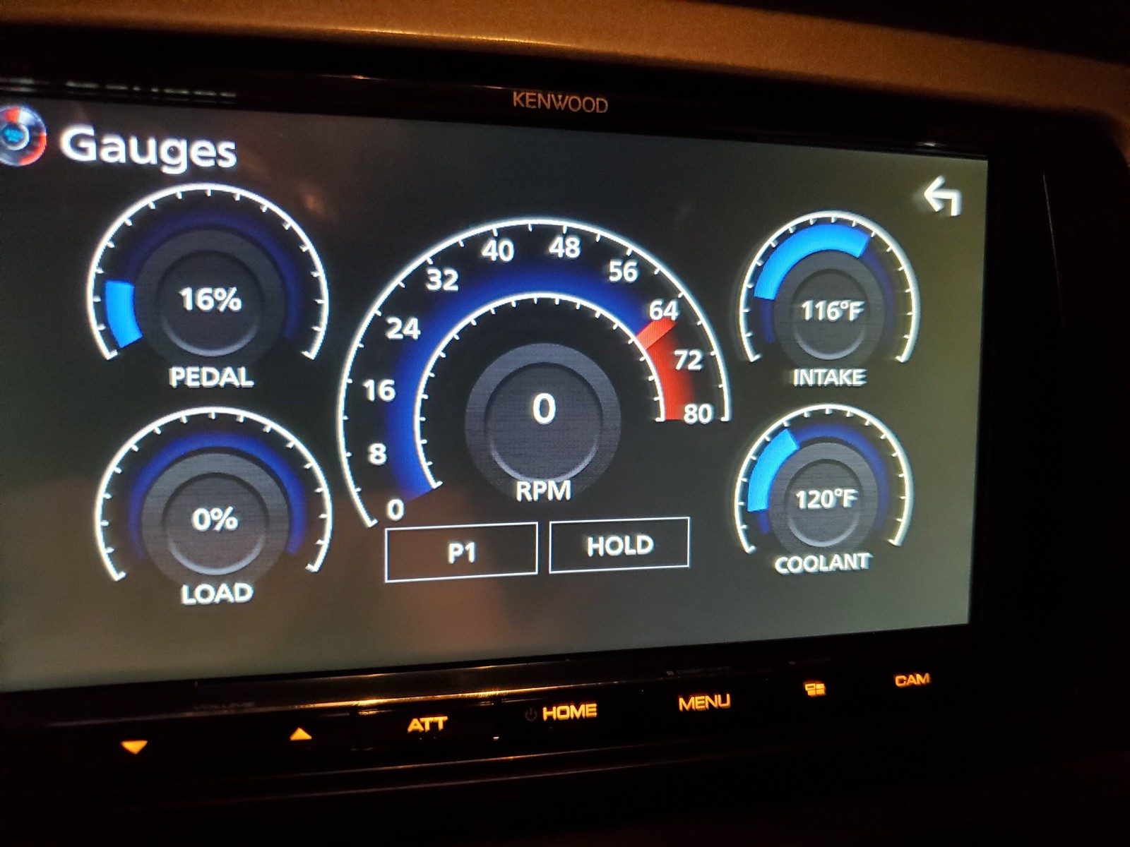

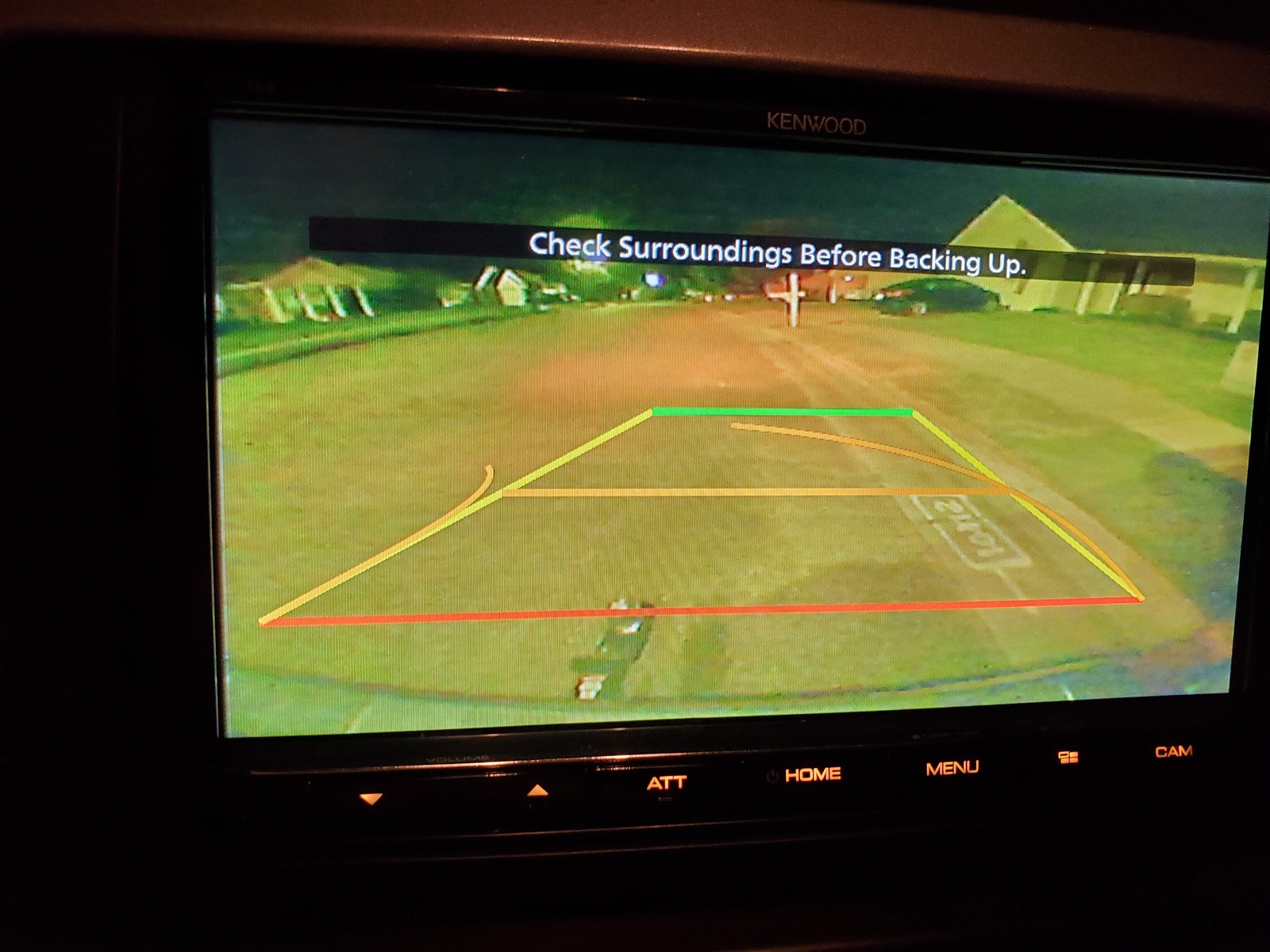

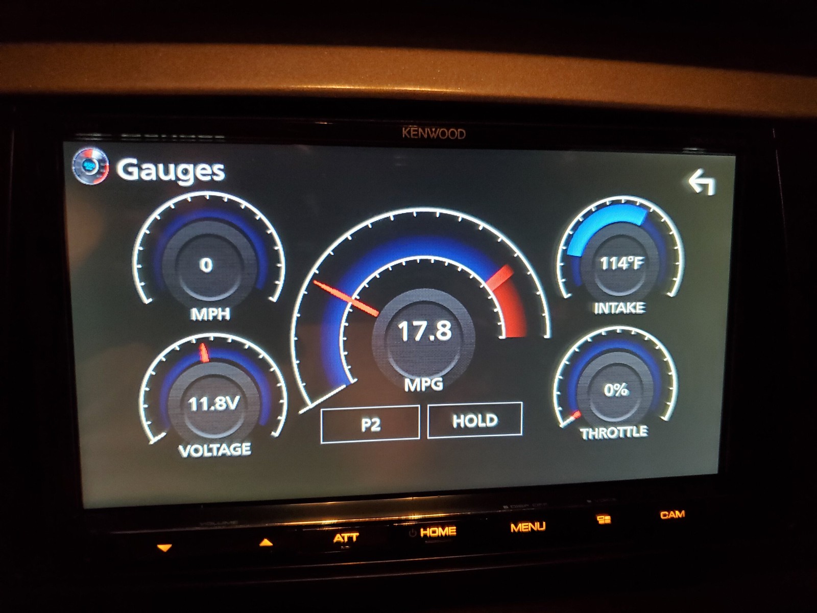

With the chip shortage I had been waiting patiently for the headunit I wanted in the 4th gen to come back in stock. I wanted the Kenwood Excelon DMX706S for the Android Auto functionality, Bluetooth, backup camera, and idatalink Maestro that is compatible with newer cars OBD2 system.
It finally came back in stock for a couple days at Crutchfield so I pulled the trigger. It showed up and I wasted no time getting it installed. The wiring was easy, once you realize you don’t need half the cables it ships with. The instructions from idatalink are a bit lacking.
Hooking it up is easy too, the worst part is running the backup camera harness through the hatch…
But in the end you are left with a headunit that has Android Auto functionality for nav, voice/speech recognition, hands free calling/texting, backup camera, and it will display your tire pressure and temperature, and a set of various gauges.
The only thing it doesn’t display that I wish it did is transmission temperature. I’m sure it can do it, but per idatalink it can’t. It should be nothing more than another PID that needs to be loaded. I will try to reach out to them and see if we can get that added for the 4th gen. The later 5th gens have it I believe. My scangauge in the 3rd gen displays transmission temp…
20210829_233115 by Unner Unner, on Flickr
20210829_232943 by Unner Unner, on Flickr
20210829_232934 by Unner Unner, on Flickr
20210829_232904 by Unner Unner, on Flickr
20210829_232847 by Unner Unner, on Flickr
20210829_232818 by Unner Unner, on Flickr

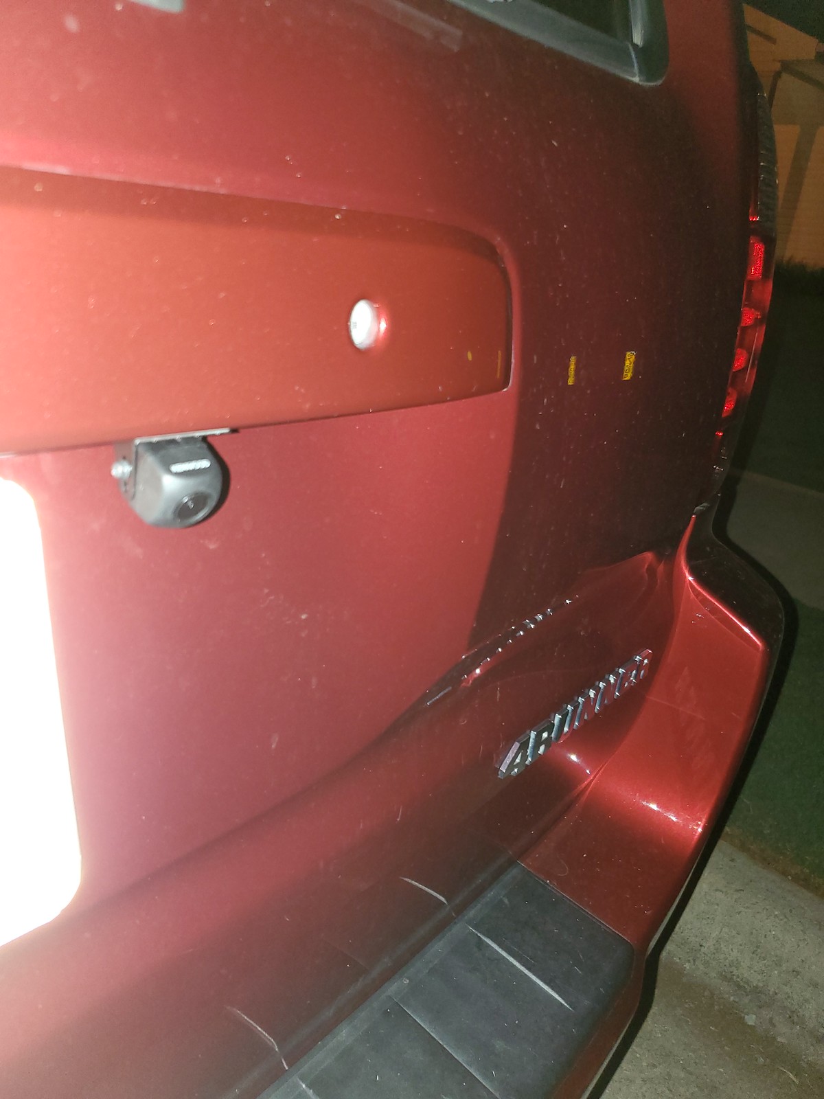

I wired up the backup camera so I can access it at any point. That will allow me to check on loads in the trailer. Or see how close that person following me really is ��
20210829_233029 by Unner Unner, on Flickr
20210829_233153 by Unner Unner, on Flickr
It will also give dynamic backup camera guidelines that turn with the wheel. Not really needed, but it’s a neat feature.
20210829_233041 by Unner Unner, on Flickr

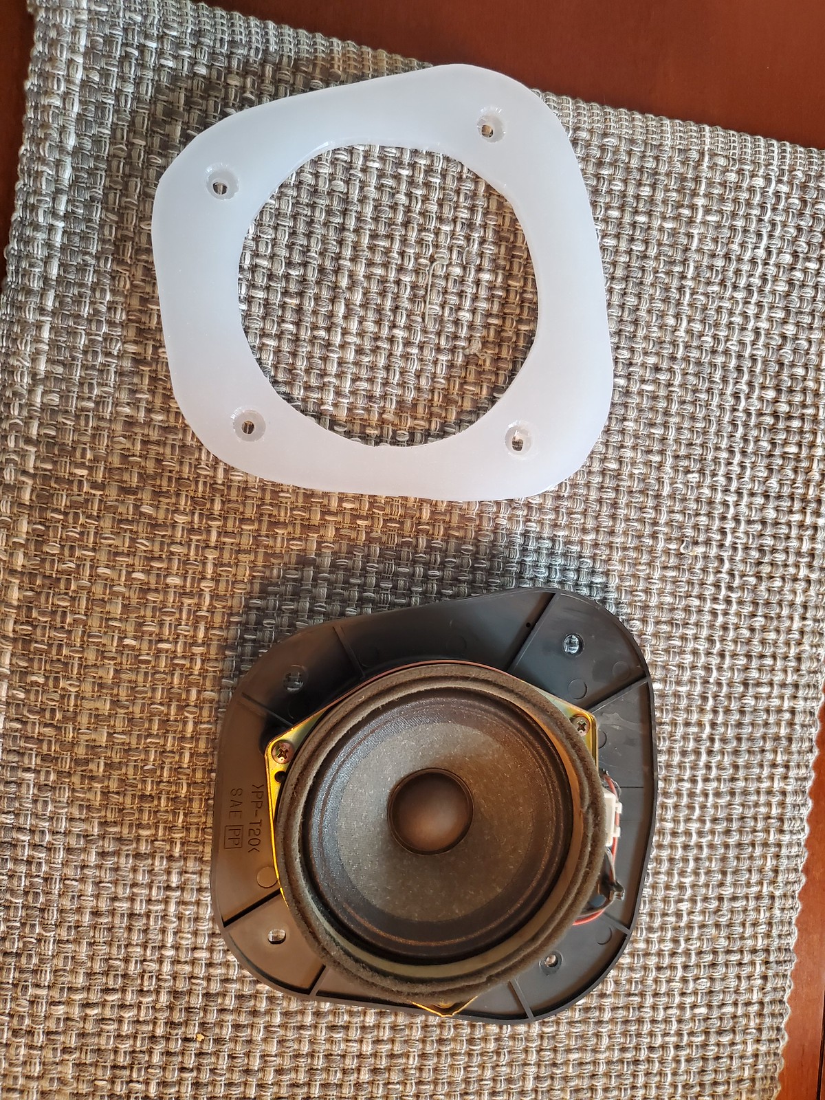

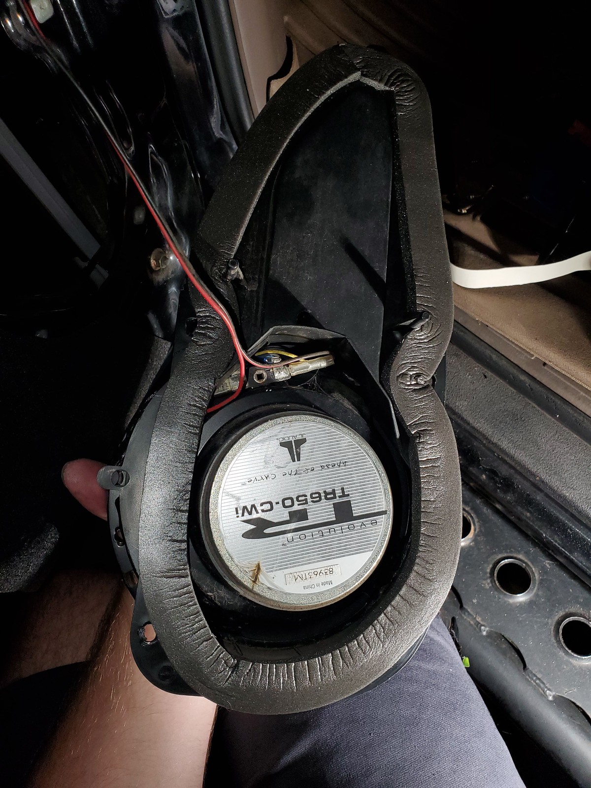

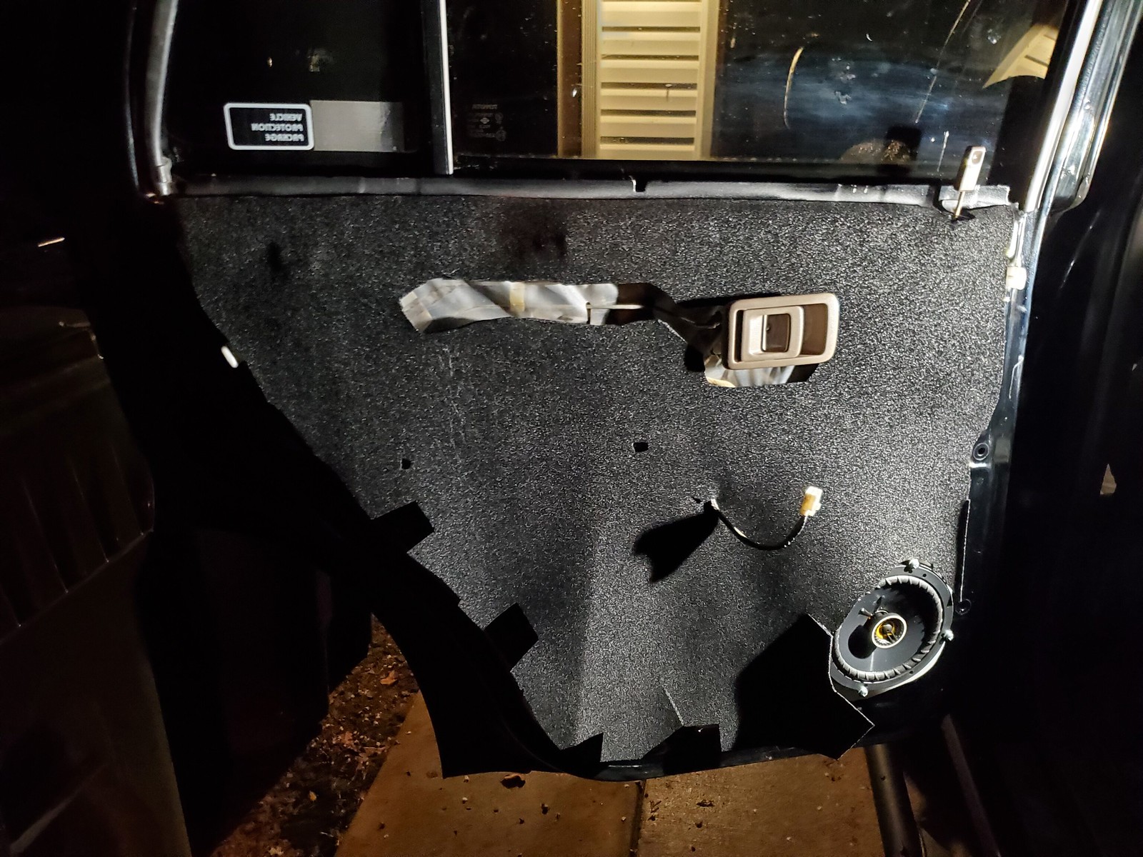

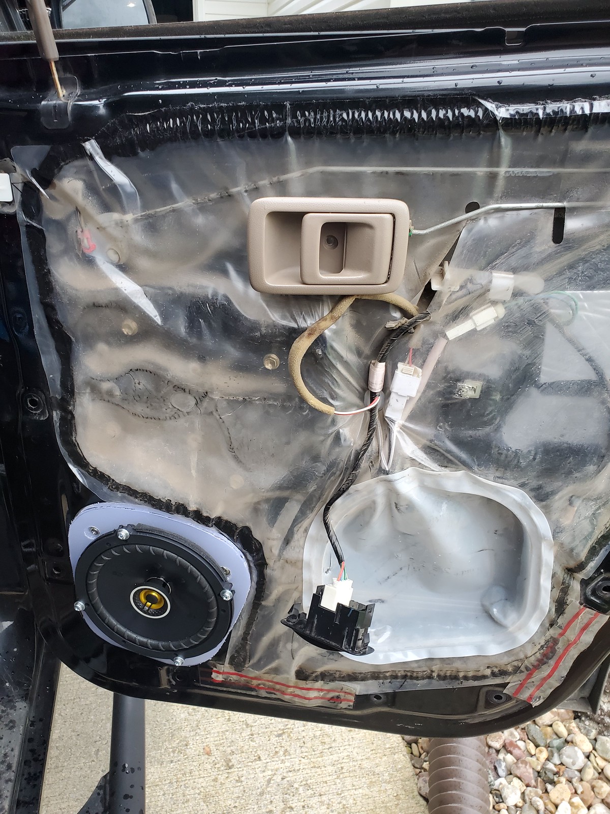

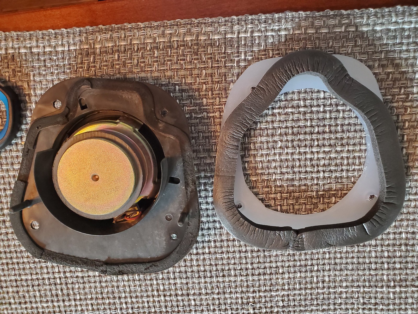

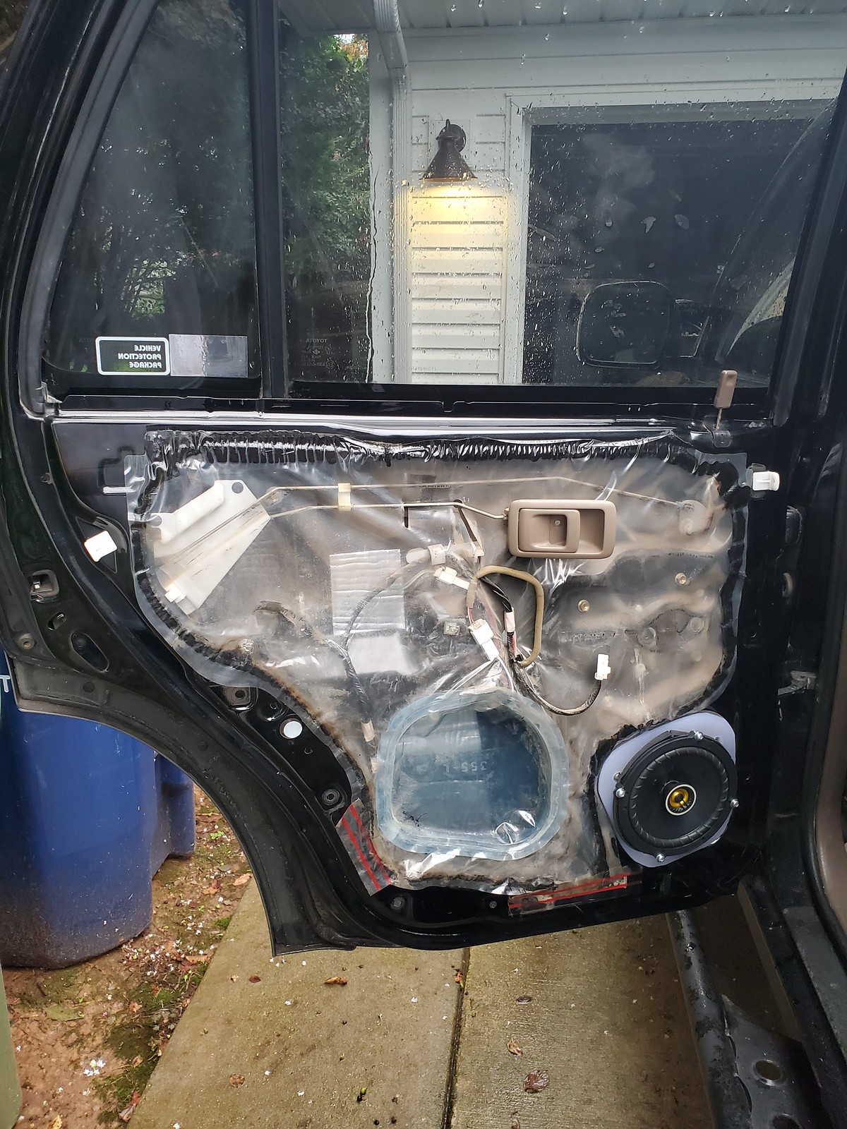

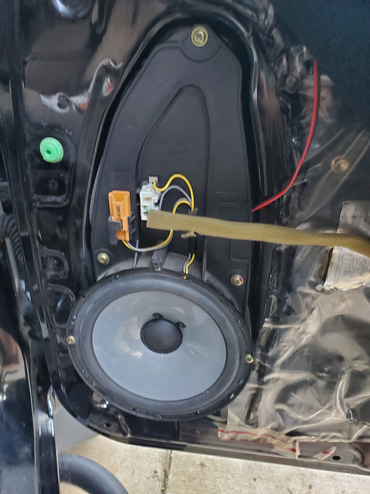

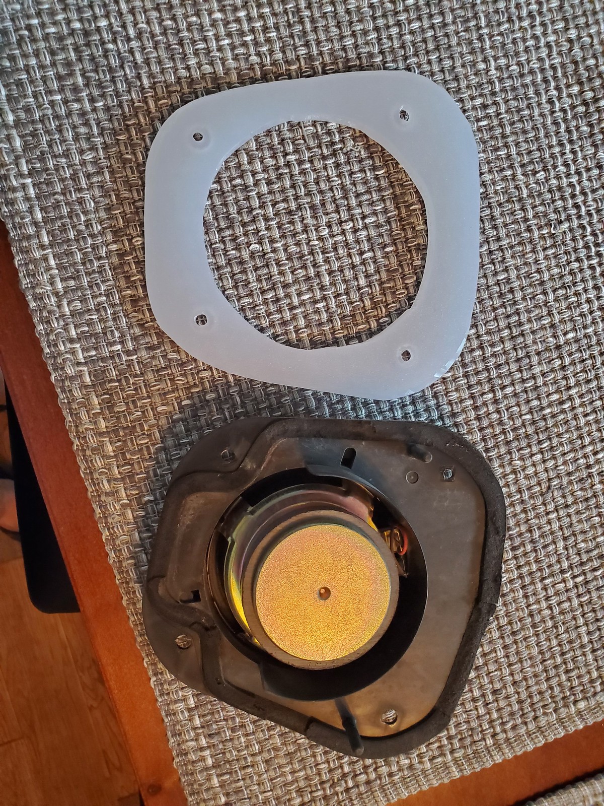

I got the 6.5" rear speakers installed. Basically I traced the stock speaker mounts onto a piece of cardboard. Cut it out and trimmed it to fit against the door. For the center hole for the speaker I just drew a circle in the diameter prescribed for my speakers.
Once I was happy with the cardboard template I traced it onto a plastic cutting board I got at walmart. Probably about 3/8" thick. I cut the board with a jig saw, and trimmed a few areas with a sharp razor blade. Now it was time to drill the mounting holes. I did so one by one, the board is translucent so you can see the mounting holes through the board. Mark with a sharpie, drill the hole, and then counter bore around the hole so the screw sits down in the mount. The last couple screws I had to slot slightly to make sure all the screws would go in smoothly.
20210831_174241 by Unner Unner, on Flickr
20210831_174234 by Unner Unner, on Flickr
Now, wrap the backside of the mount with foam weatherstripping and mount it to the door.
20210831_174453 by Unner Unner, on Flickr
Then I ran another thinner strip of weather stripping around the edge of the speaker hole and held the speaker up. I marked the first hole, drilled and "mounted" the speaker with that. From there I just carefully drilled remaining holes and mounted the speaker for good. Pretty easy.
20210831_185207 by Unner Unner, on Flickr
20210830_171224 by Unner Unner, on Flickr
I also picked up a pair of harness adapters so I wouldn't have to cut my stock wiring. Made it nice and easy to hook them up. Make sure you run the speaker wires so they don't get caught in the window at any point.
These speakers clear the window, so it still goes all the way down. No trimming of the door panel required either.

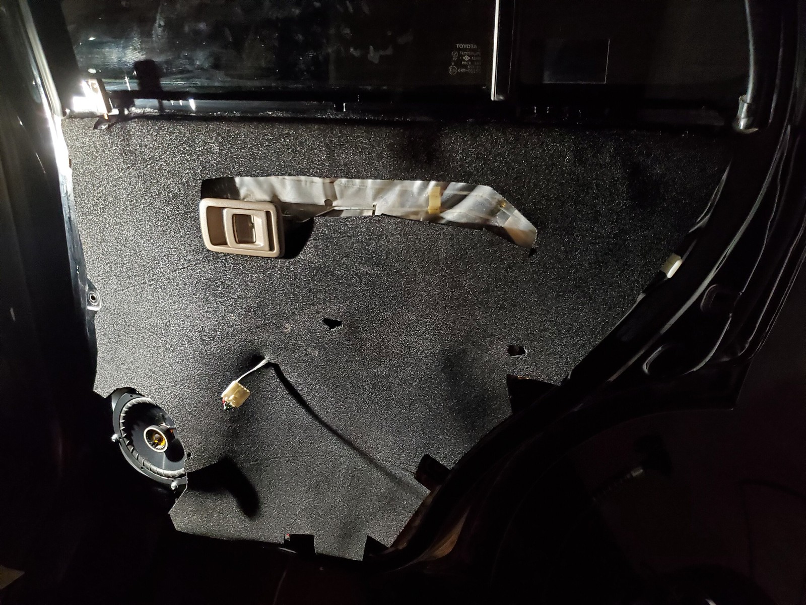

I also put the same peel and seal sound deadening in the doors, a square of closed cell foam behind the speaker mounted to the door skin, and then a sheet of closed cell foam between the door and door panel.
20210831_200240 by Unner Unner, on Flickr
20210831_203502 by Unner Unner, on Flickr
Overall they sound pretty good. It makes a lot more bass now, and can be turned up higher. The stock rear speakers would distort before my JL Audio fronts. It doesn't sound as crisp and clean as the 4th gen's JBL system, but it sounds pretty good for what it is. I'm happy.

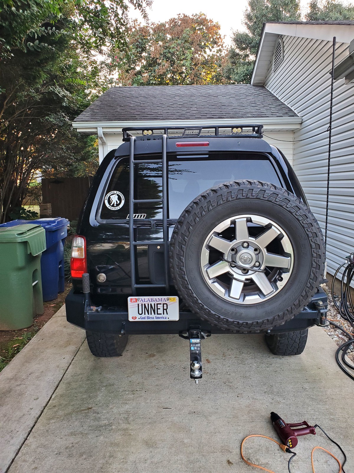

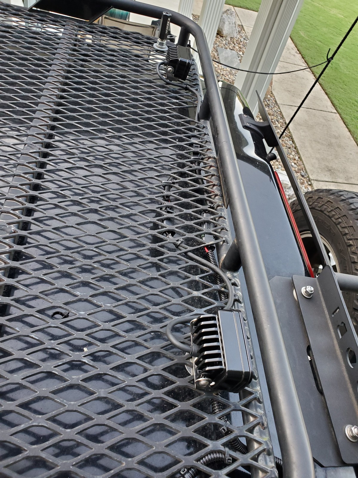

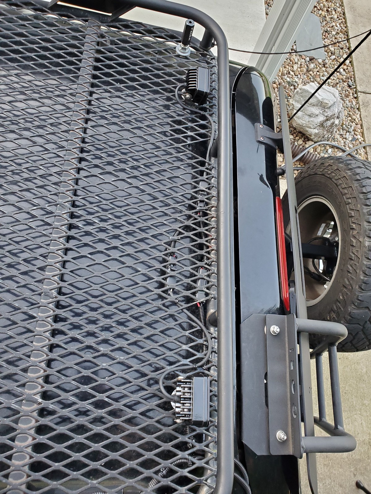

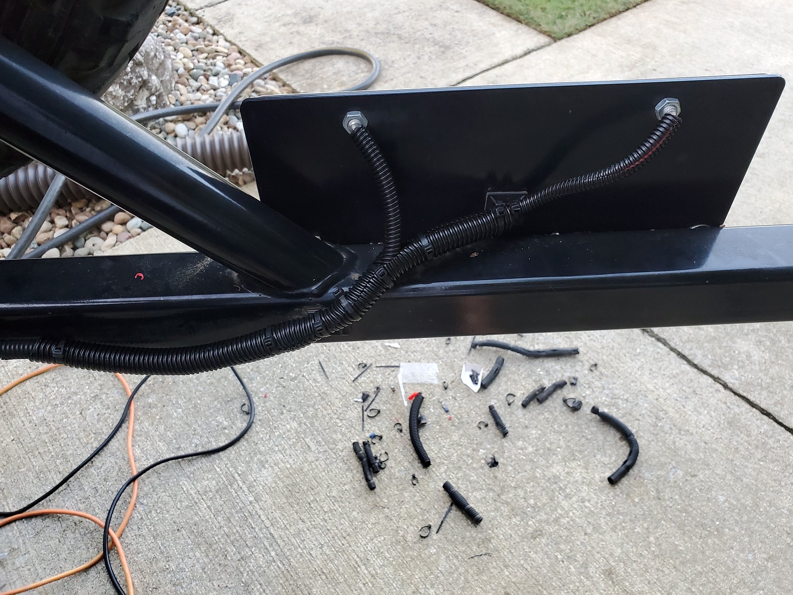

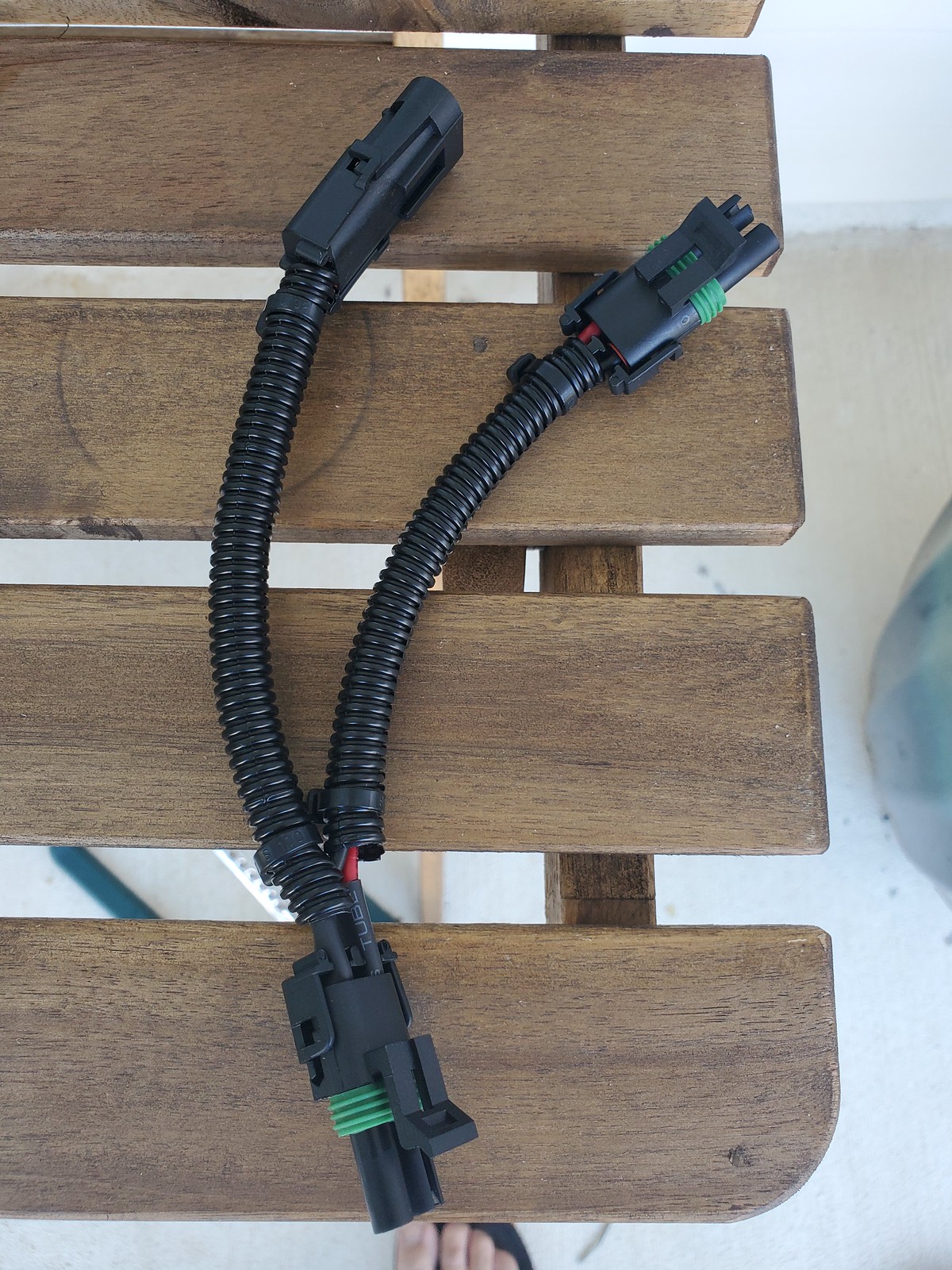

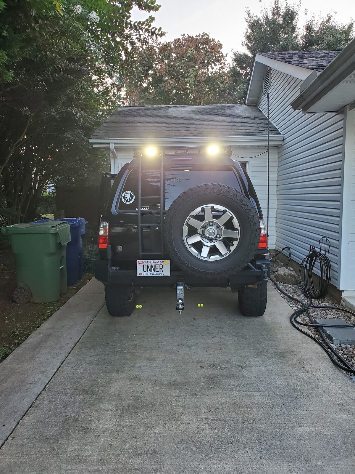

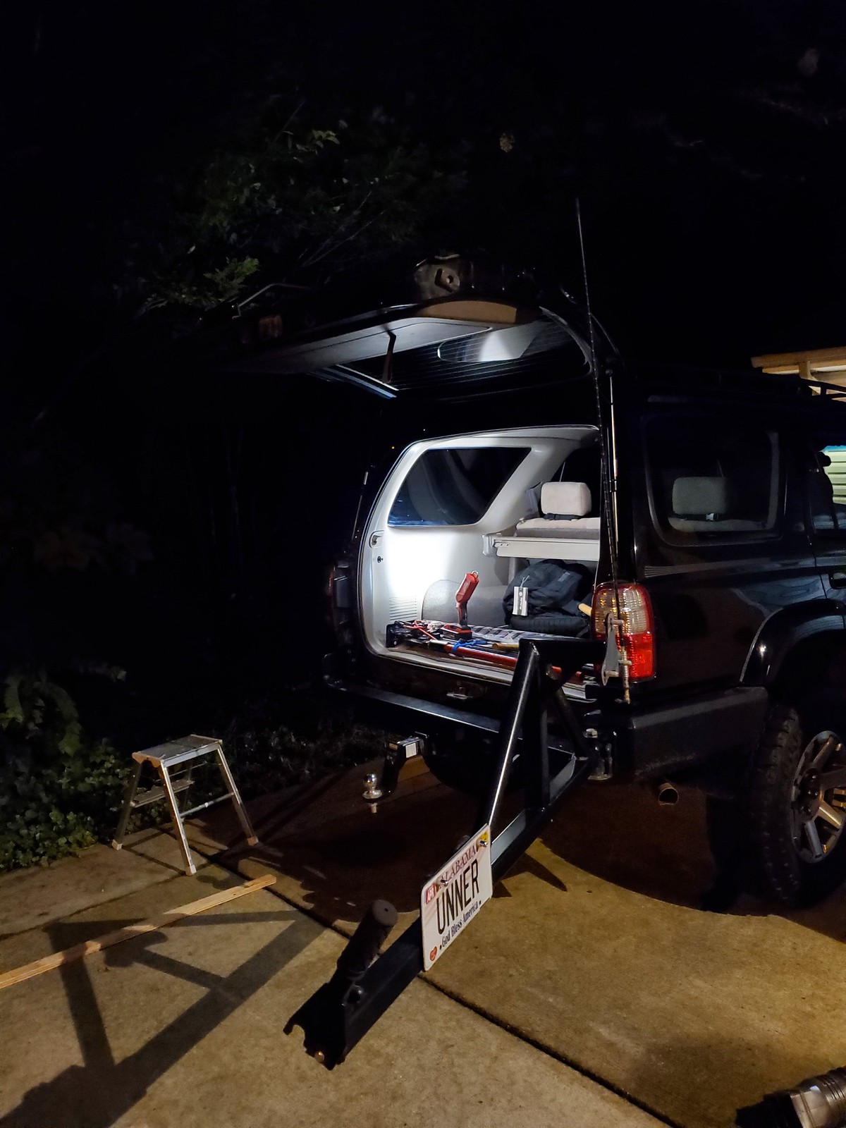

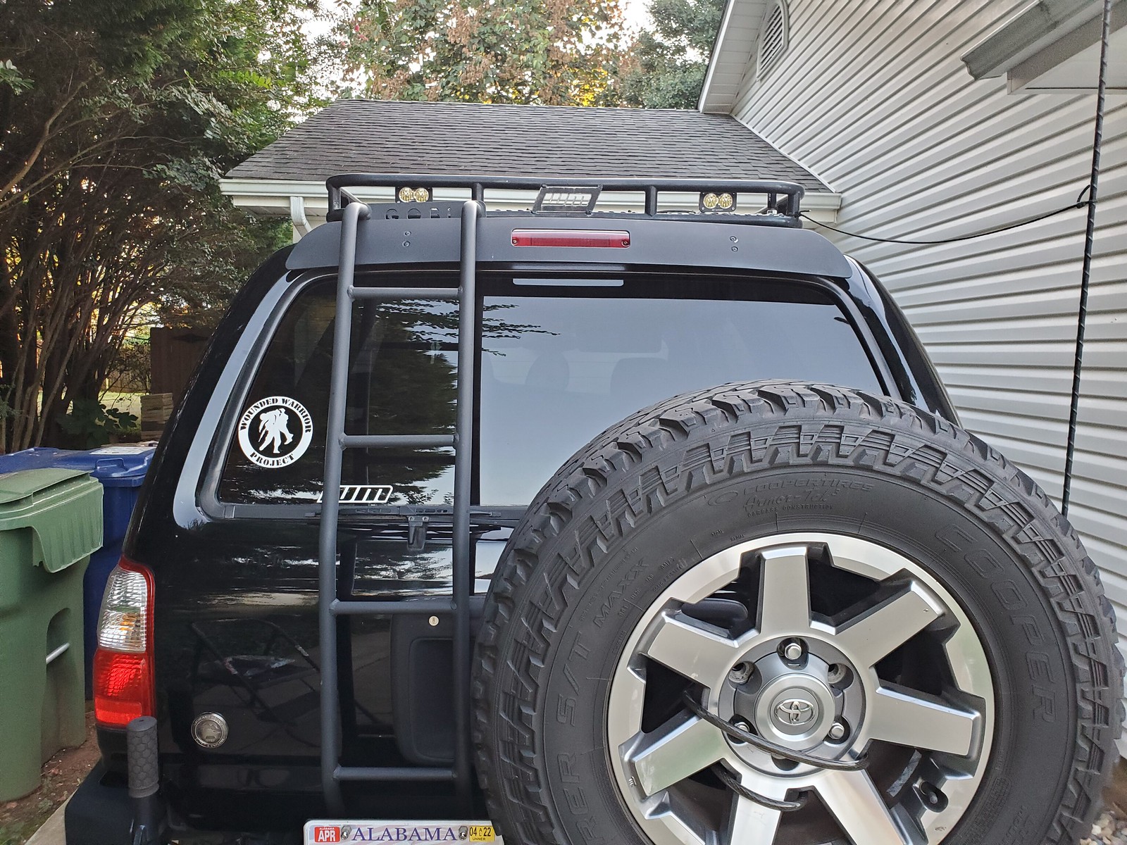

I got the Baja Designs rear lights mounted as well. These are their S2 lights in wide/cornering. I haven't got a chance to really use them, but I can say they are very bright.
Made a little splitter harness.
20210906_165454 by Unner Unner, on Flickr
Tried to keep the wiring as clean as possible up on the rack.
20210906_183946 by Unner Unner, on Flickr
20210906_183950 by Unner Unner, on Flickr
20210906_184002 by Unner Unner, on Flickr
20210906_183958 by Unner Unner, on Flickr
20210906_184400 by Unner Unner, on Flickr

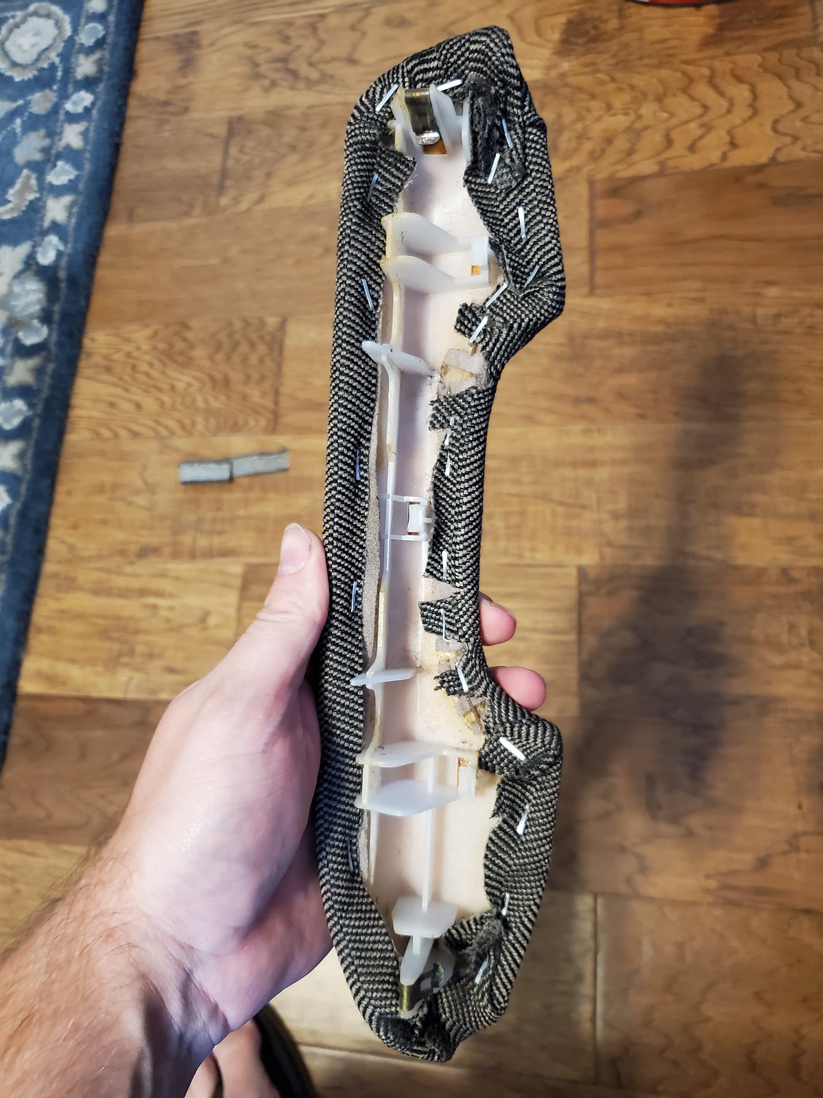

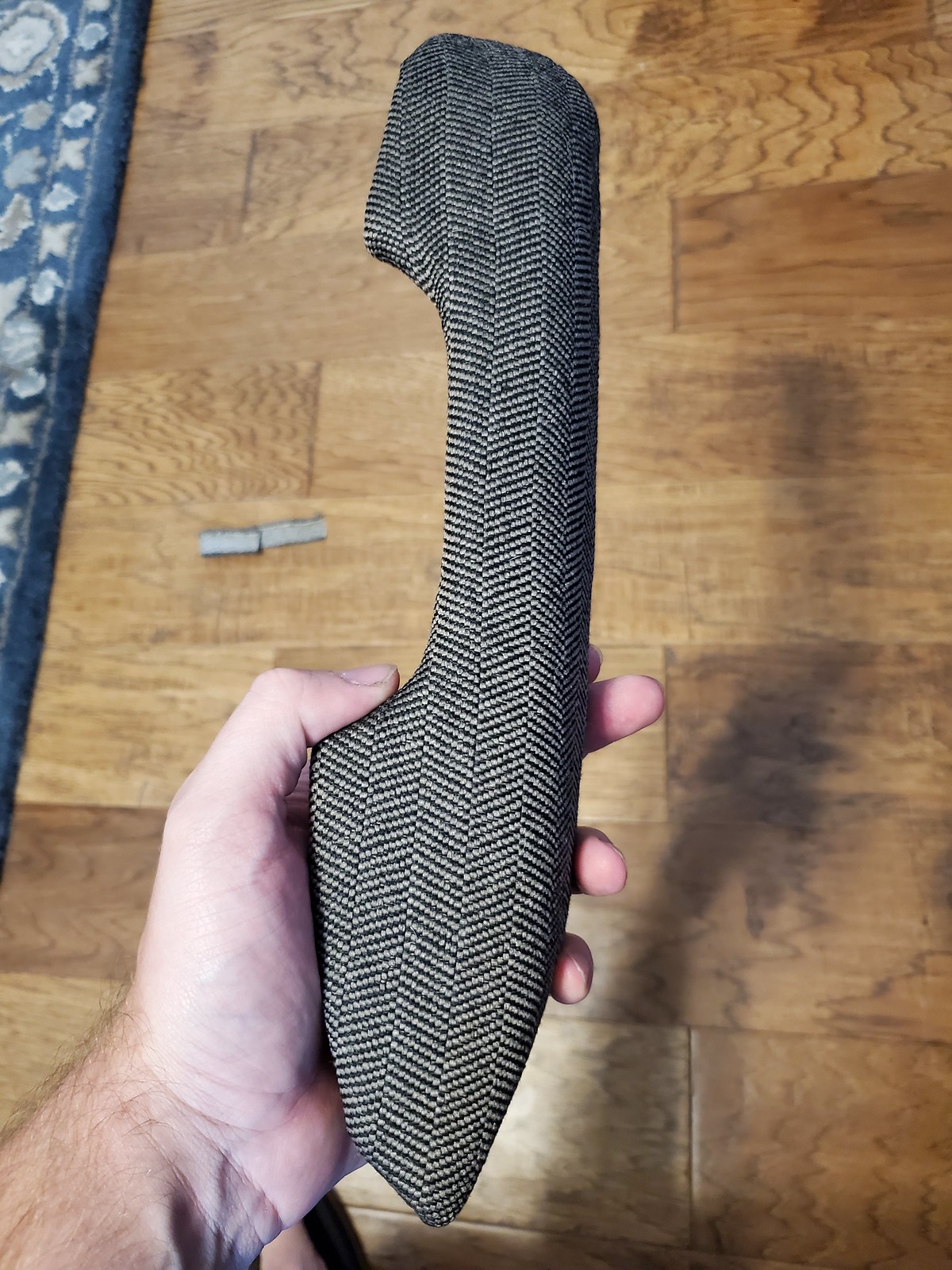

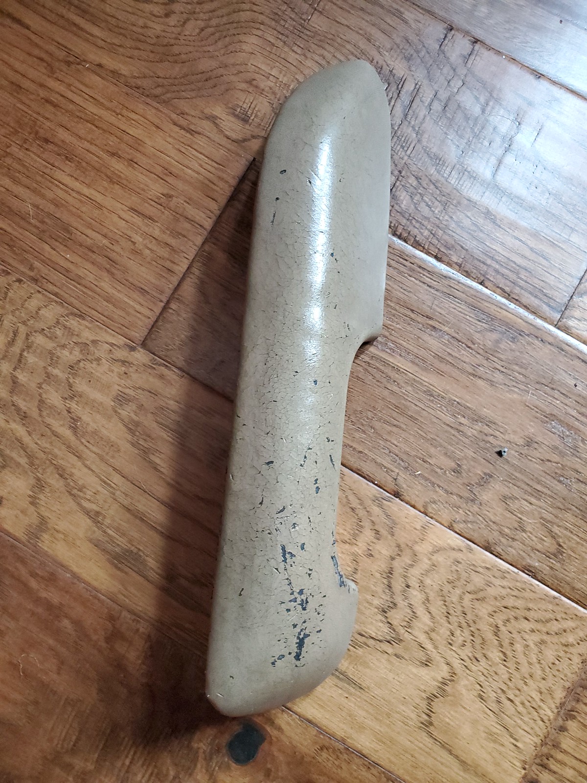

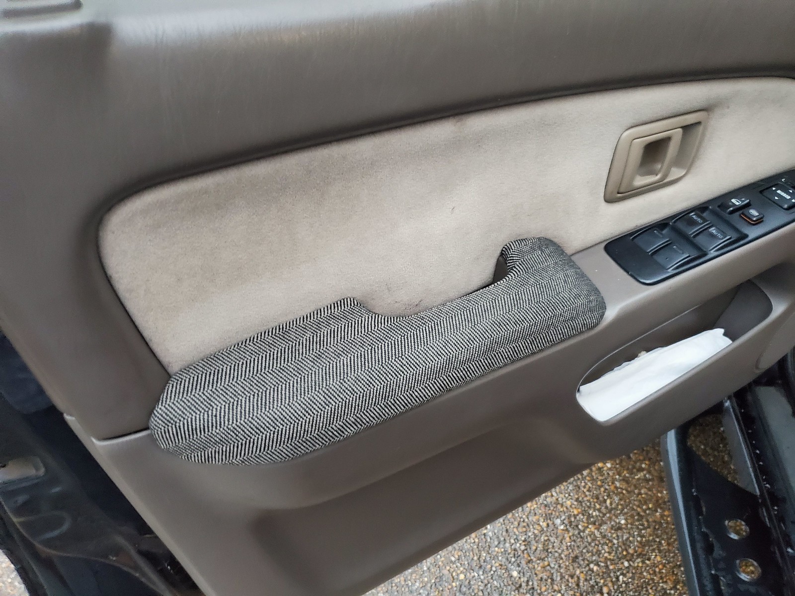

Years ago I had reupholstered my armrests with some vinyl I got at a fabric store. That didn't hold up too well over the years and was falling apart. I pulled the vinyl off and used some fabric I found. I like the new look, and hopefully it lasts longer than the vinyl. Good news is it isn't too hard to redo these if needed. Takes awhile for the first one, but the others go pretty quick then. Just use a staple gun, 1/4" staples, and a pair of sharp scissors to trim the fabric as you go around attaching with staples.
20210910_143822 by Unner Unner, on Flickr
20210910_143412 by Unner Unner, on Flickr
20210910_143408 by Unner Unner, on Flickr
2021-09-18_05-50-13 by Unner Unner, on Flickr

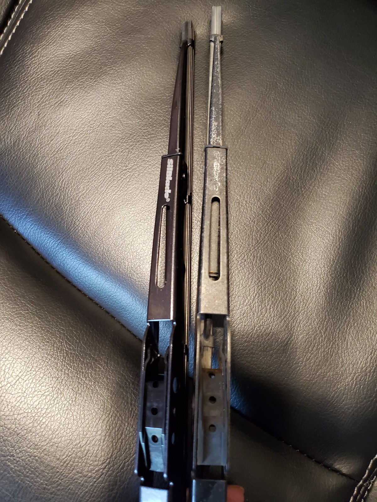

Put a new set of Sil Blade wipers on the 3rd gen also. The first set I put on in 2014, they still worked pretty well, but were looking rough. Can't speak highly enough of these wipers.

I haven't gotten to use them on a trail or any really dark areas yet, but that should change soon hopefully.
The nice thing with the Baja lights is you can swap the lenses to change colors and output patterns pretty easily and cheaply yourself. Just a matter of a few screws and swapping the lens.
That's super convenient that you can swap them like that. I looked into getting a lens cover or something for the KC lights, but it doesn't look like they make them for the older versions. I could see amber being nice to have for a campsite at night.
