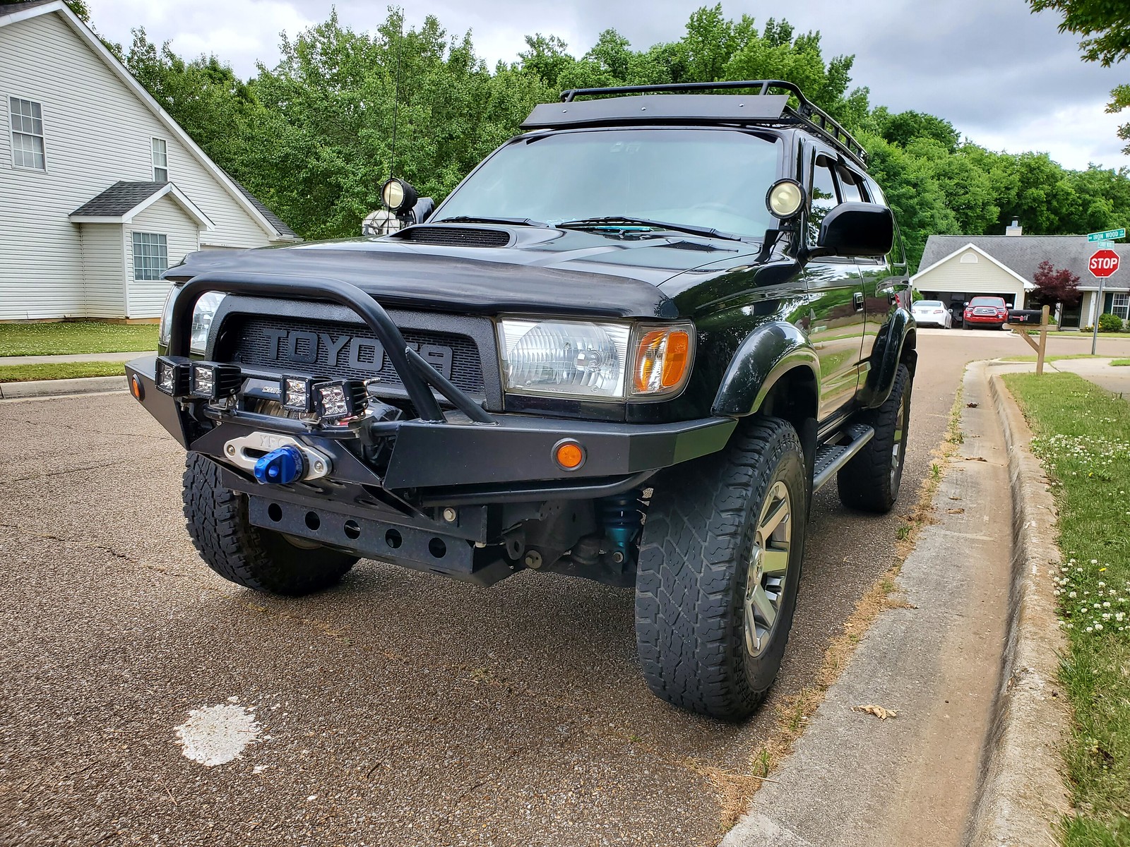

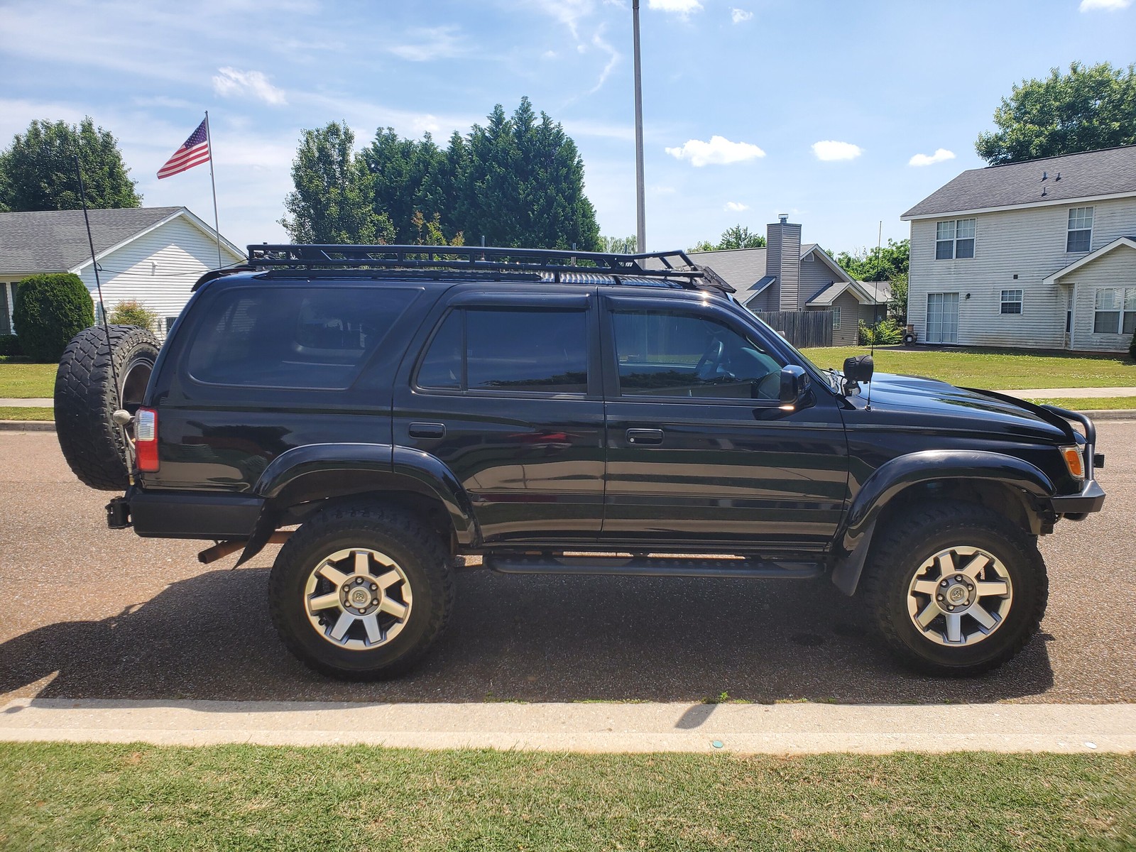

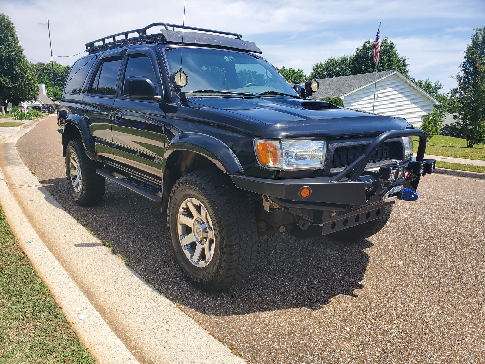

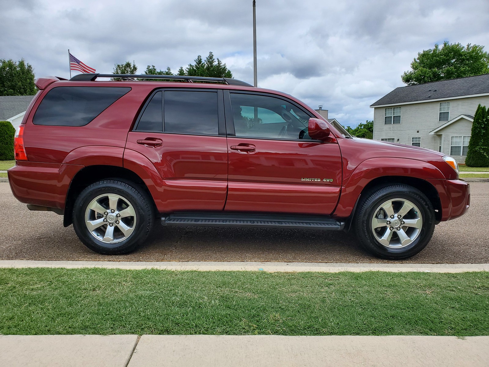

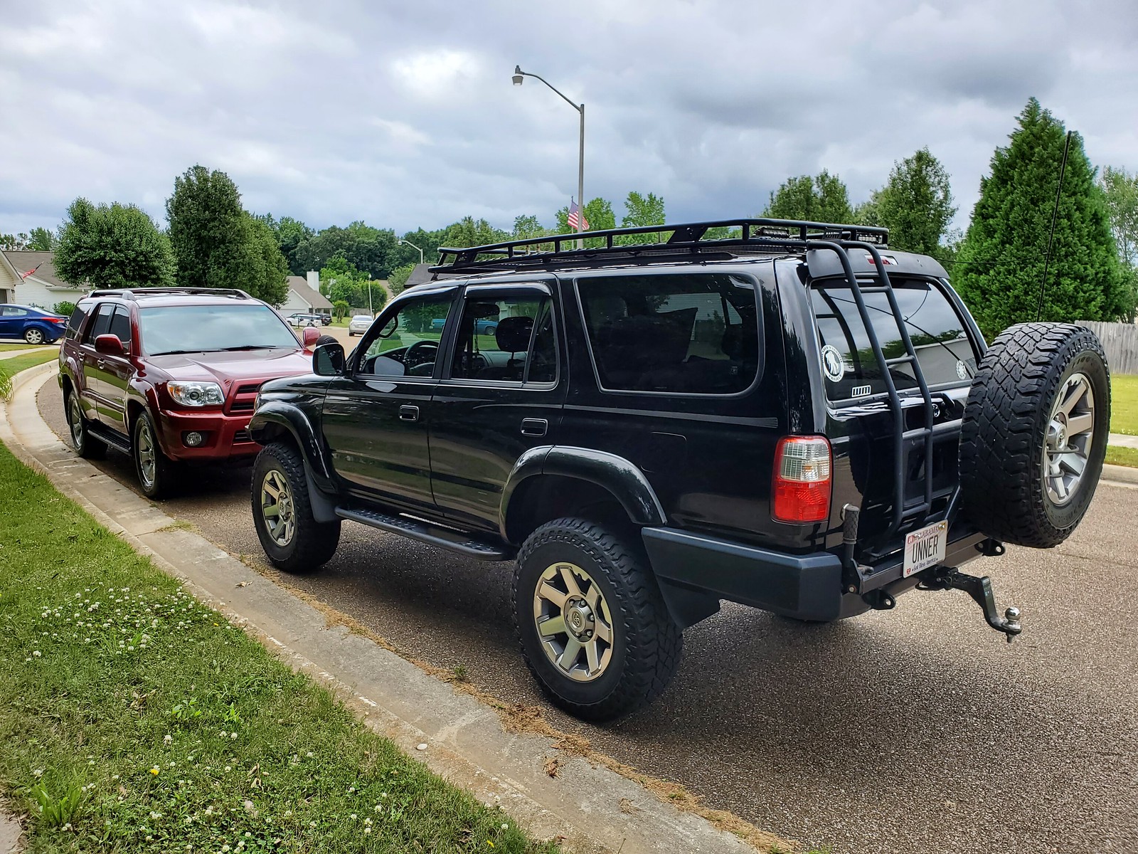

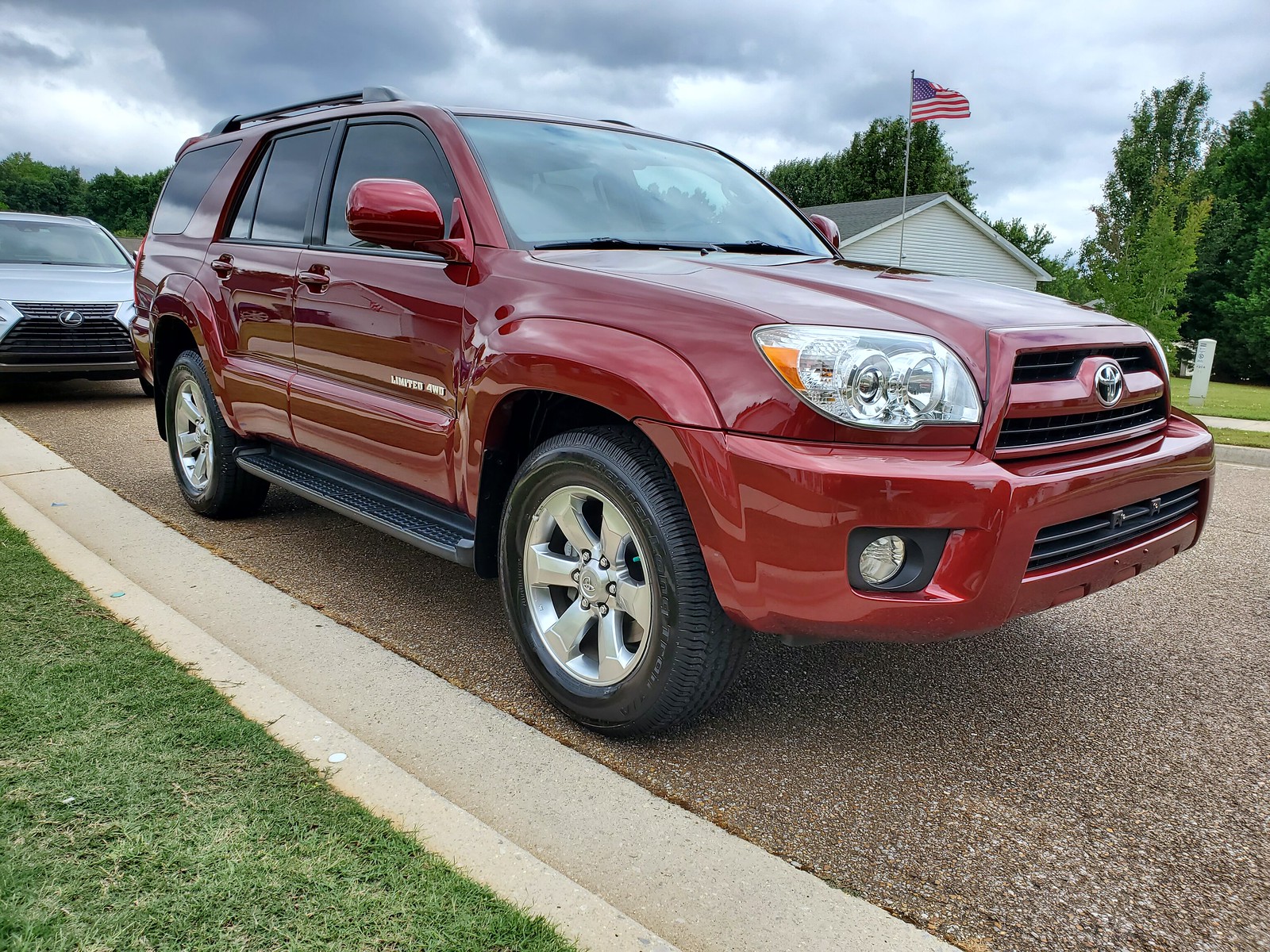

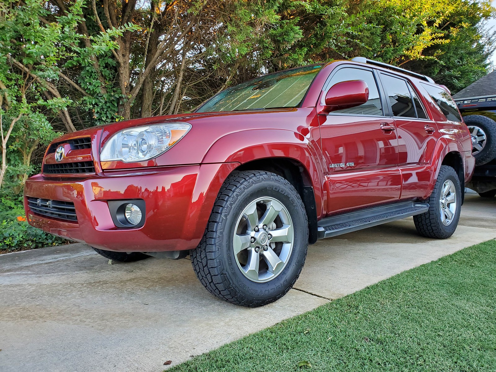

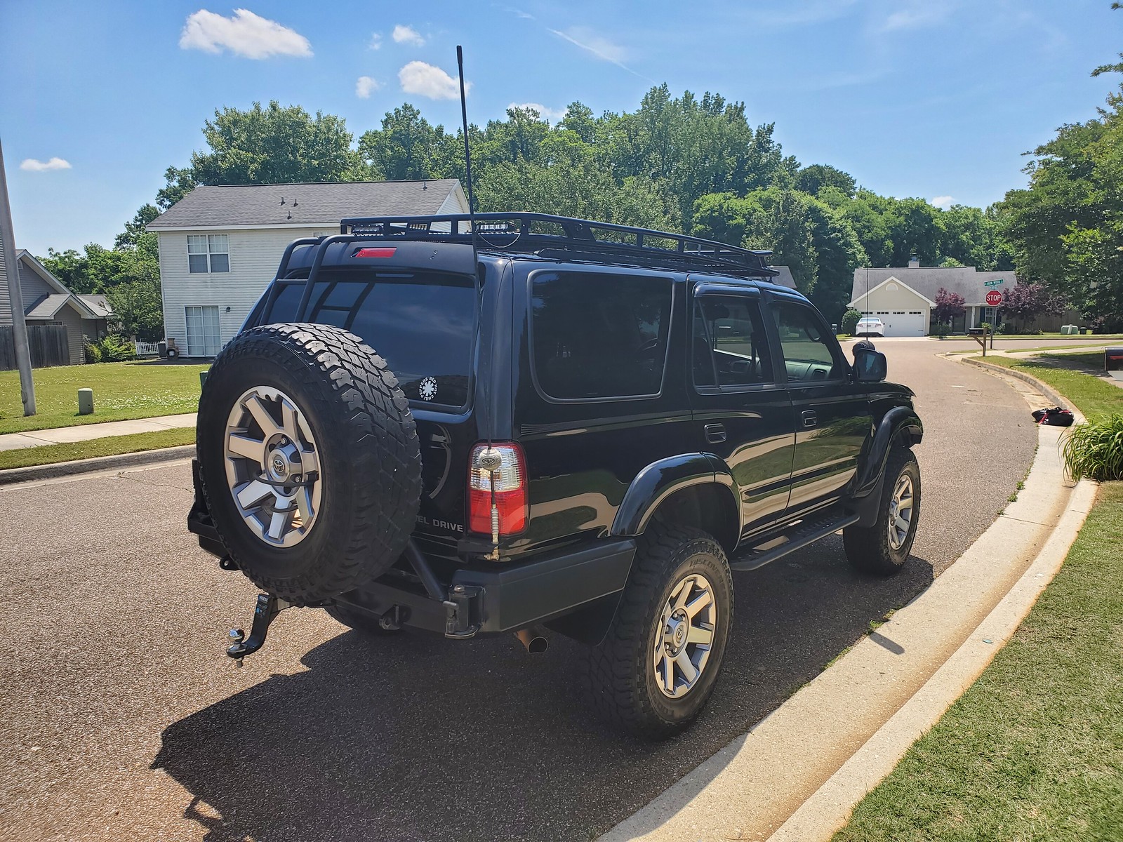

In the last couple months, both 4Runners got a full detail. Wash, clay bar, corrected some of the paint of the 4th Gen, and waxed both.

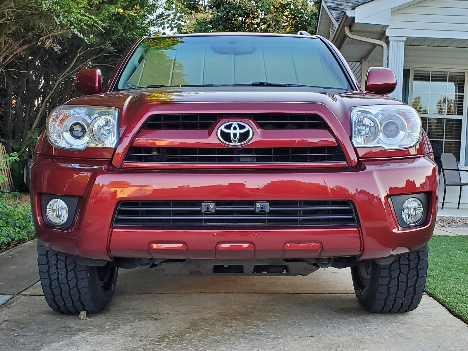

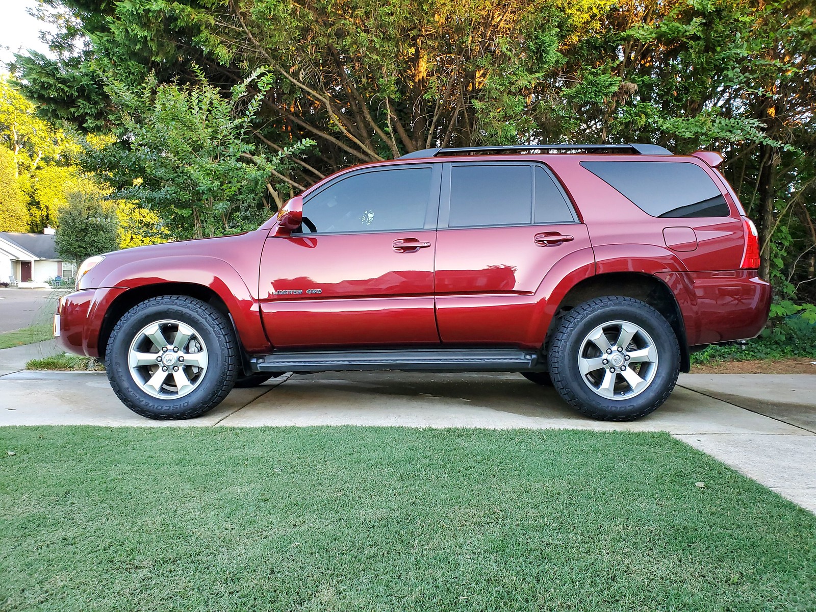

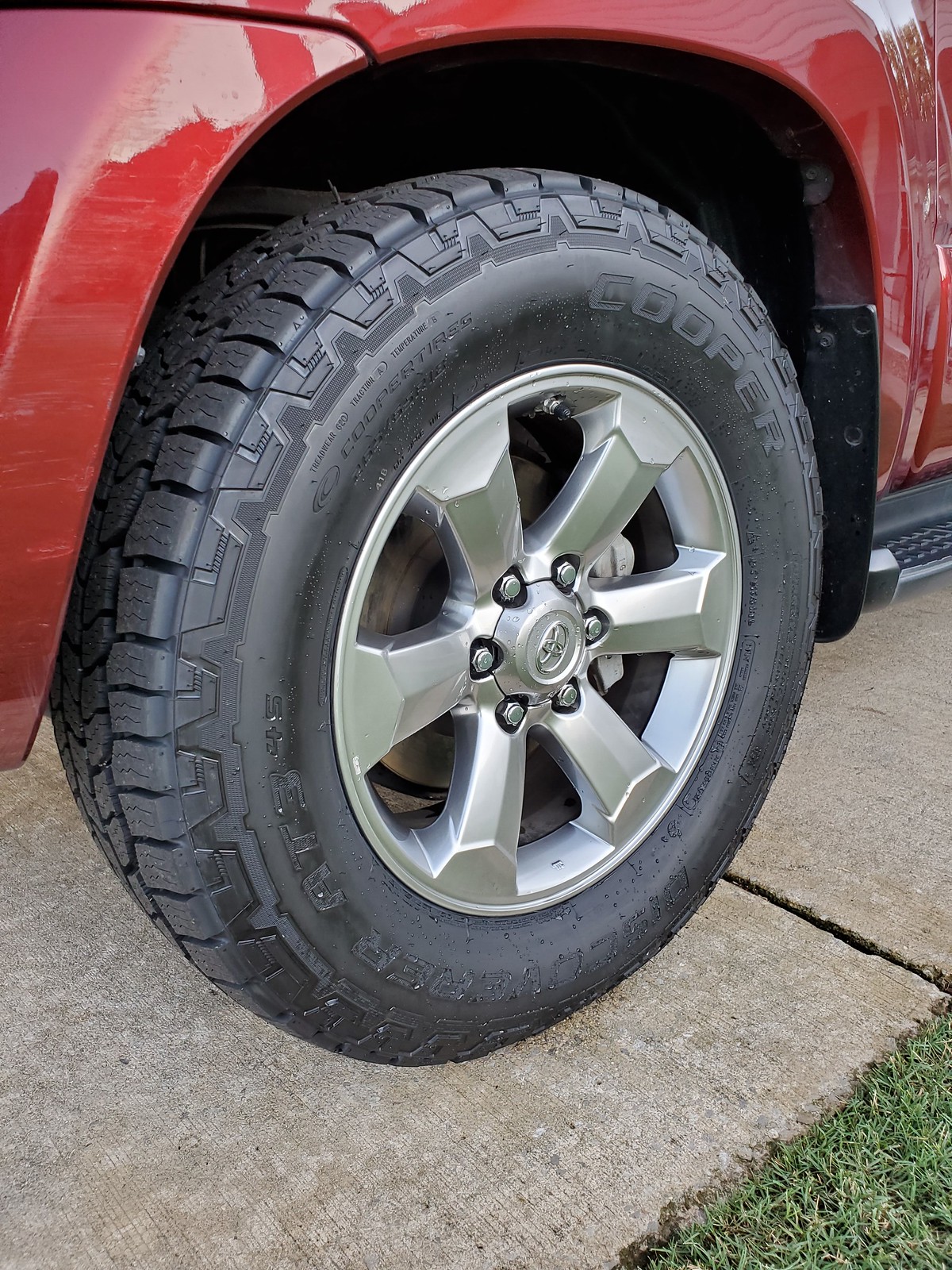

The 4th Gen got tinted and new bigger tires (265/65/18 in Cooper AT3 4S), and a Rexing V1 Dash Cam installed. Looks much better. :)
20210626_192937 by Unner Unner, on Flickr
20210626_192919 by Unner Unner, on Flickr
20210626_192948 by Unner Unner, on Flickr
20210626_192932 by Unner Unner, on Flickr
The Dash Cam in the 4th gen is powered through a Dongar adapter which pulls power from the auto dimming rear view mirror. My 3rd gen came with an auto dimming mirror from the factory, and has the same style connector. Their website doesn't call out anything older than 2003, but I don't see why it wouldn't work at least on my 3rd gen. If I ever have issues with the power cable for that dash cam I will be buying another one of these adapters. It doesn't get easier.

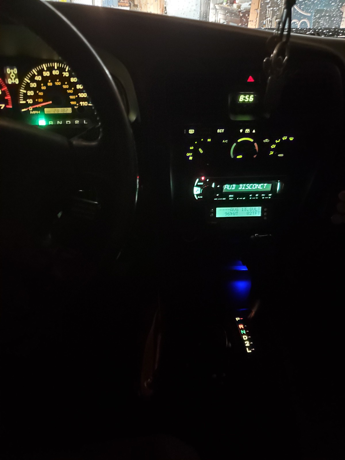

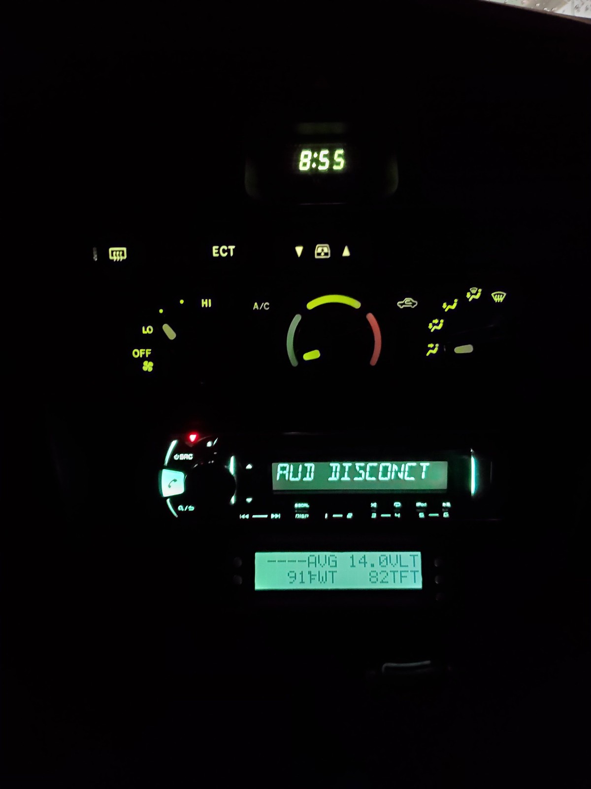

Finally got around to replacing all the burnt out dash lights. I just used OEM parts, no worrying about finding the right bulbs, color, eliminating hot spots, etc. Keeping it simple has it's place with some things. It's nice having everything all lit up again. I believe some of these like the window and hazard buttons have never worked since I've owned this thing though.

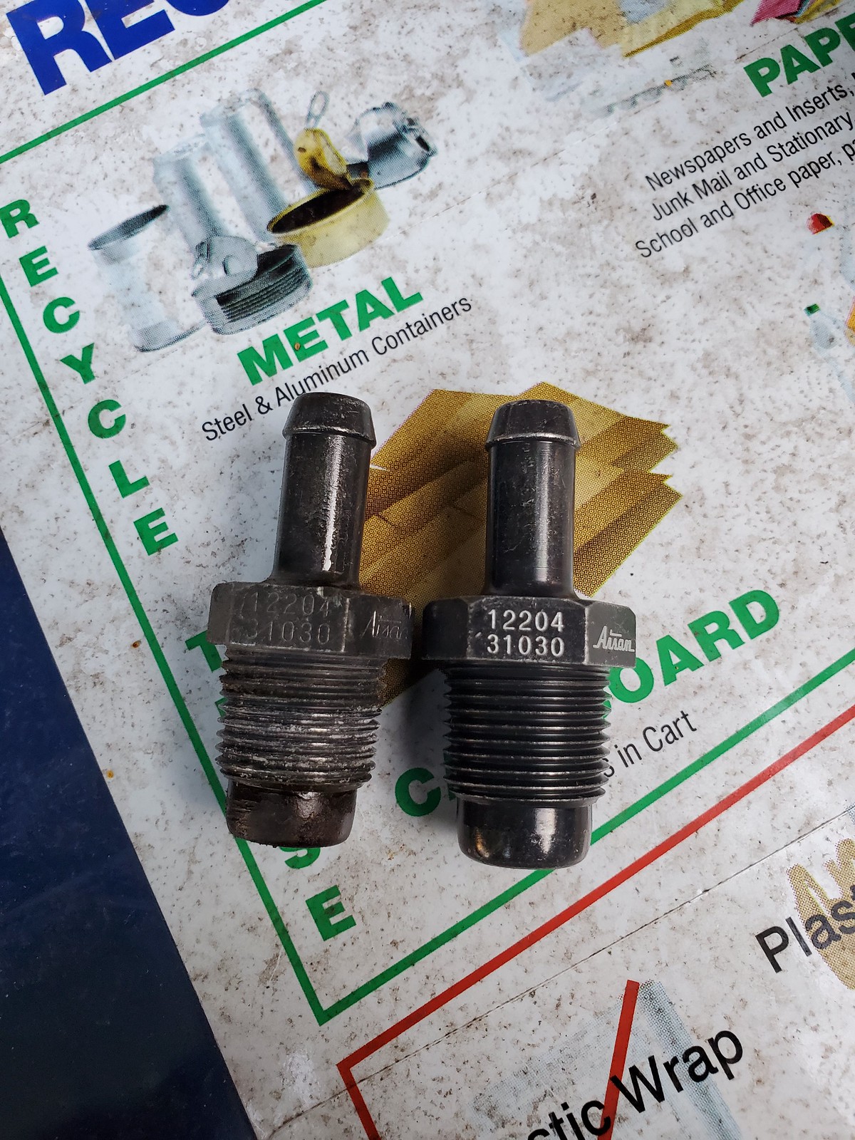

Did a little maintenance this weekend. New PCV Valve and Grommet. That stupid grommet always gets so dry and hard so fast. Tightened up the valve cover bolts I could get to, and cleaned the throttle body and MAF. Still need to grease the driveshaft, flush the brake fluid, check the brakes all around, oil change, tire rotation, and then take it in for an alignment and tire balance.

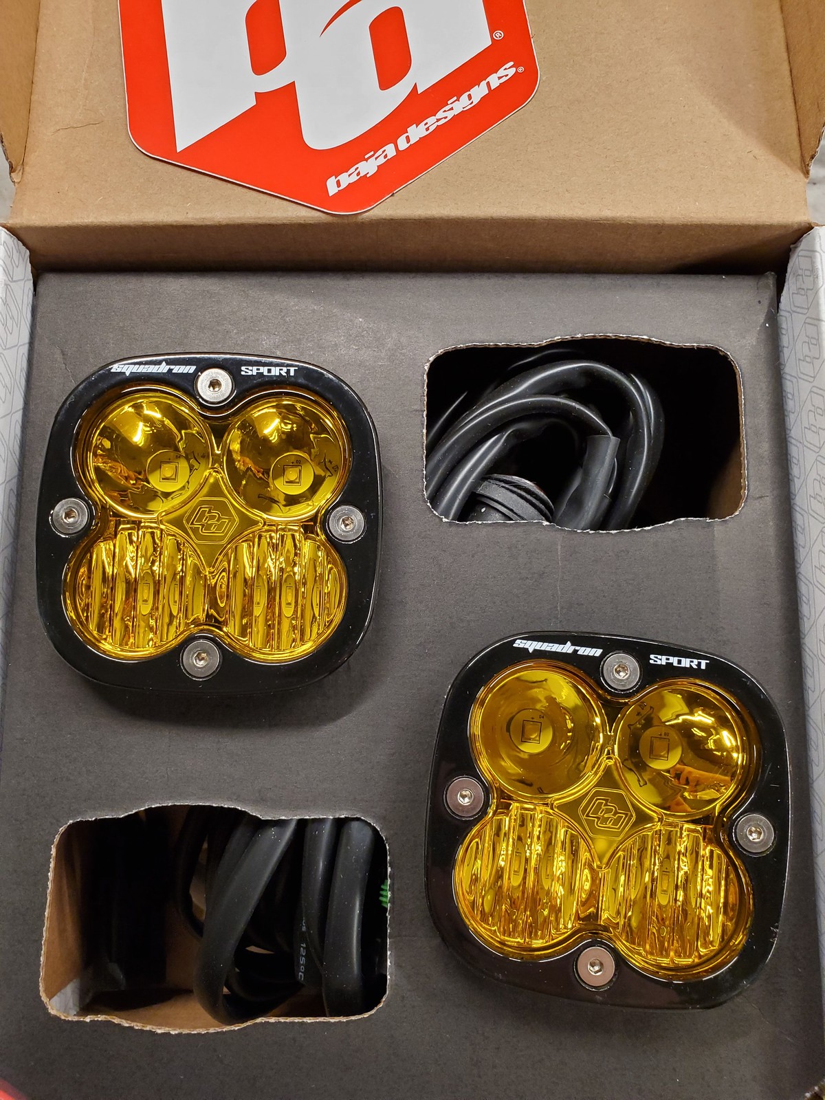

Lots of purchases the last few weeks.
  • Primelux LED lights
  • Baja Squadron Sport Amber in Combo Pattern
  • Security Hardware for the lights above
  • Strongarm 6815 Rear Hatch Struts
  • Depo Headlights
  • New Interior LEDs and Front Corner LEDs
  • New door checker hardware
  • 6.5" Kicker speakers for the rear doors
  • New Silblade wipers

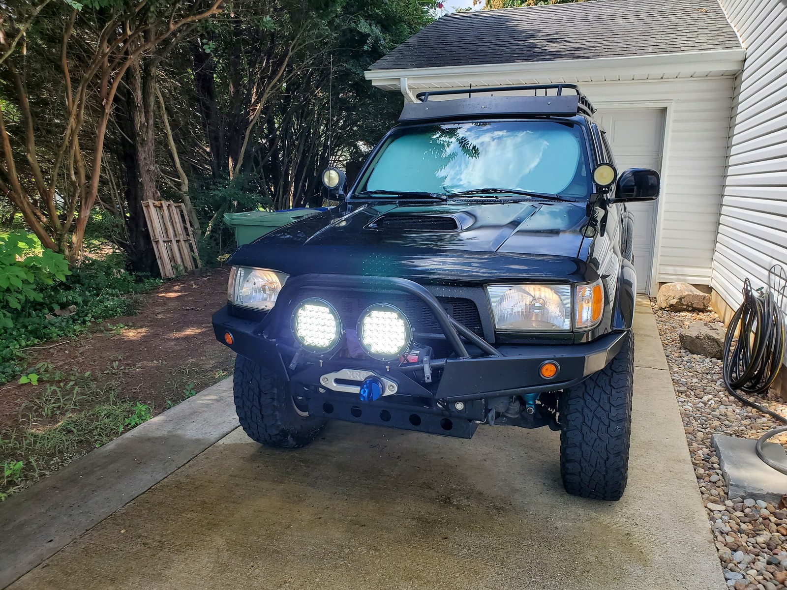

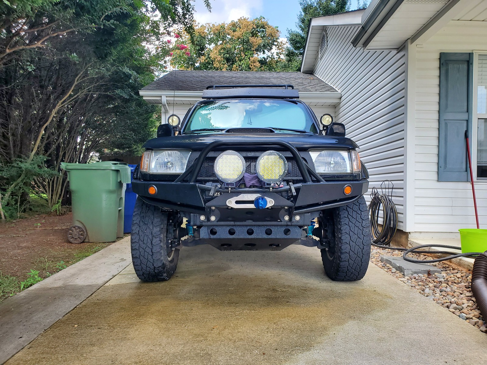

So far the only thing I've installed is the Primelux lights. They still need the security hardware, and I need to put some rubber on the top crossbar of the winch. The lights barely fit, by a couple millimeters. But they look good I think, and they are crazy bright. They pull a pretty good bit of power for LEDs though, so they are actually wired to separate switches. One is on the factory fog switch on the stalk so it's super easy to turn on and off, and the other is on one of the switches I had added to a previous blank to the left of the steering wheel. The Baja lights are waiting on a weatherpack crimper tool to show up. I still need to figure out a replacement set of lights for the rear of the truck too.

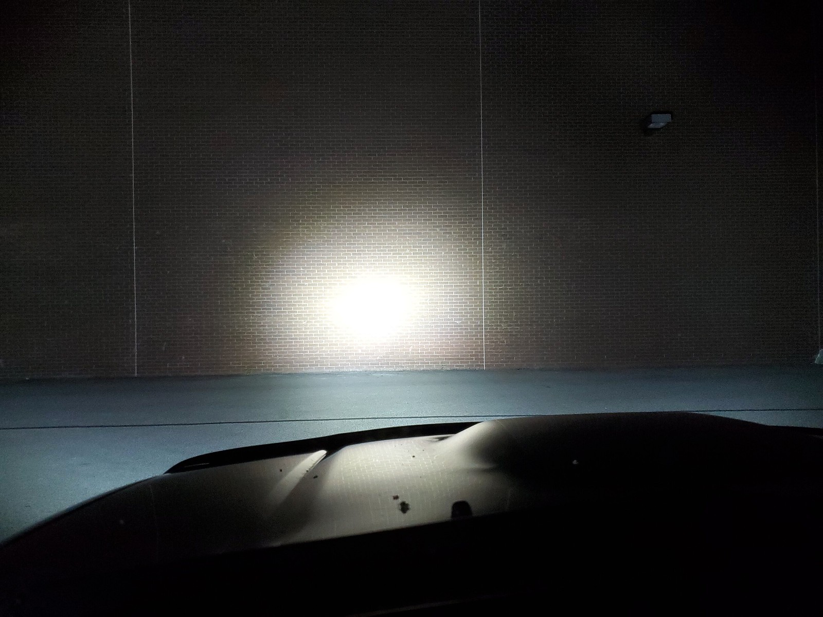

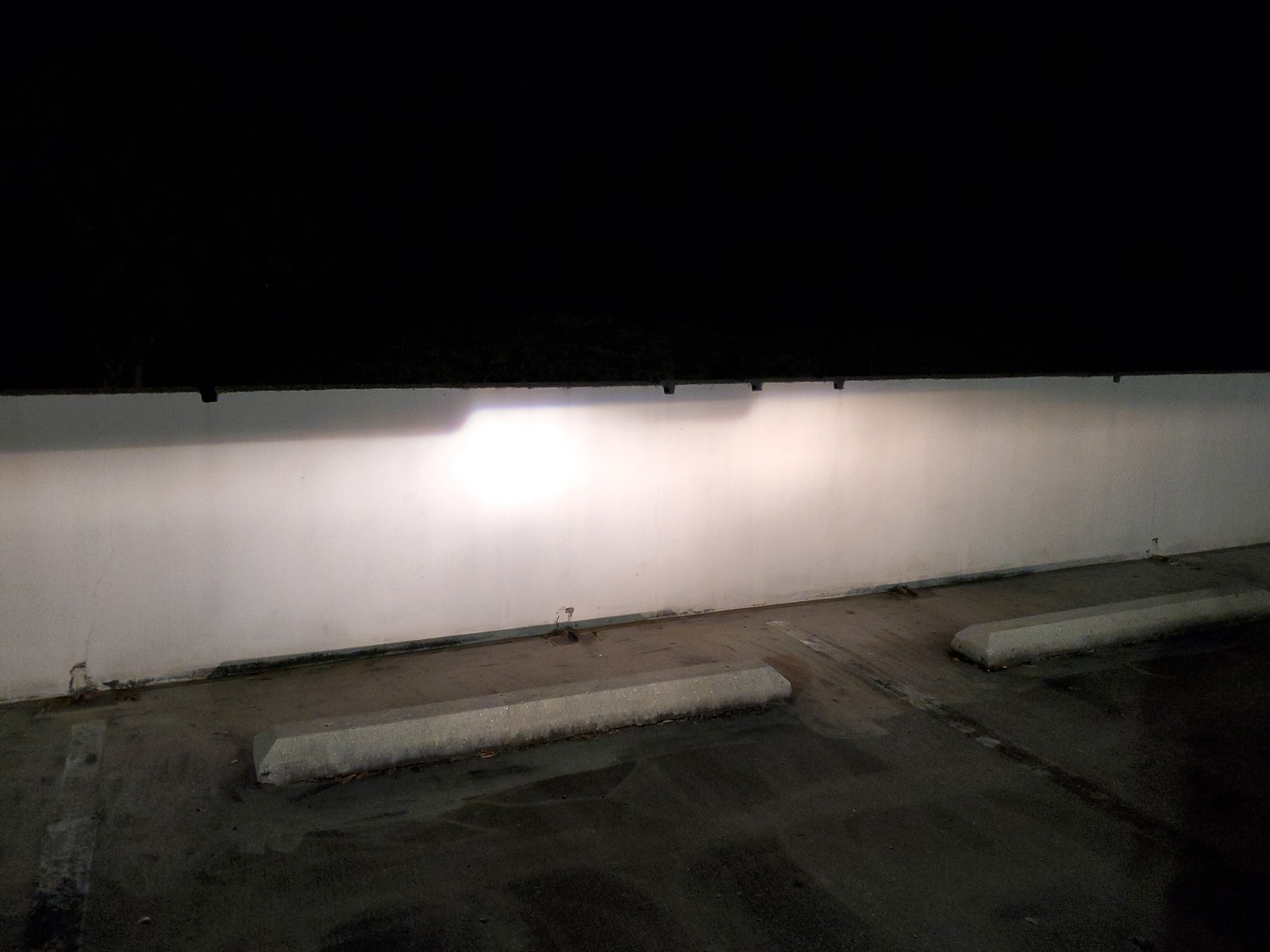

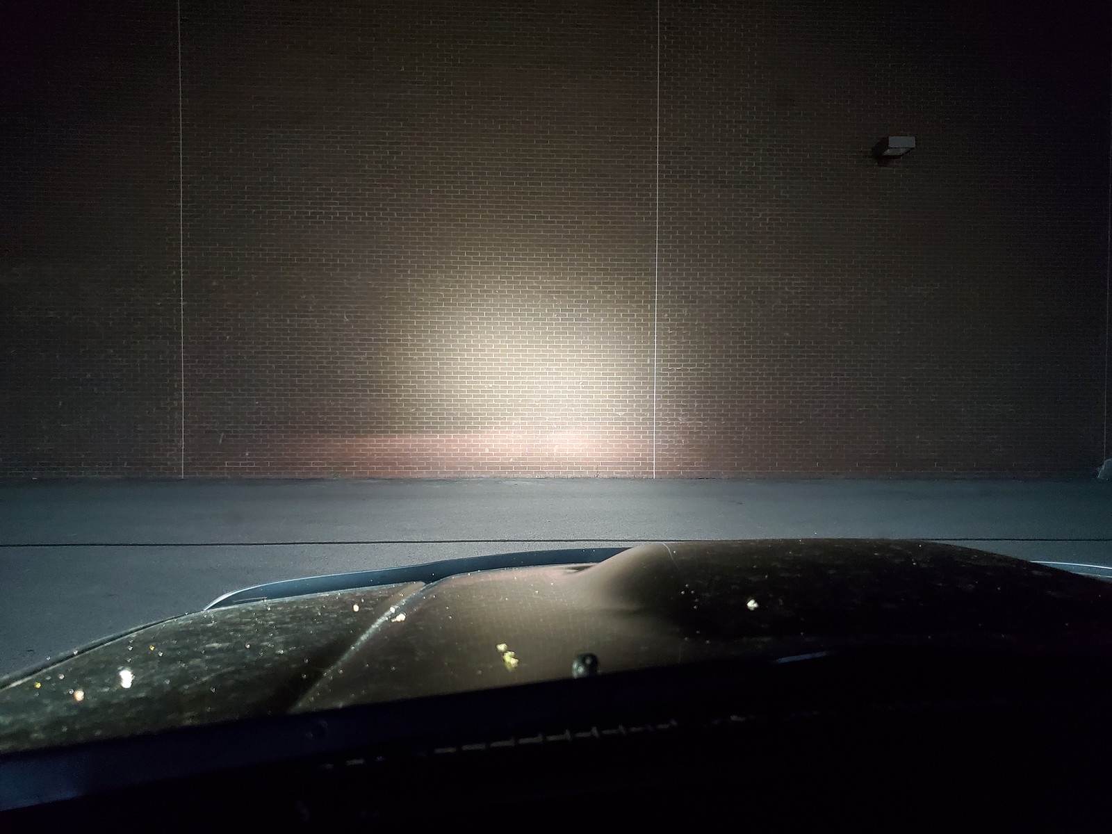

A few bad pics to show the brightness.
Low Beams only
20210811_005223 by Unner Unner, on Flickr
Low Beams plus Vision X Light Cannon Clones
20210811_005231 by Unner Unner, on Flickr
Low beams plus Primelux lights
20210811_005334 by Unner Unner, on Flickr

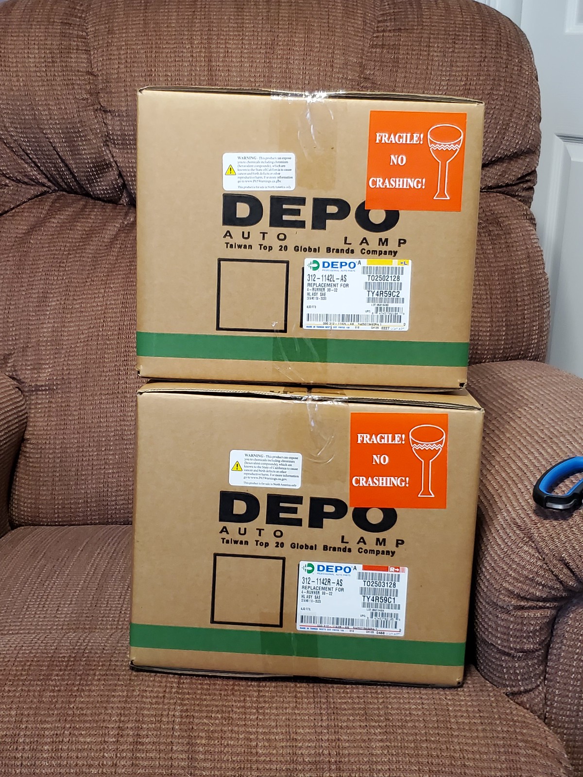

I decided to try a new set of Depo headlights since I got them for under $100. My original ones are starting to peel inside and the chrome isn't as reflective as it should be after 20+ years and a trip to the moon and some of the way back. I'm hoping the pattern is good on these. If it's not I may go for a retrofit, maybe. I do like how simple and easy the stock headlights are though...

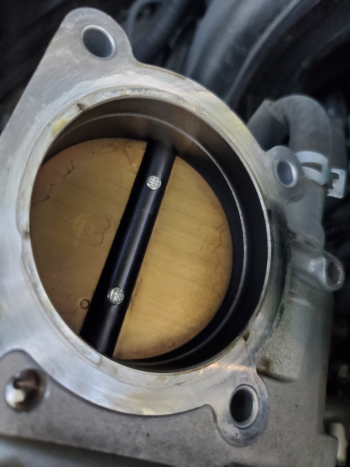

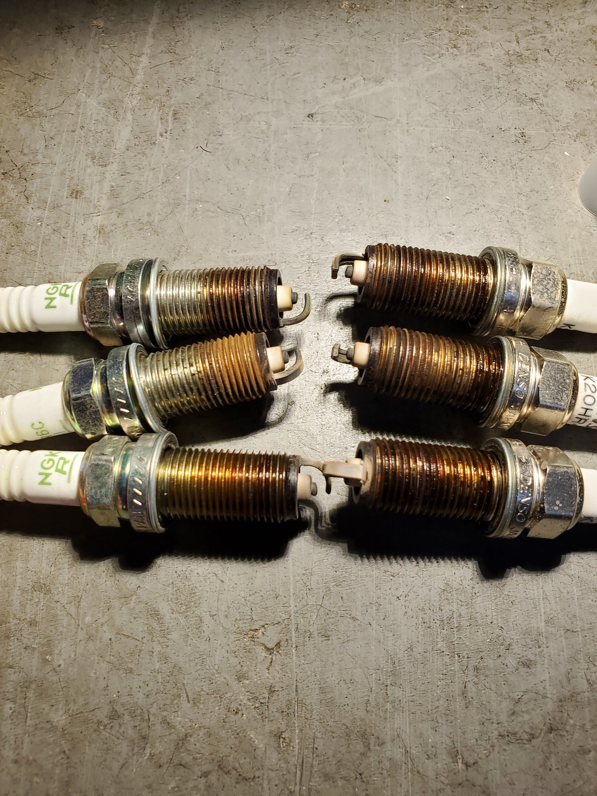

I also did some maintenance the last couple weeks the both 4Runners. The 3rd gen got the driveline greased, and the 4th gen got the original plugs replaced, a new PCV, driveline grease, throttle body cleaning, and MAF cleaning. Also put some better bulbs in the 4th gen. Phillips xtreme vision if I recall correctly. I love the projectors in there. New bulb is on the left in the picture.
