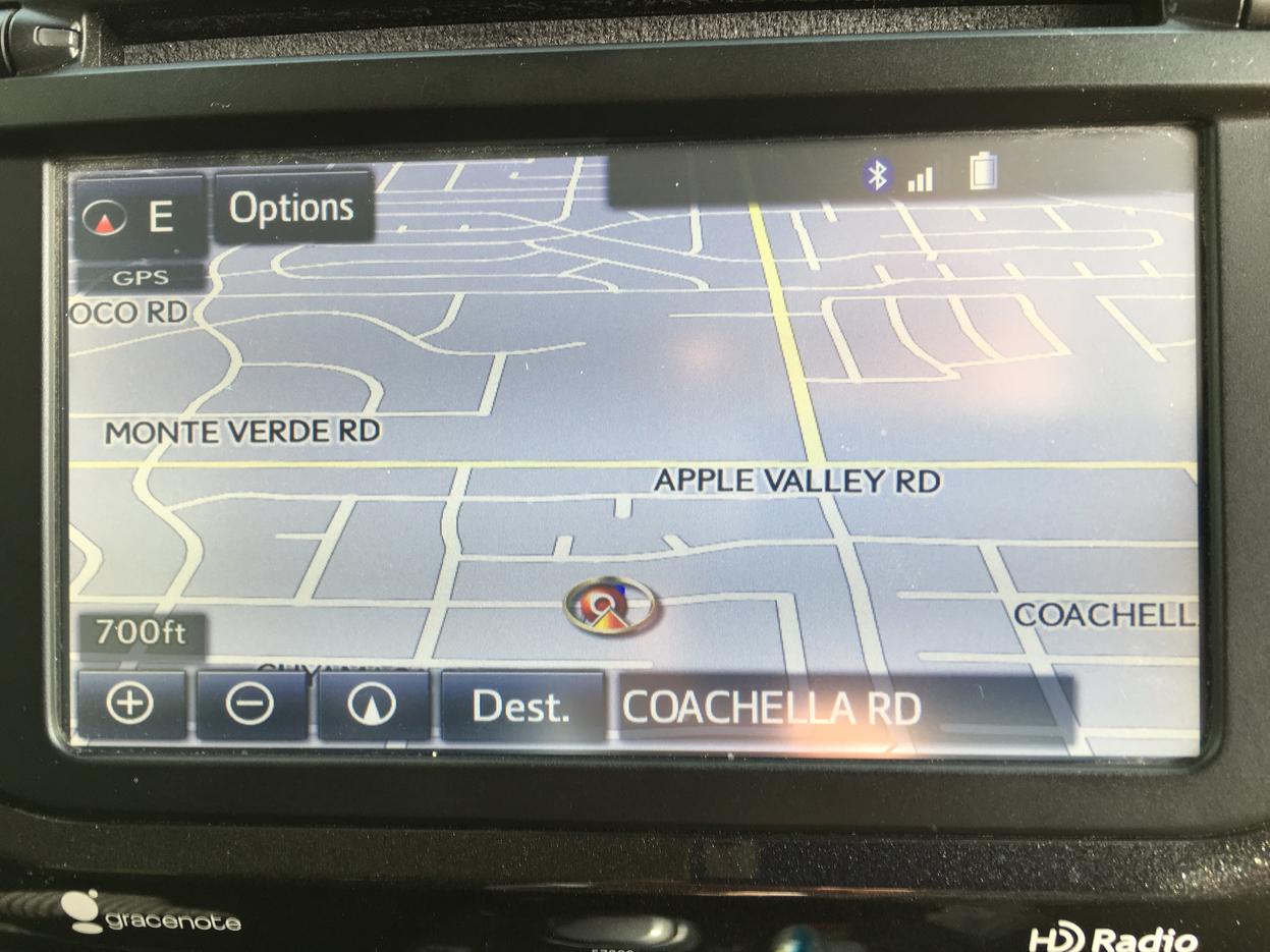

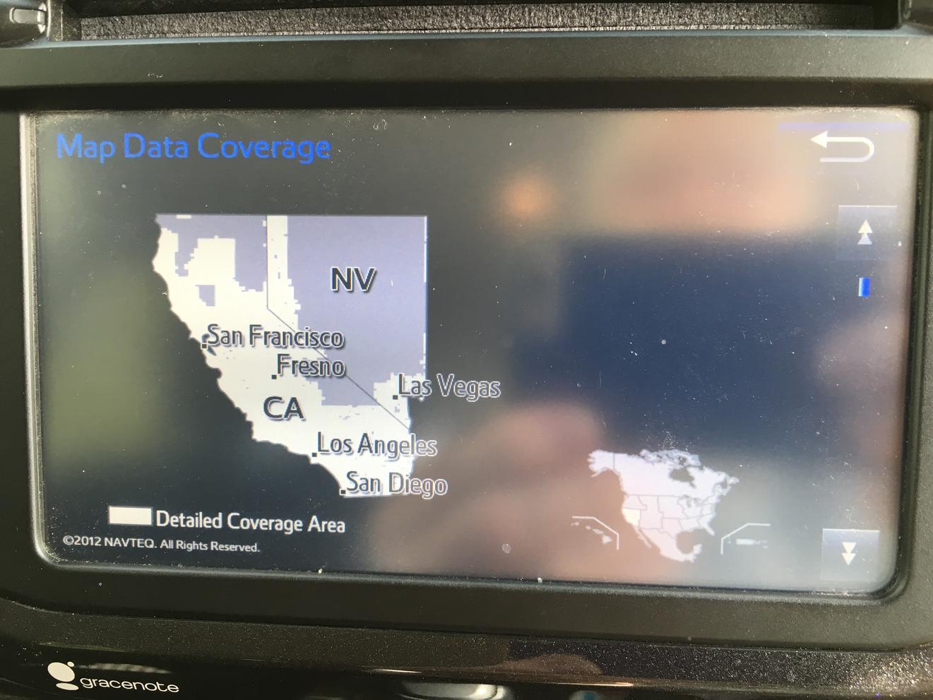

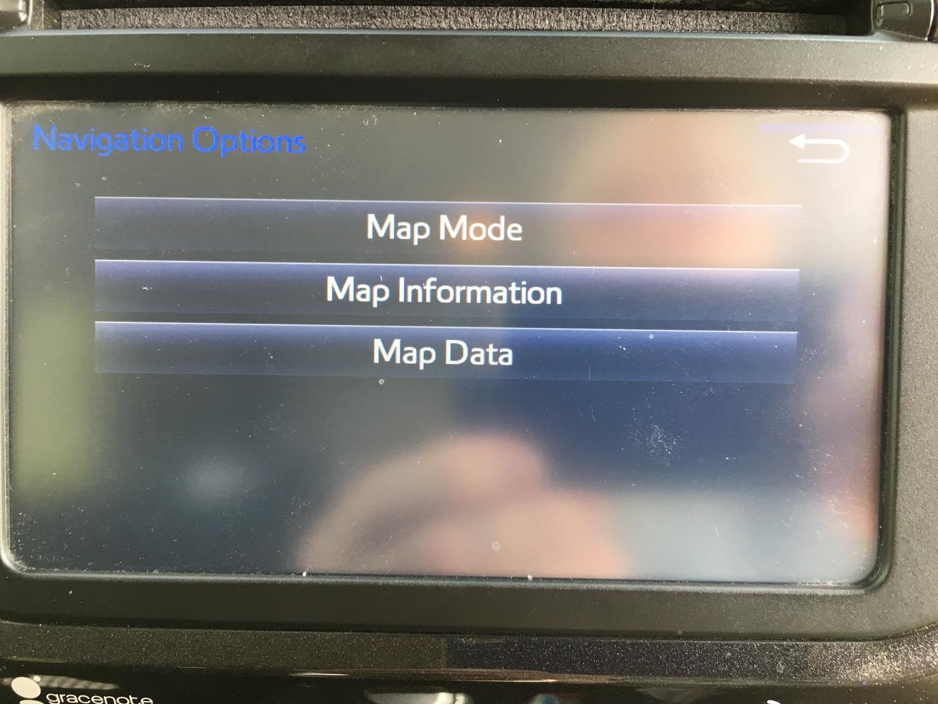

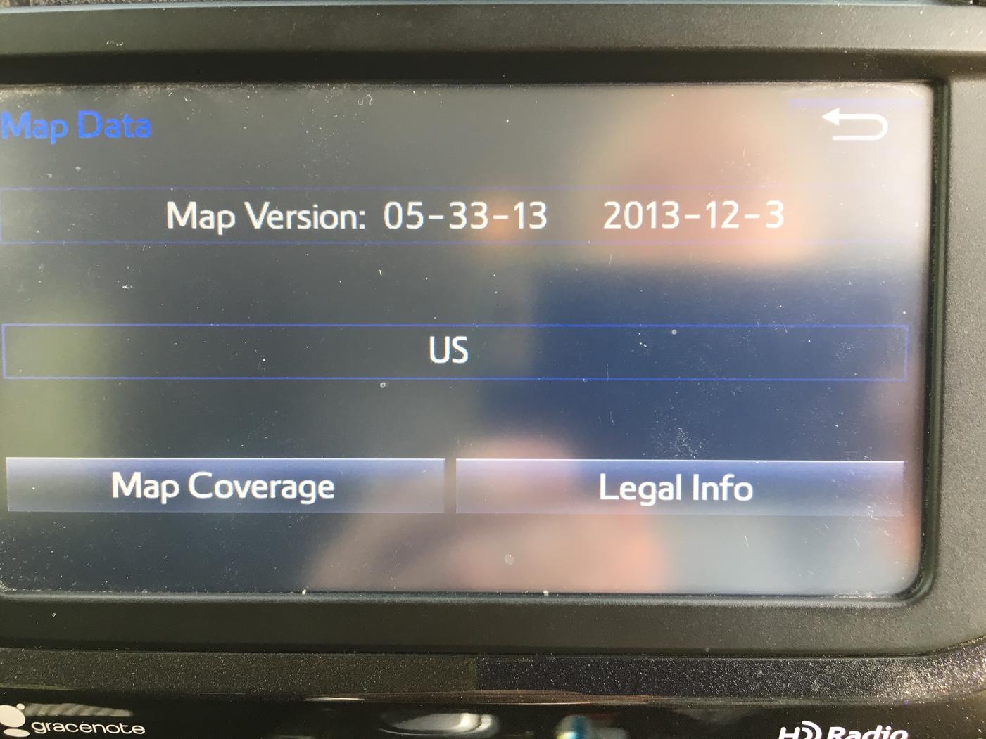

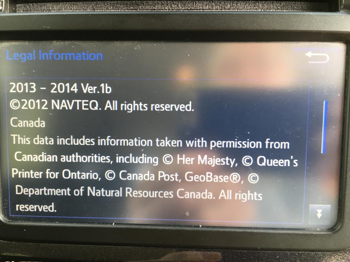

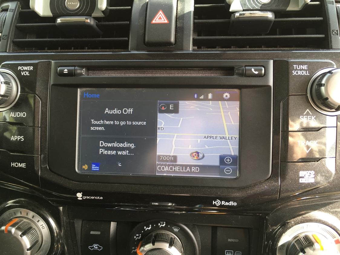

To Locate what you have map wise on the 2014 4R TE Entune system here is the following.
1st) shows the full radio, Lower right corner shows the Micro SD card location.
2nd) Go to the Navigation screen.
3rd) Upper Left corner has an option button, select it.
4th) on the 2nd screen the bottom selection is Map Data, Select it.
5th) on the 3rd screen shows what verison of map data you have.
6th (my area :hello: ) and 7th pic shows misc info about the maps.
So for the question on where is the MicroSD card, it is behind the little cover panel marked MicroSD.
For the question of what Map Version your or i have follow the list to the 3rd screen.
Hope this answers some questions.
