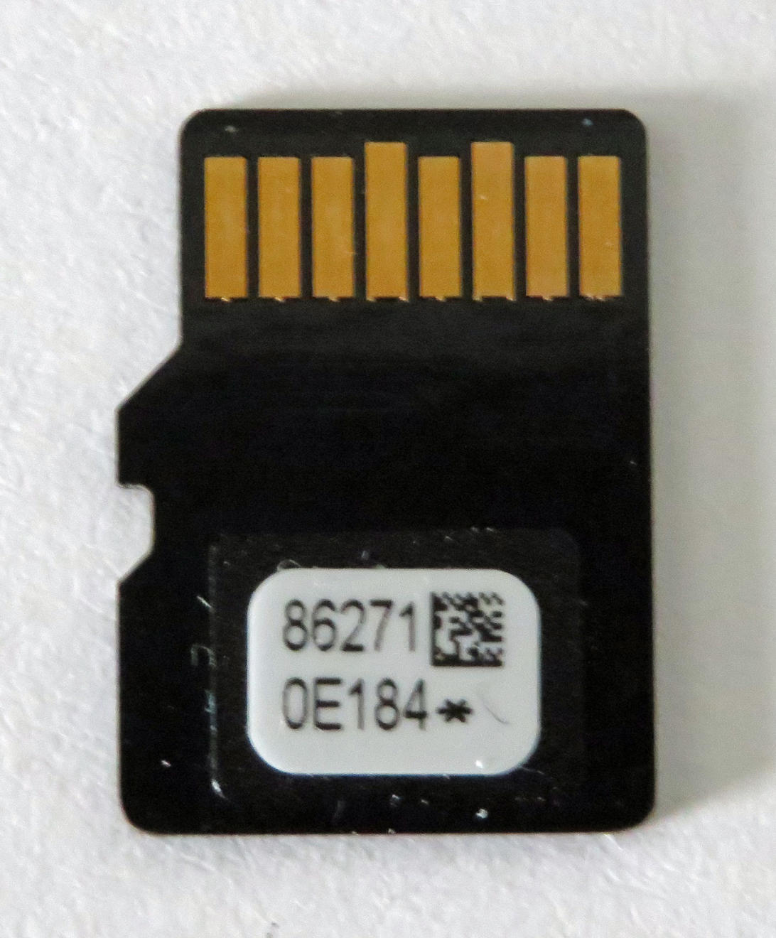

Part number for this newest card is 86271 oe184?
Yes, that's correct.

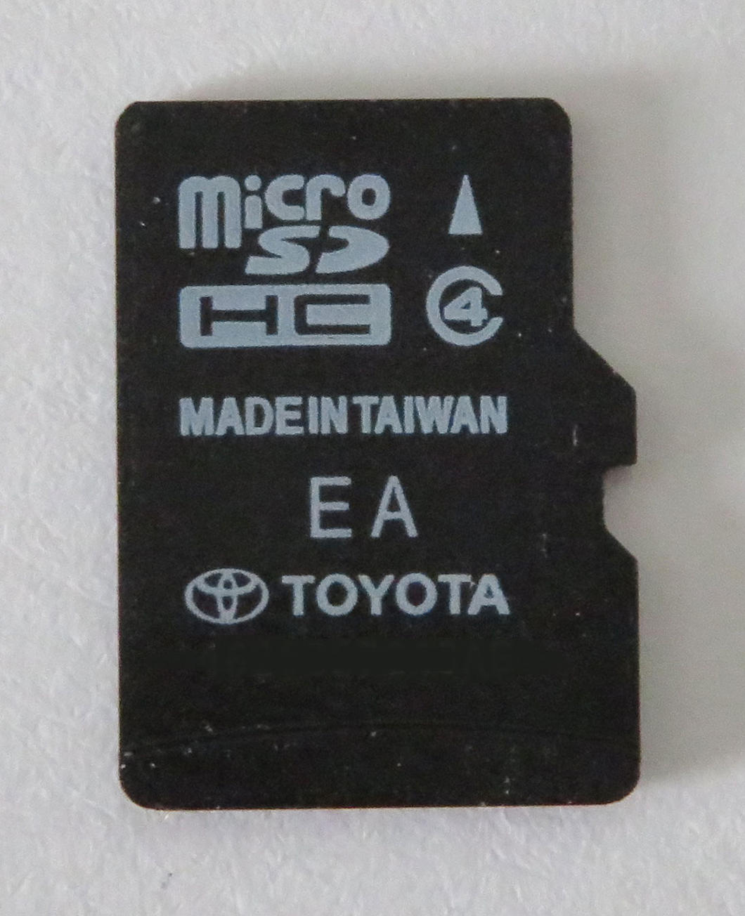

I think I also saw a reference somewhere on the web to a 86271 OE184a, but that's not the one I had. The photo is extreme macro mode so it's a bit fuzzy.
