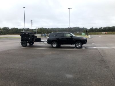

We only really tow with our 4Runner but we lost about a 1mpg going to 275 KO2's from the stock 265 bridgestones. I also put on a stage 3 ironman lift at the same time I added the new tires.

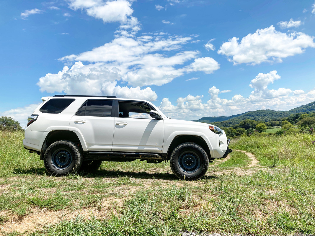

Lost 1MPG going from Nitto Terra Grappler 265\70\17 SL load @ 40lbs each to Toyo Open Country RT in 285\70\17 E load @ 60lbs each. Definitely can feel the sluggishness of the bigger\heavier tires even with the supercharger, but all this was to be expected. The supercharger definitely helps, and it can still go if I need it to. I feel like it's not that I can't get the lost mpg back with the bigger tires, but that it's more sensitive. I have to drive really conservatively to gain back the lost in efficiency, easier on highway\freeway speeds. Once I hit city traffic, the MPG drops quick. All in all, I think for me the benefits of going to larger tires out weigh the negatives
3" toytec alumas
285's - e load
sliders - 100lbs
LFD "wide" skid - 75lbs
Warn bumper/winch - 144lbs
Average 17.3 mpg via trip and 17.1 via fuelly/manual calc.
TN hills and 50/50 driving.
