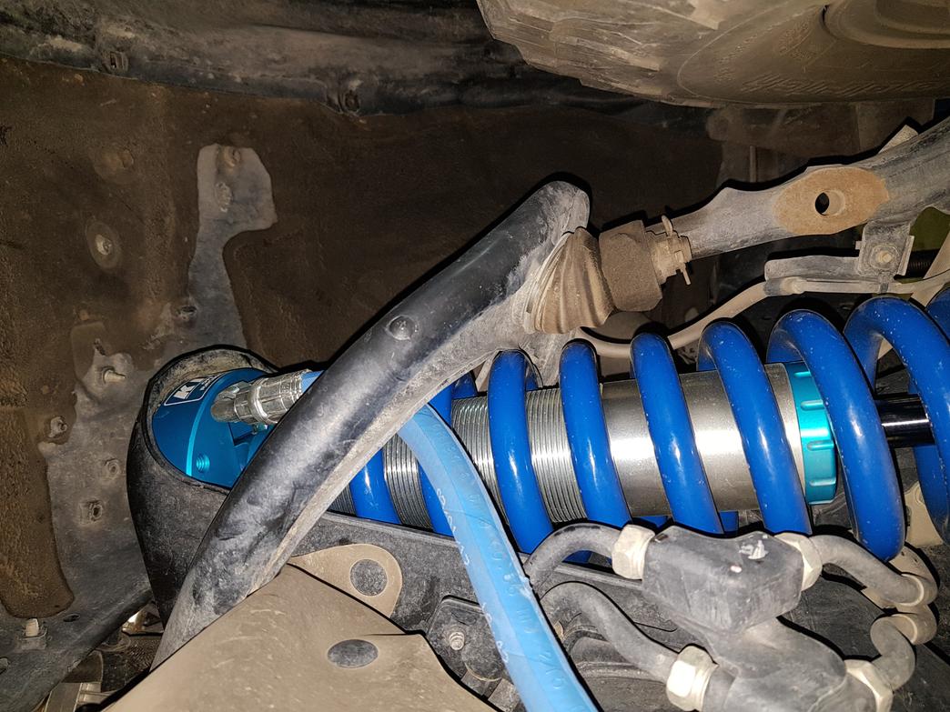

Only reason I went with aftermaket UCA's is for the extended travel coilovers. Stock ones were rubbing.. Would've left them stock otherwise and confident they will last the abuse without issue.

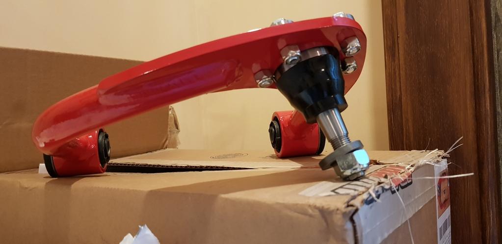

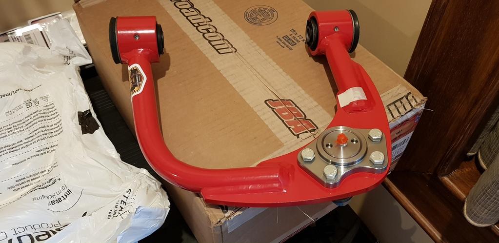

I also think uniball UCA's are overkill unless you have your 4 wheels above ground more than on it. Extra squeaks and needs maintenance, no thanks.. Hence why I went with JBA balljoint UCAs. No issues yet and quiet as stock:

quality welds. tubing that looks like it was notched correctly. etc.
Copy that. Guess I'll find out; they had a sale going so for the price I figured I'd give them a go. They might not be an Icon but hopefully they'll work out and not require any maintenance or make any noise. We'll see what I get.

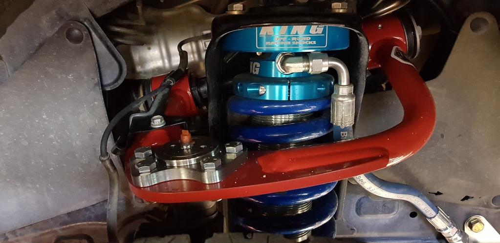

Ive had these on for about 6 months now with zero complaints:
Daily driver, but they've seen their fair share of trail time. Ive added the top dust caps since that pic as well.
How often are you having to maintain the bushings? What type of bushings are they. I ask because I have to grease the heck out of my TC bushings and it’s getting annoying.

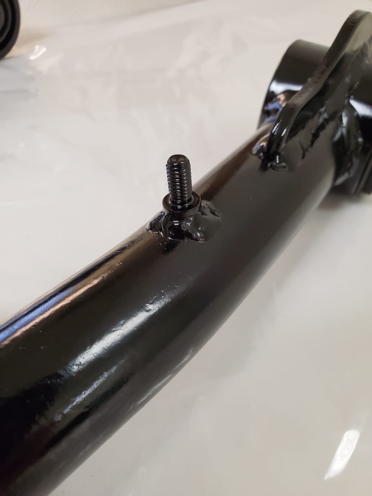

Hey Dobinson Mike what is the story on attaching the abs wire on your UCA's I see a zip tie holding his on???
They first came with a welded tab, and the abs wire bracket was supposed to be bolted on, but some were just using zip ties.
It comes with a stud welded onto the arm now, so the bracket that holds the abs wire goes onto that stud.
