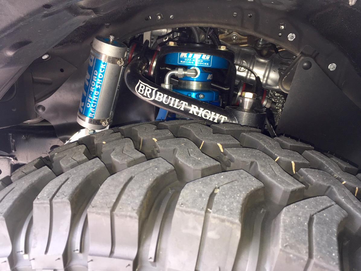

I just went with these, after researching untill my eyeballs fell out.
