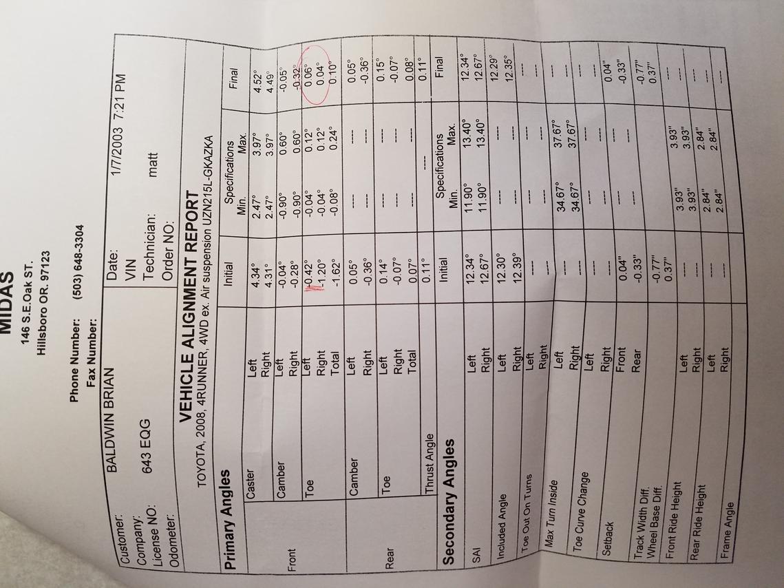

JBA is a ball joint design
It's greaseable and the BJ is available anywhere. From a 1/2 ton GM pickup. I was able to get great caster numbers with mine (about 3.5 deg), important if you are lifting!
