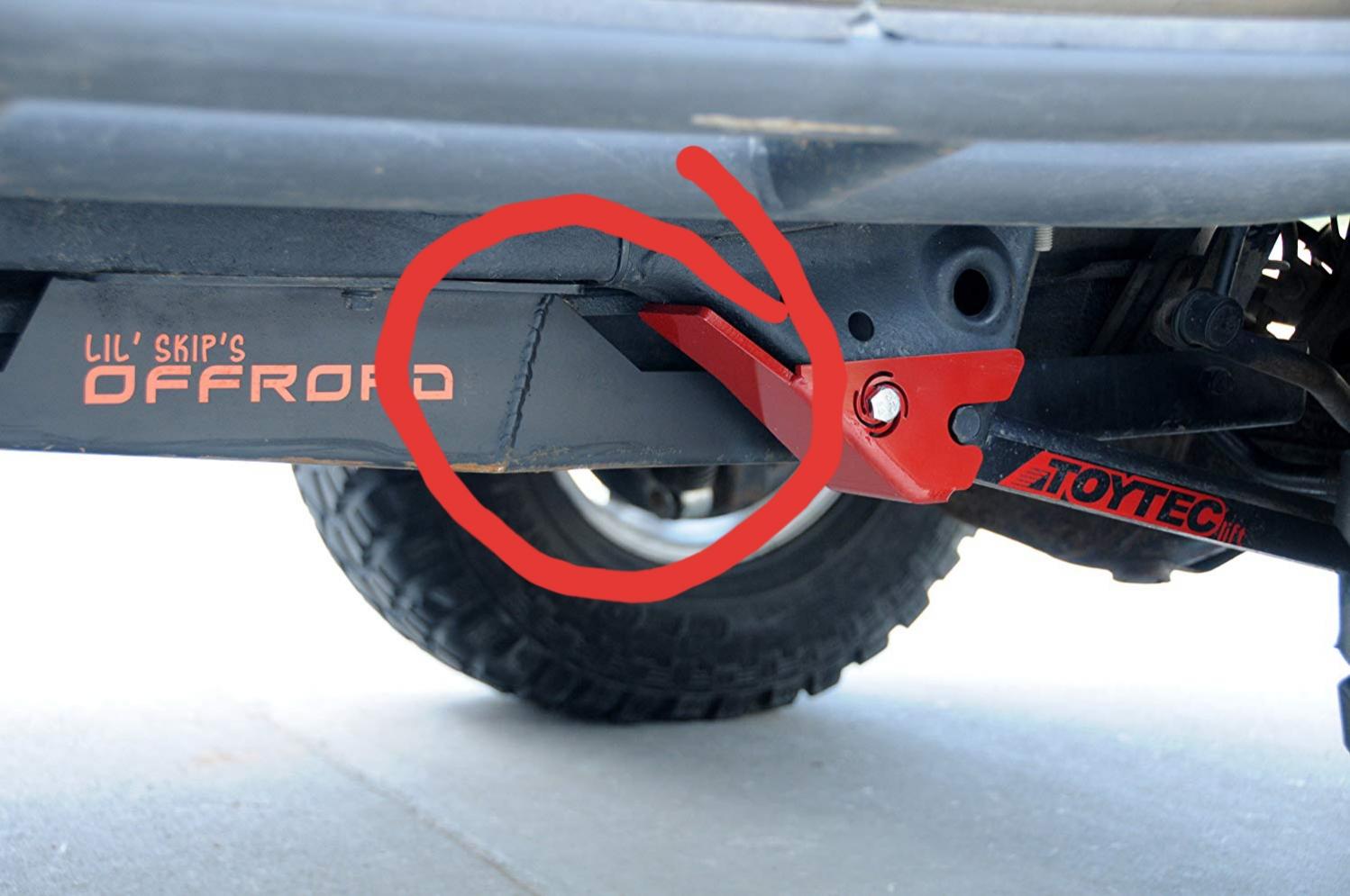

Does the lower bracket interfere with lil gas skip?
I don't know, but I don't see how it could... (I've never run an aftermarket tanks skid, and I'd already relocated my tank when I made these.) - perhaps [MENTION=146407]Plastics guy[/MENTION] or [MENTION=143526]theesotericone[/MENTION] could get a photo of the clearance between tank and LLS when convenient?
Here is mine, did the driver side. The harder side first. Have to drop the gas tank. But its easy if the bolts are not rusted. And if you have a lift+transmission jack. I got mine powder coated first. It was cheap, lets me know that the backside that is against the factory metal will be 100% painted after welding.
I trimmed a little bit of it to make it fit better, also where my rock slider is mounted i had to trim that little area. Maybe include longer bolts with the purchase of these items for future?
