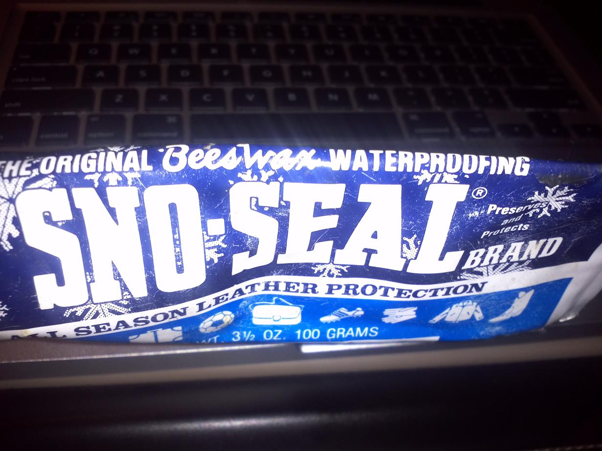

Another absolutely fantastic leather product is SnowSeal.
Its natural made from beeswax and the company has been around since 1933.
It will darken leather so its best for Black leather and will de-suede suede leather.
It preserves, moistens and waterproofs leather.

As for the post above, I find that Mink Oil is softer and contains more conditioners. SnoSeal is more of a waterproofer, and I prefer it on my boots.
After applying the mink oil over and over, it still just sinks in, dries up and the steering wheel feels rough again. I gave up and tried Snoseal and that worked great! The leather stayed soft. I'm in a hot, dry climate. I think the mink oil must be water based and the Snoseal is wax based. It certainly lasts longer. So to revise my initial post, go with Snoseal!
