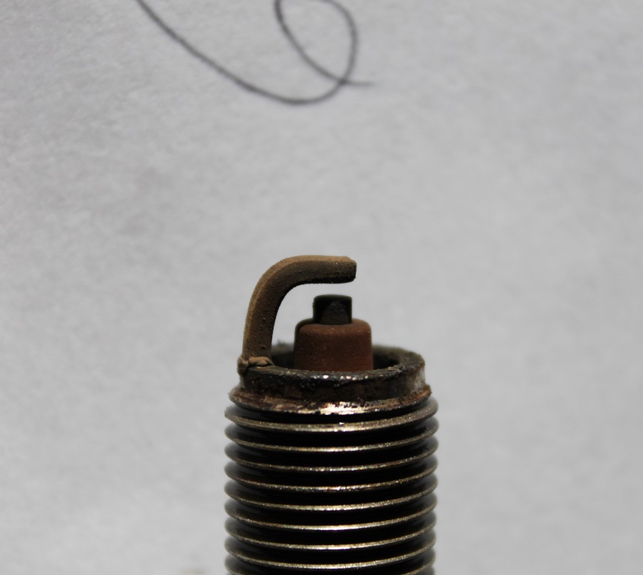

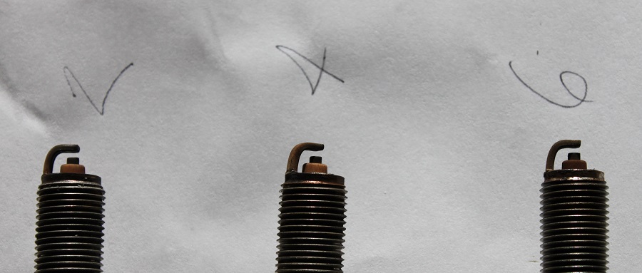

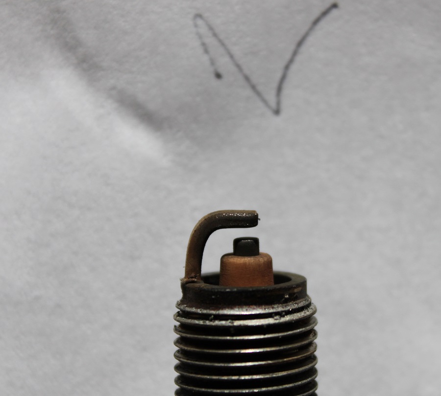

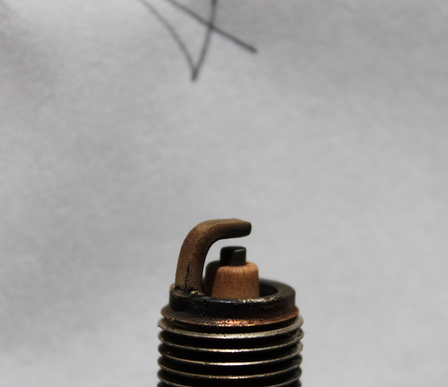

The mythical pictures I was talking about.
Going to try and pull them this week sometime and see what 70k looks like...just for the heck of it.
2 and 4 looked like 1/3/5.
#6 is the dirty one.
Here is what mine looked like at 43k.
