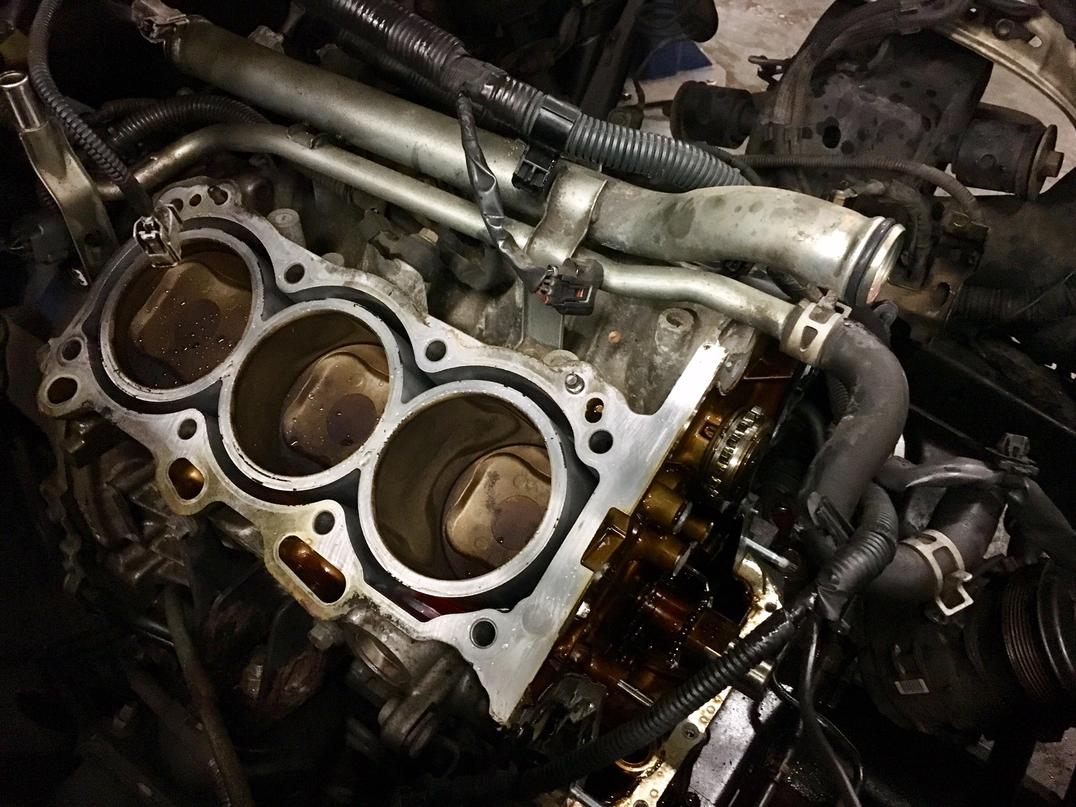

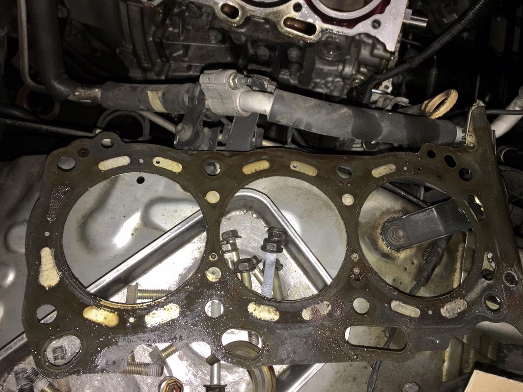

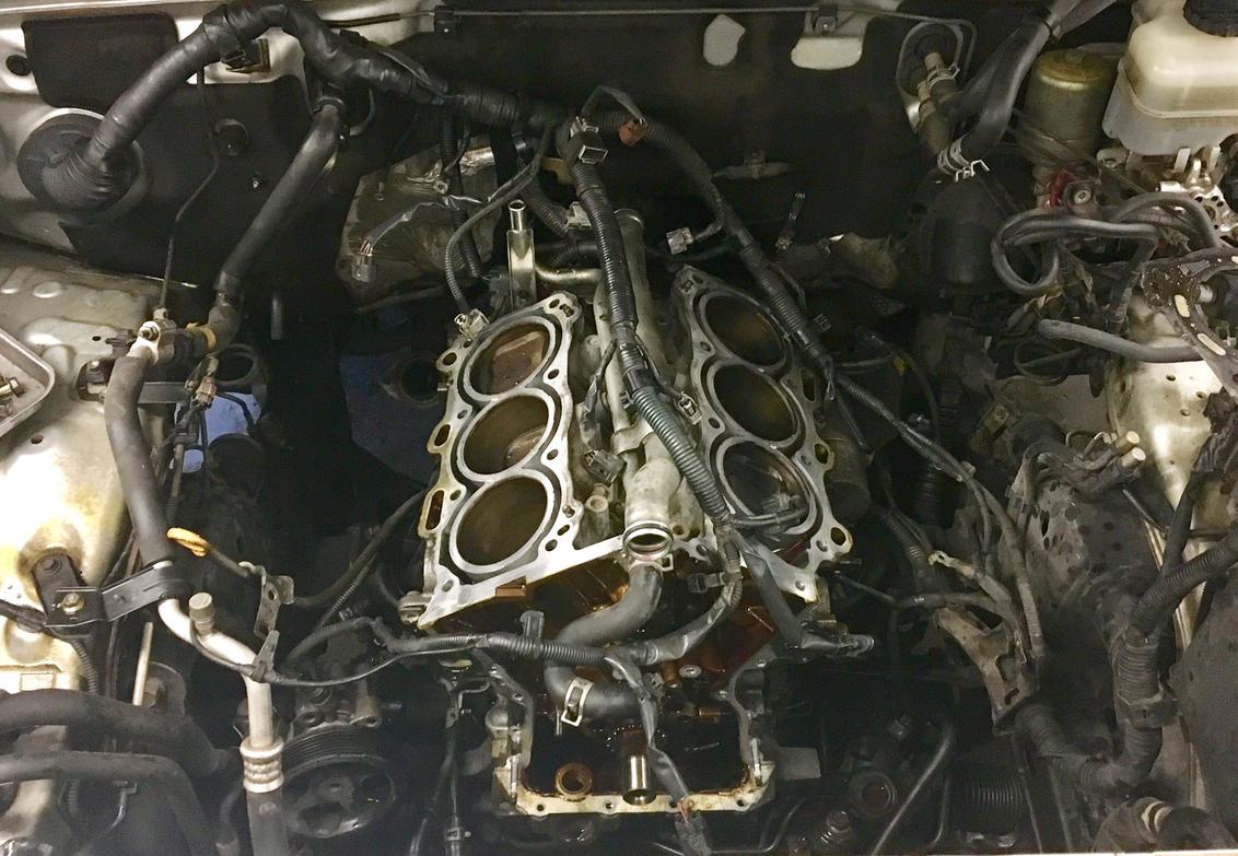

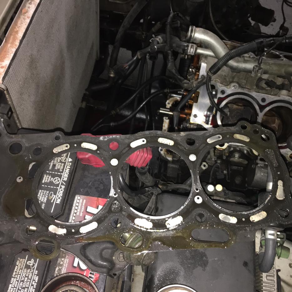

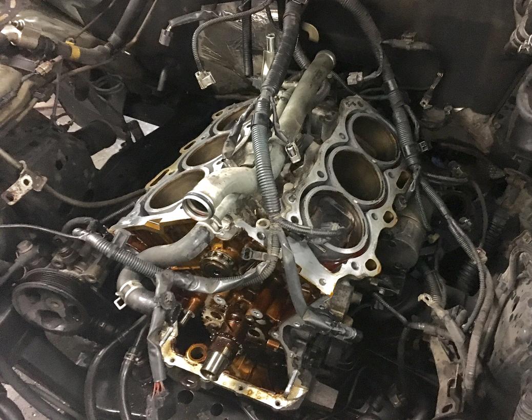

Just checking in after finishing the replacement of both Head gaskets. I did not end up pulling the engine. I debating pulling the radiator, but left it in the car as I did not want to have to deal with the ATF. I also left the exhaust manifolds in place, just unbolted them from the head. Job went smoothly, and I spend a total of 24 hours over the course of two weeks. The longest part was waiting for a couple parts from Toyota and waiting for machining. The crank Timing mark was not super clear, and this is why I can see pulling the engine, it was rather difficult to find.
Machine shop found that the head was twisted by 0.003" on the side where the #6 cylinder blew.
In total I spent just under $1000 on everything, which is not bad considering I was originally quoted $4700 from my local dealer to have the job done.

Very similar to what we went through with mine. About the same cost and slightly less time. We didn't take out the radiator or manifolds either, didn't see a need to.

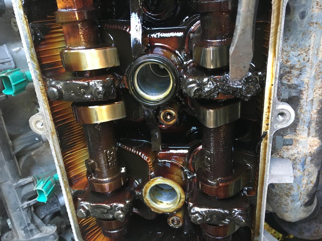

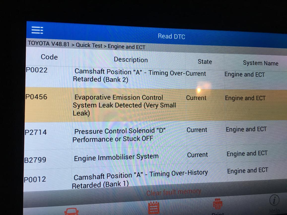

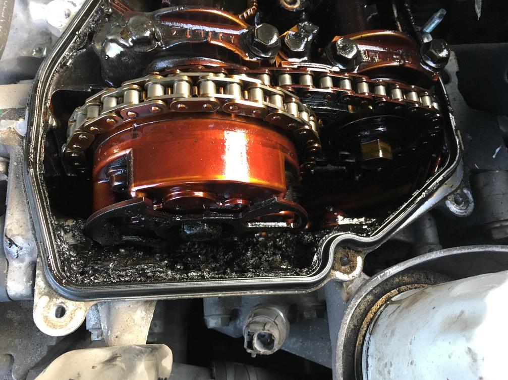

Hey I'm new here, I couldn't make a new thread due to being new. I'm Gabriel from Florida. I post some pics and a link of video at YouTube. Trying to get some insight opinions from experienced mechanic or went through experiences.
Those are the codes I pulled up, I'm deaf myself, hearing people are telling me that it sounds like a rod knock when it was running. I drained oil to inspect for metal shaving, which I found none.
Removed valve covers and I found heavy amount of sludges. So I hope that it was what causing the noise, that resemblance rod knock. I cranked the crankshaft with hand, it cranks smoothly without making any binds.
I have a few options on what I should do.. I'm going to continue and drop oil pan to inspect further for metal shaving in the pan. ( if it is not spun bearing, I think heavy cleaning with seafoam and atf, clean oilpump pick up) restart engine and see or just swap out and buy a used engine?

I hate to say it, but it does sound like rod knock even when you give it some gas.
Try a compression test and if you still wanna go the cleaning route I would pull the timing cover apart too.
I didn't see the pics.... you have a serious sludge issue, If it were me I would definitely pull the engine apart to see if there still hope.

These motors don't fail in the normal way other motors have.
These seem to slowly blow out the HG around the cylinder and leak into that failed cylinder...no oil in coolant. You just loose coolant out the exhaust as it is forced into the, usually #6 cylinder.
4th gen dont seem to just blow out like the old 2nd gens did. Not as catastrophic.

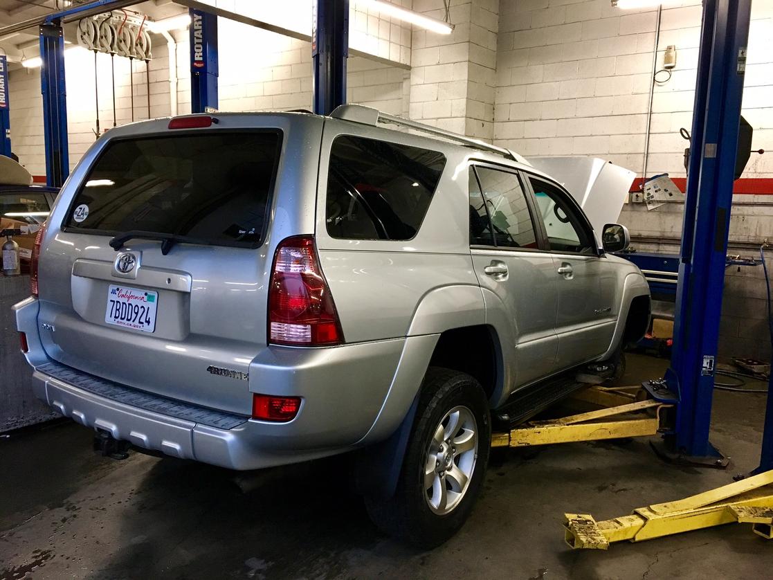

Update 2:
Dealer revised estimate to $3,000
Toyota offered $1,000
So I'll be $2,000 out of pocket, but the car has enough sentimental value to approve the repair :-)

Update 3
Job in process. Looking forward to many more miles of smiles in old faithful.
