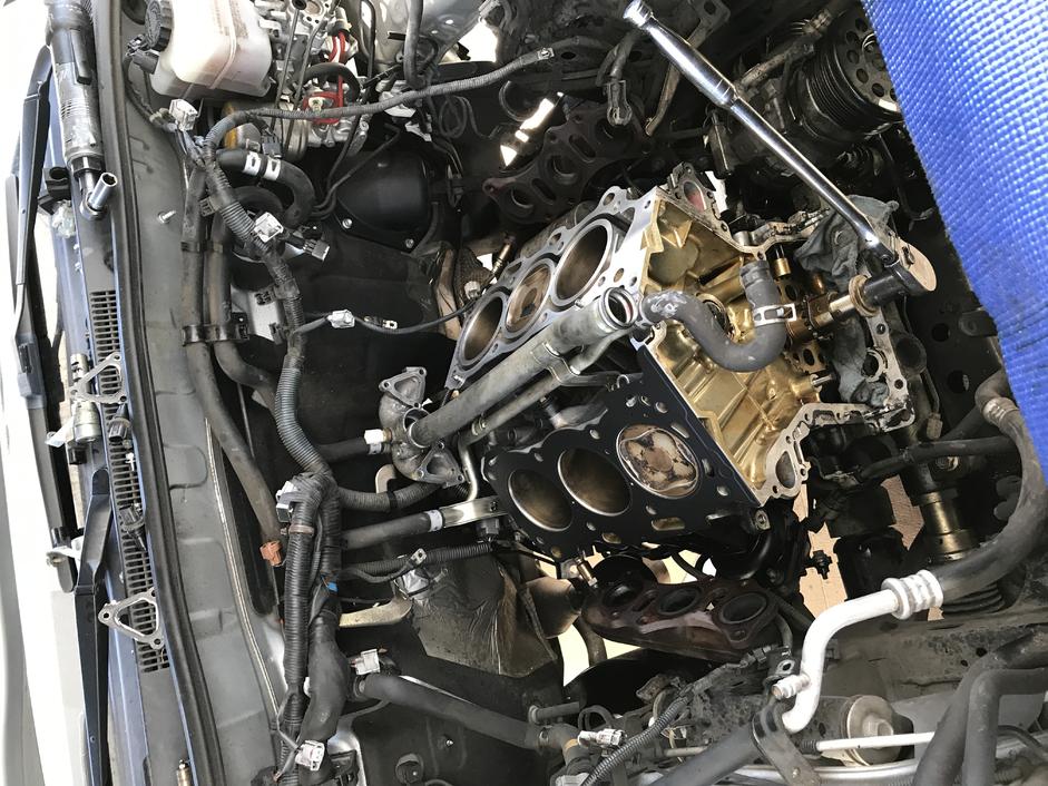

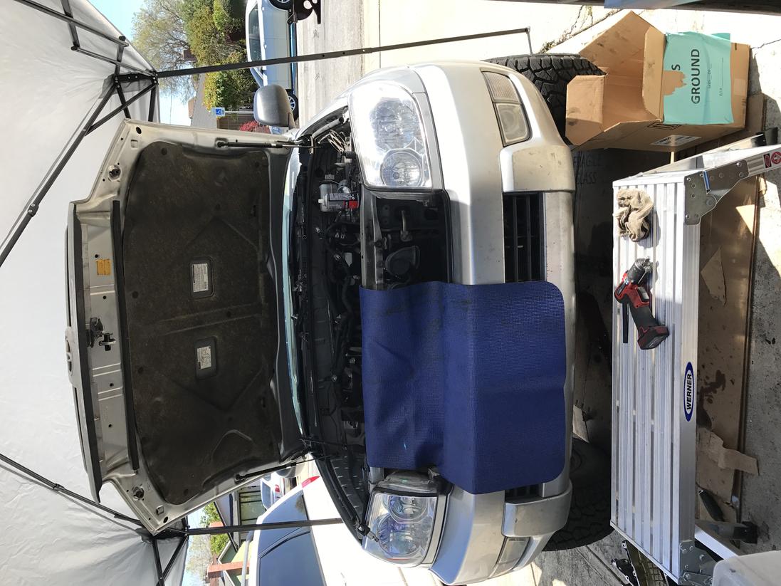

05 v6 160k p0304
Spent my weekend doing my head gasket fml.
2006
4x4 Sport
230k
Head gasket Failure, misfires on 3 and 4. It would run rough starting cold, but I could always turn it off then back on again and it would run fine so I ran it that way for about a year (stupid). Salvage engine was cheaper route, found Toyota master tech to do the job for $800. 10k on salvage motor so far, runs great.
Nice1 So how many hours did it run you? did you have to mill the heads?
I spent total of 17 hrs, i didn't send out the head because it checked out good with the straight edge. I also didn't have to drop the oil pan. Part of the 17 hrs I spent running back and forth Toyota to pick up some seals that was missing in my set. Keep in mind that I do this for living so all my knowledge helps a lot.
