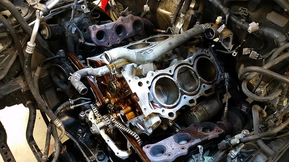

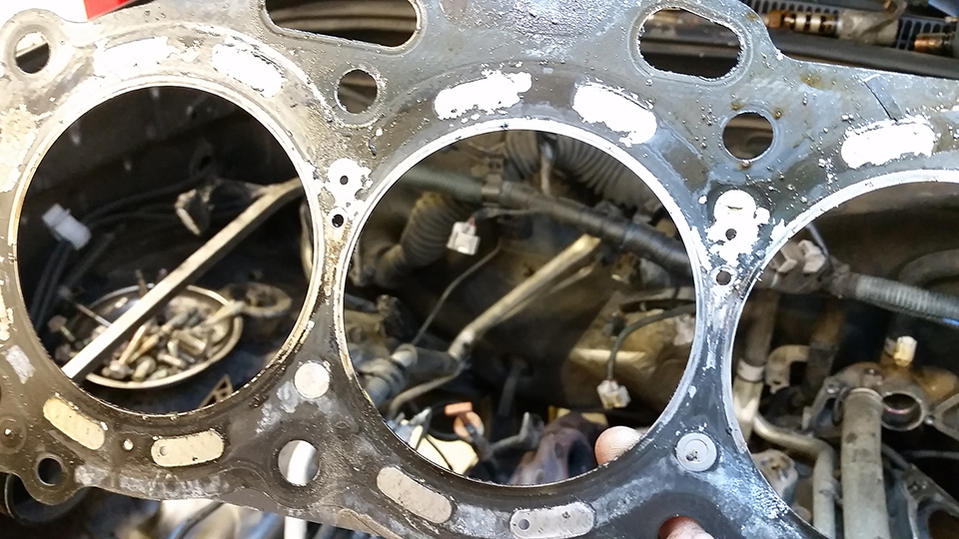

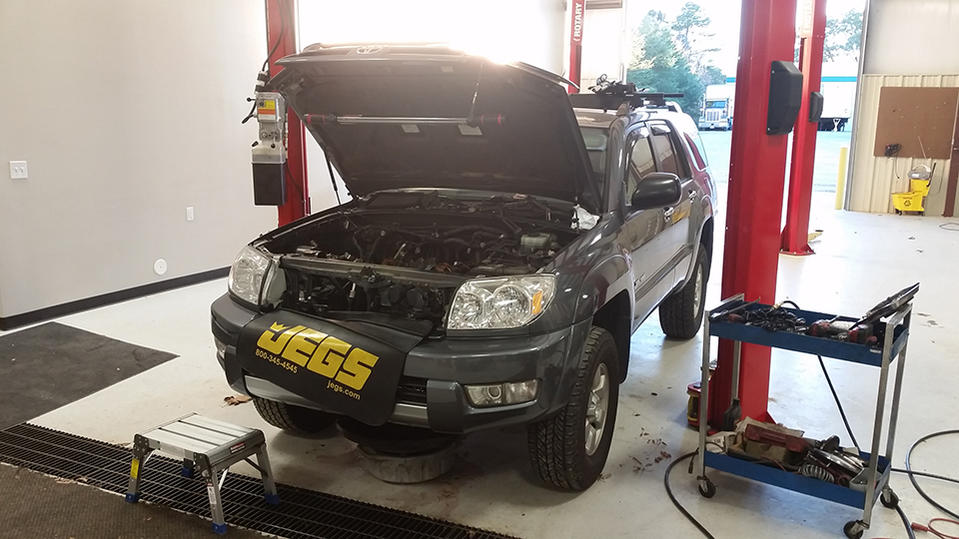

made it to 12/16/2015 & 217k before head gasket started leaking
leaks between driver side cylinders 2, 4 & 6
ran fine, but overheated quickly on idle
