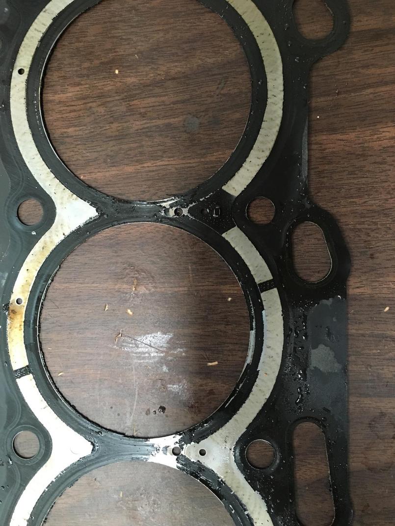

2004 Limited, V6
4X4
146,000 miles
#6 cylinder
Same symptoms, started with a P0306 #6 cylinder misfire code and VSC lights. The truck would shake upon startup then run fine. Immediately took to my mechanic. Replaced spark plugs, pcv valve, and coil. Ran fine for 2 days and same symptoms returned. Back to mechanic and they scoped the cylinder and found coolant. Returned vehicle to the dealership where it was purchased so I could file a claim on the extended warranty that still had 5 months or 3,100 mile left on it. I purchased the vehicle with 113,000 miles. The dealership kept it for 3 days before they correctly diagnosed it as the same as my regular mechanic, a blown head gasket. They also pointed out that the warranty has a "*" next to "gaskets and seals" indicating they are not covered under warranty if the car had >100,000 when purchased. That was on page 6 of the contract. My next email is to the person who sold me that piece of junk. Enough of my rant.
I am now in the middle of the repair with a local mechanic. Confirmed gasket was blown and heads were warped. Looks like it was about to leak at the #4 also. Since it is a 4X4, had to remove engine for the repair. One of the guides to the timing chain is also broke, so replacing the timing chain assembly and water pump while we are in there. I'm now upwards of a $4,700 repair. I love the truck, but this is a hard one to swallow. I hope I can get another 150,000 + miles after the repair.
I'm new to the forum but its been extremely helpful to me with diagnosing and moving forward with the repair.

I took the truck to the mechanic immediately after the first signs of shaking. No signs before that. No obvious coolant loss. I had them change the oil at the same time they changed the plugs and the mechanic didn't mention anything out of the ordinary like it being milky. As you can see from the picture, the leak was small, where the black is missing. I think I caught it early so I didn't put many miles on it while it was leaking.
