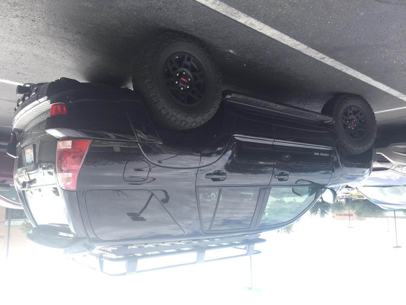

Alright fellas, need a little input here... My mpg is unreasonably bad as of recently. Let me tell you what I've got. 2005 4runner V8 4x4 LTD with 92k miles. FJ springs and 5,100's BFG A/T 285/70/17 and an ARB roof rack and K&N drop in, HCF delete. I'm getting less than 13mpg combined. Yes, manually calculated at 21 gallons pumped with 270ish miles out of a tank. THATS 12.8!!!
It seems that immediately after I dropped in the K&N and deleted the HCF, it all went bad. Are my tires really that heavy? Could overoiling the filter give me a problem? The HFC delete? Roof rack? Please give your opinion or advise, thanks so much. Sorry for the giant upside down photo, not sure how to fix this IMG_9360.jpg
You need to start driving right side up or we can't help you out. :rofl:
