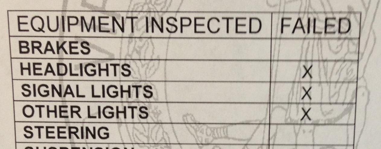

So I've had Digital HIDs (55w / 4300k) low beams with Toshiba HIR highs in the stock 2007 headlight assemblies since 2009. I've passed state inspections in RI (2010-2011) and VA (2011-2012) without issue.
As a matter of fact, I returned to the same dealership that I went to last year for my inspection. As bulbs have needed replacing (front side markers, rear license plate lamps, etc I've replaced them with with LEDs from VLEDs keeping with standard colors and using 5000k whites. I recently splurged and installed the amber/white switchback V3 Tritons in the DRL/front turn signals (they looked great and were working as intended). Anyway, today they tell me my rig passed in all areas except for HID Low Beams, LED Front Markers, LED Front Turn Signals, LED Backup Bulbs, and LED License Plate Lamps.
The tech said the state is cracking down on non-DOT approved bulbs and he doesn't want to get in trouble. So I got a big fat REJECTED sticker and have to go back once I've replaced all the bulbs. My gut tells me that I probably would have passed had I gone to a generic garage, but I won't know until next year.
Anyway, I just wanted to caution any Virginians on here.

I swapped out the bulbs in question. After 5 yrs of HIDs I can't believe that the man thinks its safer to use halogens in those projectors...
Anyway, I'll get re-inspected tomorrow and then replace my HIDs and V3's this weekend.

I was informed by the tech that all bulbs had to clearly denote DOT or SAE approved for the lamp it is in. As I recall, the law merely says lights must "approved," leaving by whom the approval is given up to interpretation. It's the same laws that say front side markers are not required but if one bulb is out you fail (they require all bulbs work or in the case of lights that are not required, that the bulbs and sockets be removed from the lamp).
Anyway, on the bright side the dealership didn't even charge me for the inspection or the re-inspection (go figure). I now have my inspection sticker and appear to be legitimate again until this time next year...
