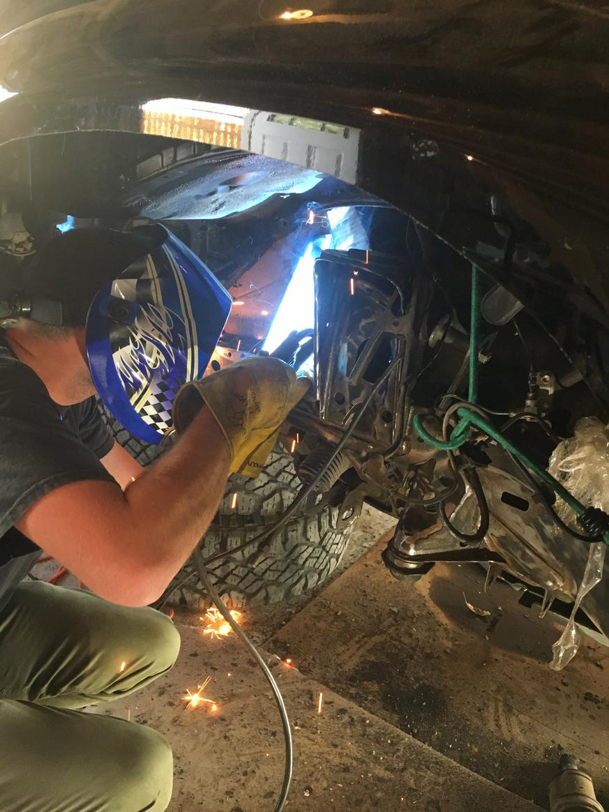

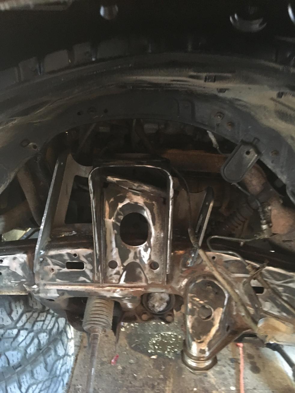

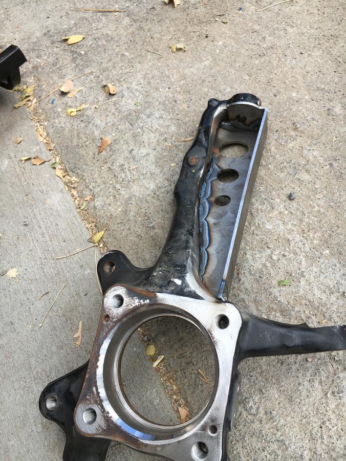

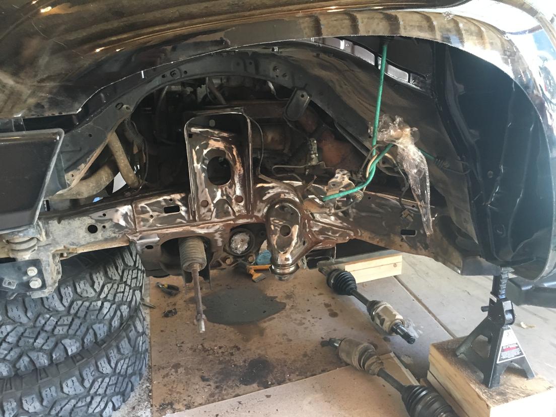

Starting the disassembling tomorrow. Hopefully get 70% of the welding done this weekend...I know its ambitious but hopefully. Will definitely take tons of photos, incredibly excited. Still no idea on when the custom Kings will ship yet but fingers crossed it will be by today or tomorrow (tomorrow is 3 weeks since the order went in) Welding the lower cam tabs, spindle gussets, bucket tower gussets, and hopefully the front diff mount arms. Going to be a busy weekend that's for sure!!

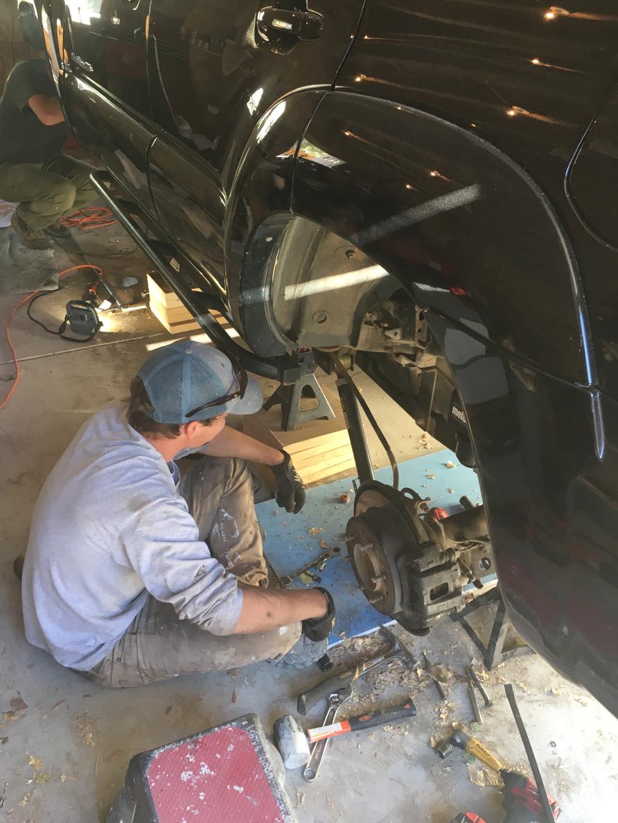

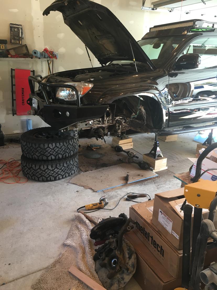

So here are some progress shots. Been a long two days, bucket tower gussets are on, ground down all of my wonderful surface rust. Got 95% of the rear suspension off thanks:tellurunner: Still have one shock that will not come off the dang lower shock mount. If anyone knows what to do please let me know. Tried everything and no luck. Hoping to get the tabs and other bucket done tomorrow. Been great having 2 others to help. Definitely had a few moments that were tough. Broke the wheel speed sensor, front lower shock bolts were seized (after 2 years), mounted the metal tech links backwards a few times, and that one damn shock won't come off in the back. Work in progress thats for sure!

So today was decent progress. All bucket tower gussets done, and lower control tabs installed. Got the rear shock off. Wasn't an easy process that is for sure. All I can say is use as much as possible antiseize. Hit one issue when extending the axles, you have to have stock axles or OEM. The rock auto ones won't work with the TC axles...luckily i had one spare but am in desperate need of a OEM one. So if anyone is in the denver area and has an extra that they are willing to part with please let me know! I have a cardone rock auto one with heavy duty boots that only has 20k on it that I can trade with ya.
