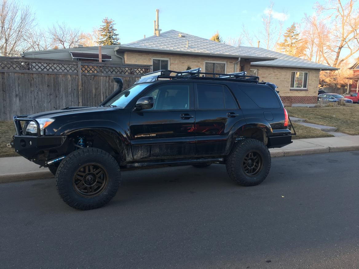

Here they are! Still have a few kinks to work out with them but overall pretty happy with it!

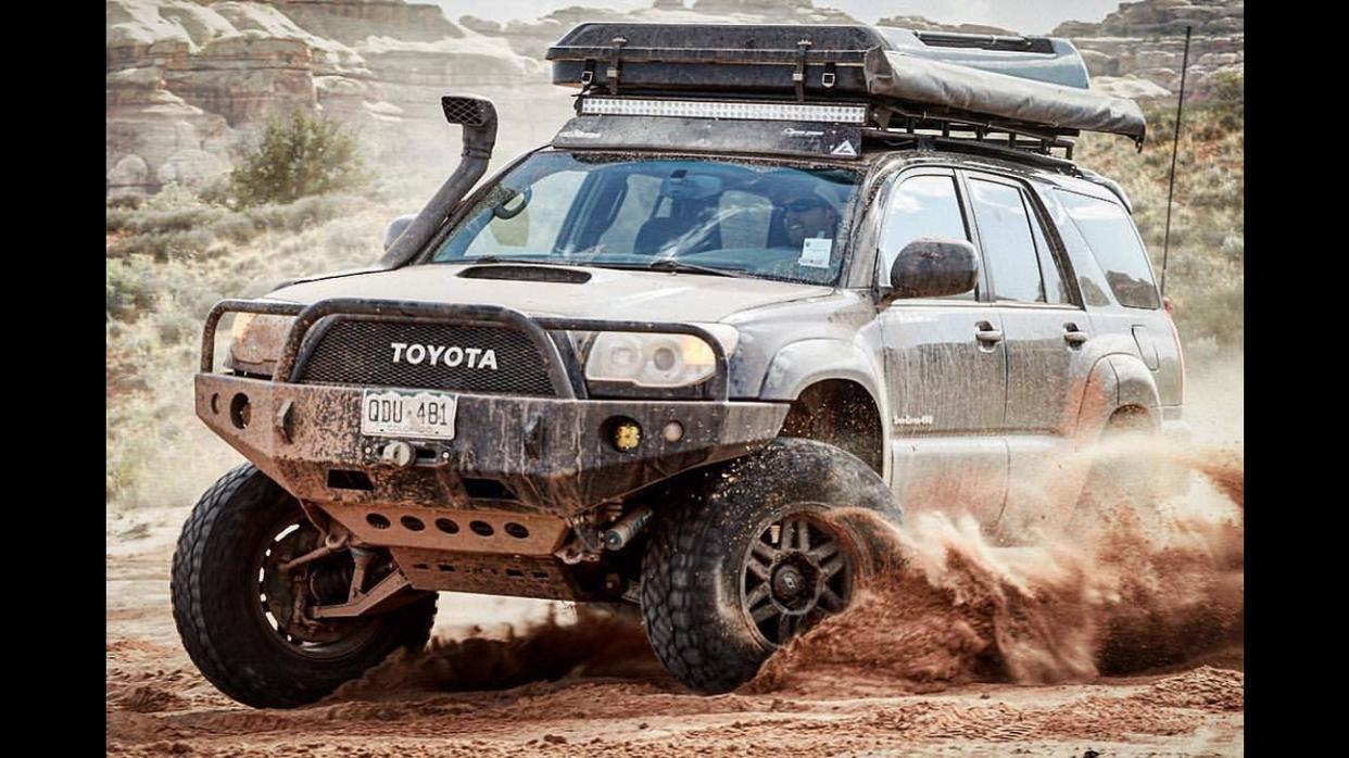

Damn!!! Looking good. Those 285/75's are looking beefy. I think I'm going the Falken route in that size.
Bumper is looking great.
Is the front higher then the back suspension? Looks like theres a bit of a prerunner lean - but that thing is looking huge!
Love to see in person.
Awesome!!! Definitely worth the wait. Those 285s look perfect with your setup. I'd be curious to know how the LT setup is treating you on the road after you've got some miles on it. I have considered going mod crazy with mine at some point but the more miles I get, the harder I have justifying the costs. Haha
Funny you say that about the lean. Been trying to get that sorted. The 700lb coils from KING really lift the front. Might try and crank them back down some more or look at custom rear springs.
It looks from the pics you can lower then down 1/4 of thread, which should be 1/2 inch of height. In the rear, are you running the HD version of the MT LT kit?
MT actually doesn't offer this anymore. They just offer the one dual rate spring for their long travel kit. The KING Coilovers just gave me alot of lift and yea still have some more to drop if I want! Might try adding those OME yellow spacers in it eventually.

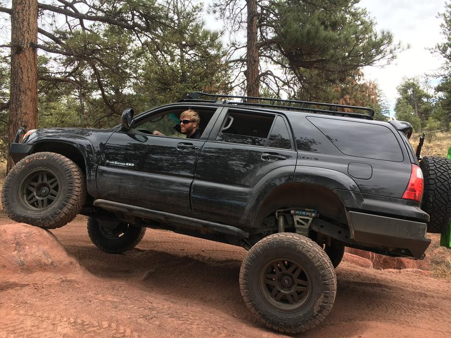

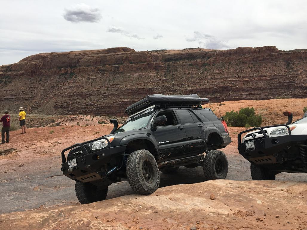

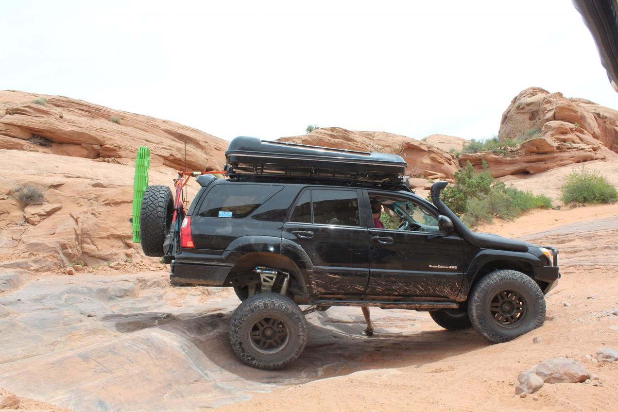

Well I finally got to get her out and do some flexing! Great day on the trail!
Went up to Rainbow Falls out near Colorado Springs. Really fun trail with some fun side obstacles!
Thanks for the input! I ended up going with the OEM Kings with 10" rear shocks. I only have an additional 200#'s of weight in the front which I mentioned when ordering. Hopefully this will be the perfect setup. Now the waiting game begins...

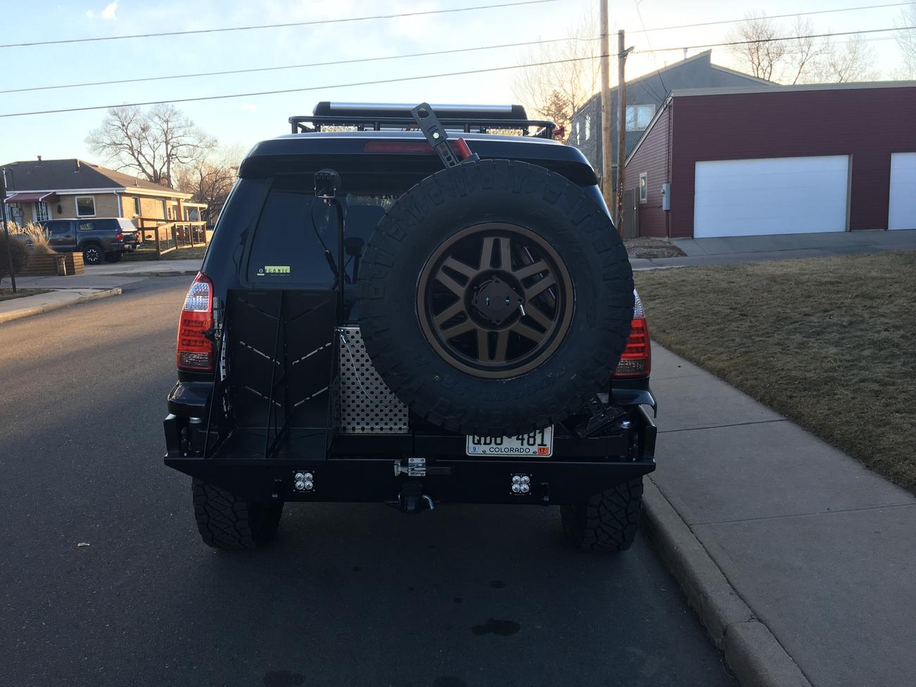

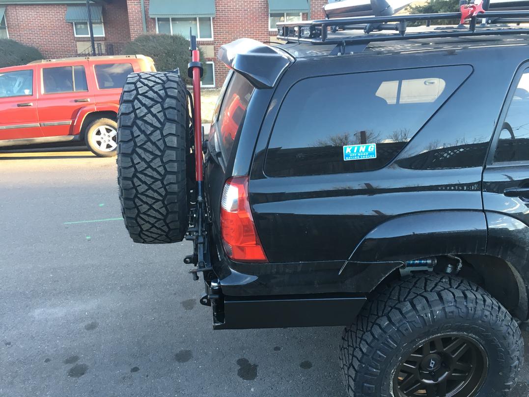

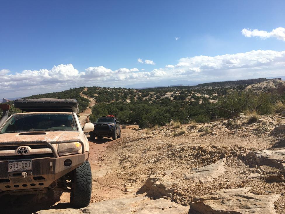

Sorry for the wait! Been getting life sorted for way too long. I’ve been on a bunch of trips lately. Here are a few highlights. Also a few updates on the truck: been a process getting the long travel to ride right. Learned my lesson with all the suspension work. Blue loctite and anti seize are your friends. Lost a bunch of important bolts on my suspension because of the lack of loctite...
Also got a total chaos panhard on the way to hopefully help with the drive shaft rubbing on my gas tank/skid. Truck is finally running better though. Did the mundane maintenance and grease all the zirk fittings (There are a ton!) and reinstalled a bunch of bolts with loctite and antiseize. Great to have the truck feel brand new again!

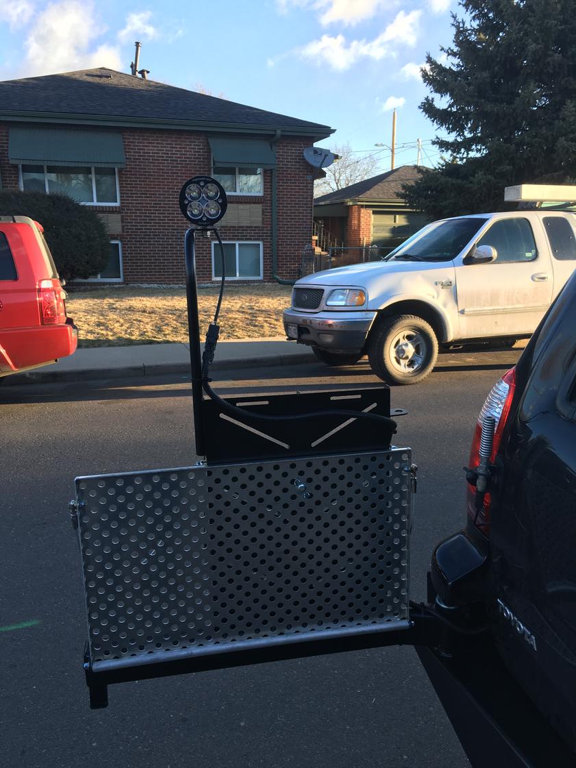

Nice setup! like that rear bumper, it's a shame I don't believe they will ship a finished built rear bumper, so the end user can install themselves. Someone said they only do in-house installs.
