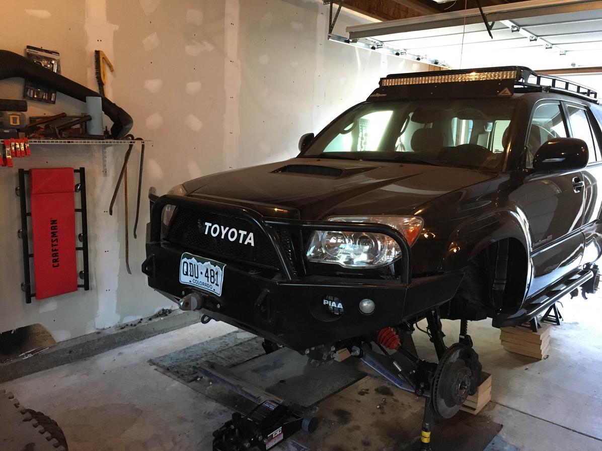

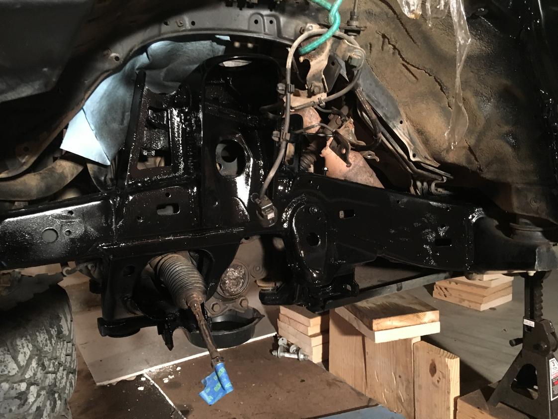

Just an update: Been working on her this past week and got everything ground down and painted up! Man that = 0 fun on the grinding. Rust is not fun.
Got one axle reassembled = super messy job. One more to go. Going to be installing the sexy parts tonight will update the pics on that tomorrow. Still waiting on King, 4 full weeks in, hoping to hear they ship soon...

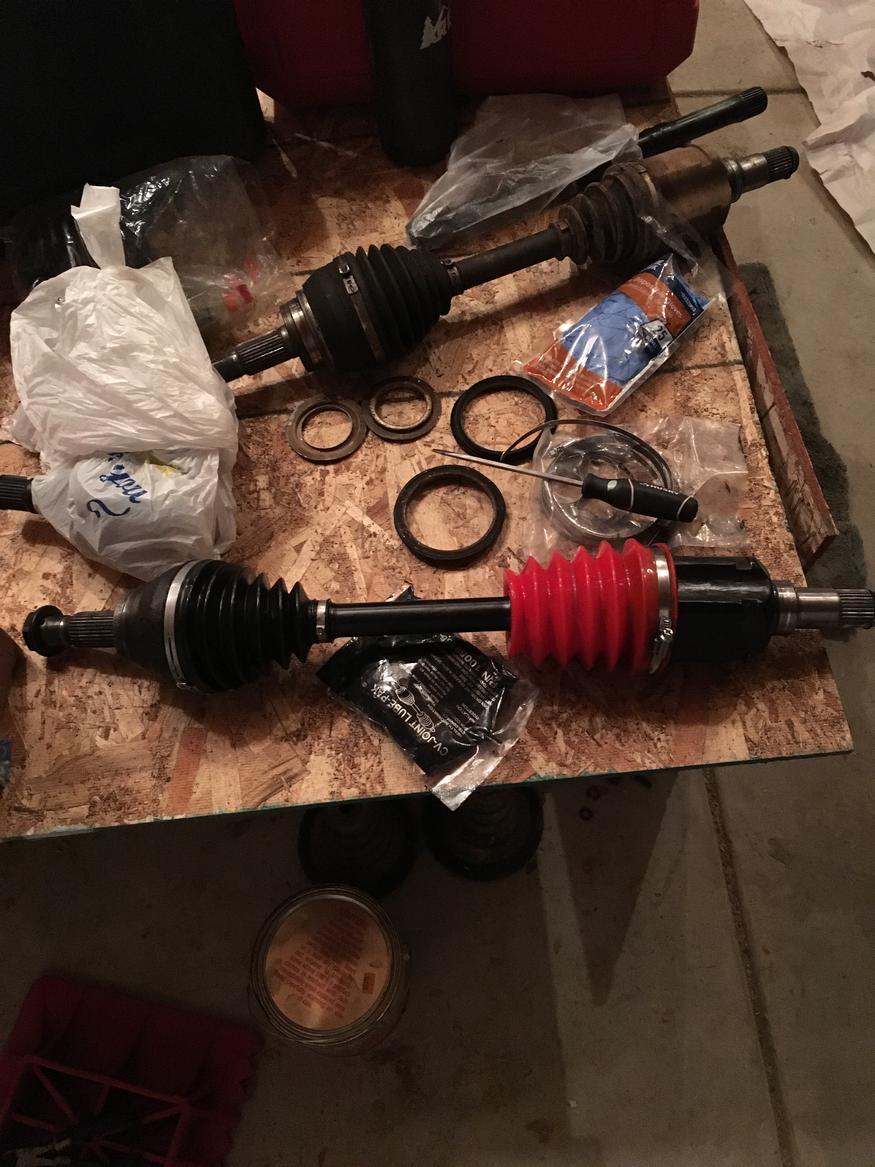

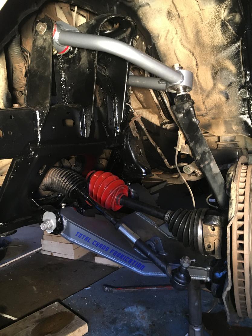

Driver Side Complete
TC 2" Race series Installed. Spindle is gusseted, tower is gusseted, cam tabs are reinforced, 3 coats of enamel paint, stainless steel extended brake lines, extended tie rod end, extended TC axle, CVJ high angle boot, just needs the coilovers :(

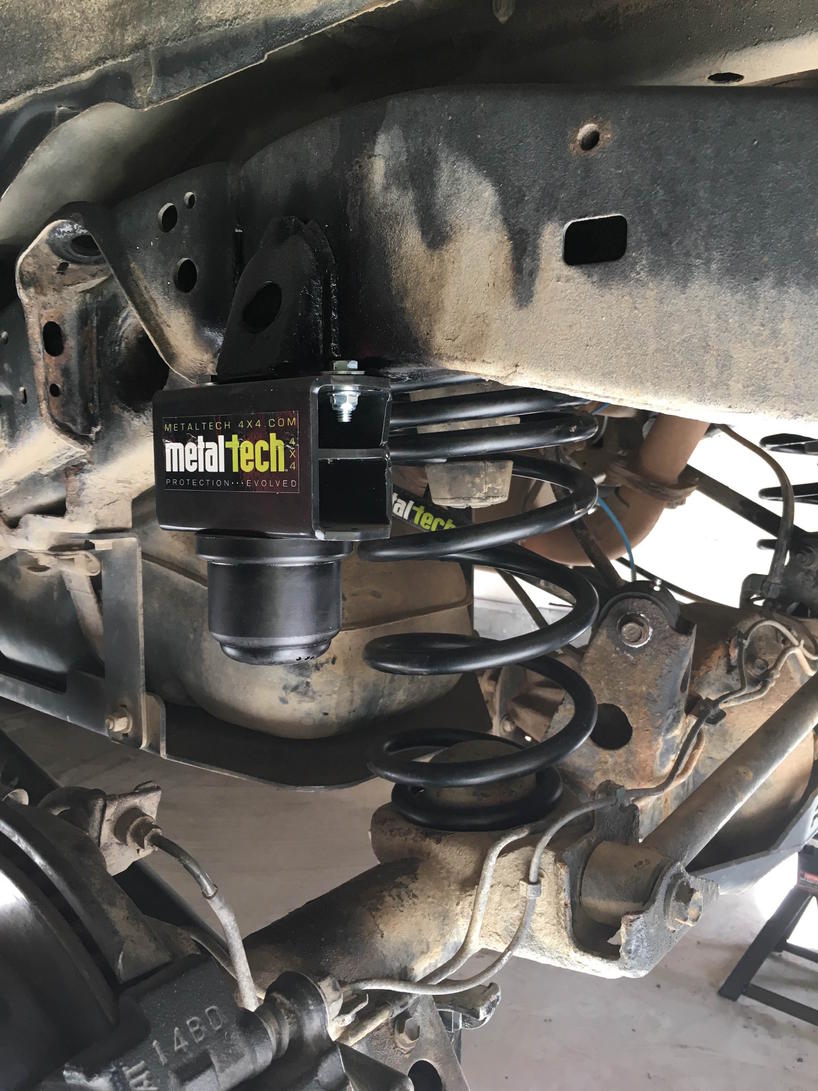

Another update: All TC gear is installed both sides, got the metal tech long travel springs installed too with (2) OME shims on the driver side. Just waiting to get the Kings in! So of course while I'm waiting why not mod some more...Got the satoshi done today and starting the Snorkel install. Hoping to finish the snorkel by Wednesday/Thursday time. Sorry about the photos not having descriptions. Photo bucket has been the absolute worst...

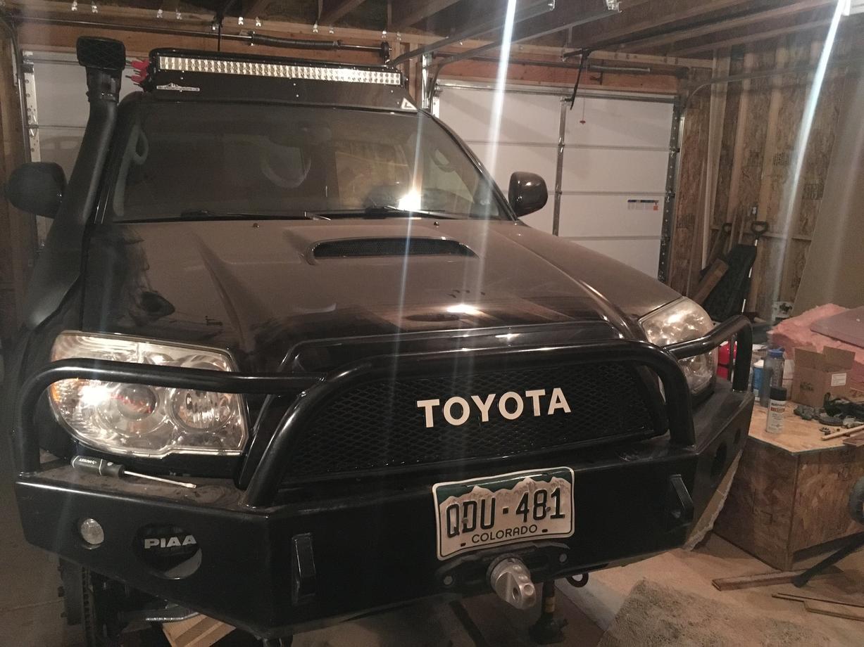

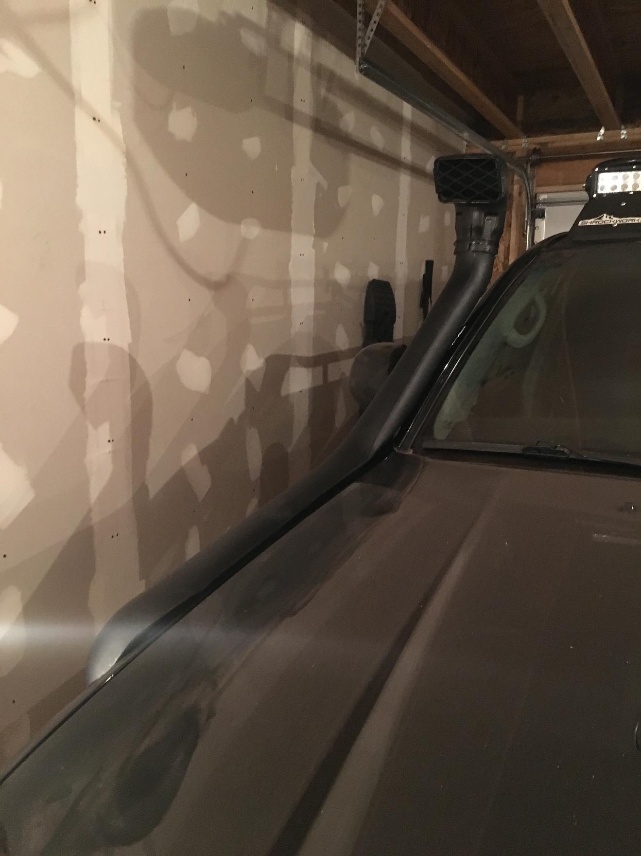

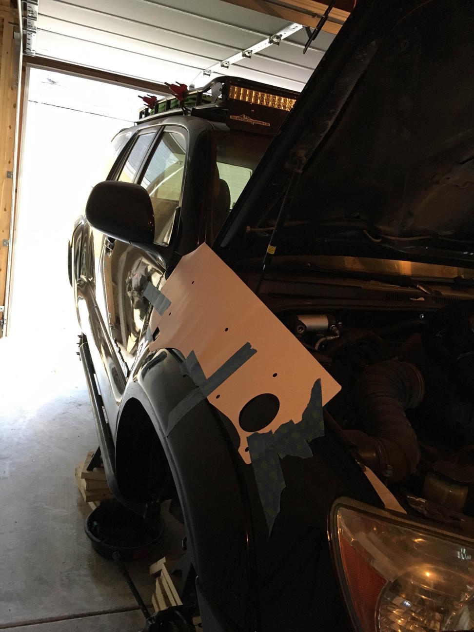

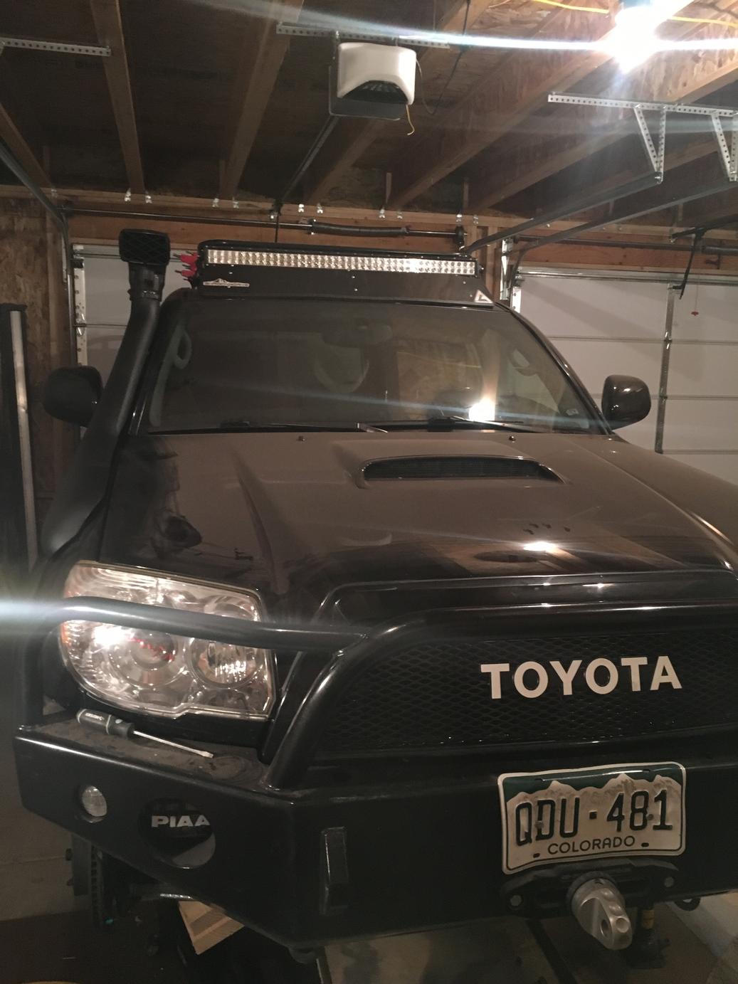

Snorkel

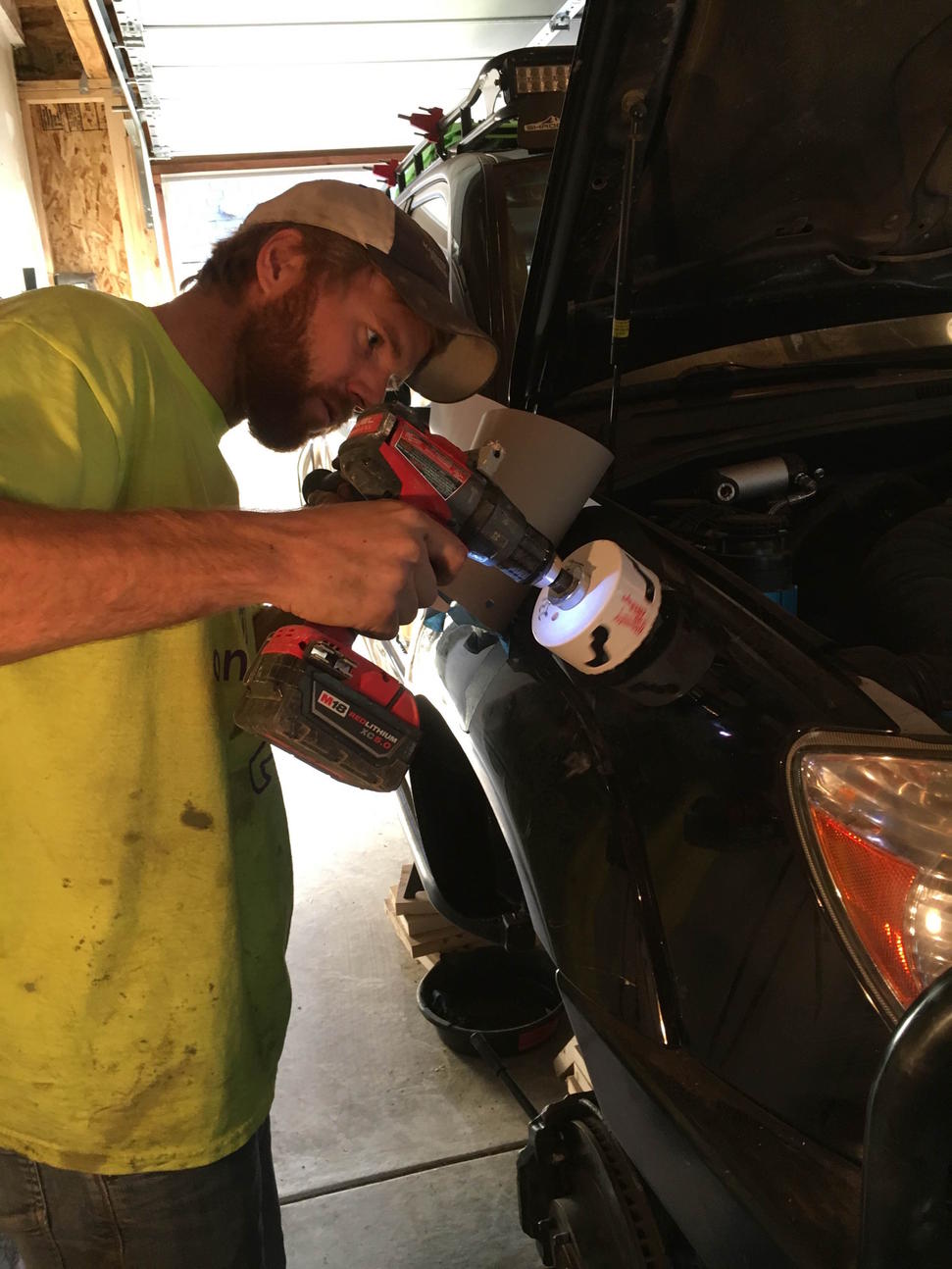

Finally got this thing installed. Must say not the most fun or easiest to visualize. When you hold the thing up to the truck basically looks like there is no chance it will line up with the body. Probably a full weekend of install. Will post the plumbing pics later. Definitely need to hack up the inner fender/engine bay. And go ahead and assume you are removing all of your fender liner. I already had mine removed from the fender trimming for the long travel so at least had that going. Actually kind of the reason I pulled the trigger on the LC80 snorkel plus some instigation from [MENTION=114923]tellurunner[/MENTION]. Somehow I keep getting to be the guinea pig...

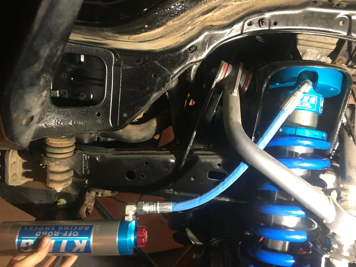

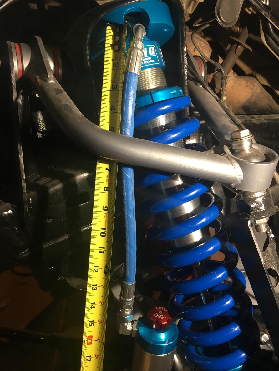

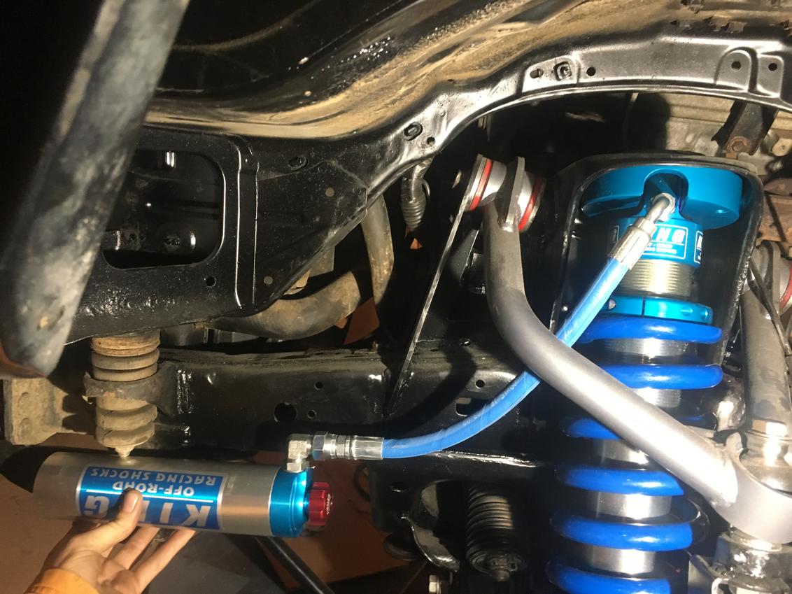

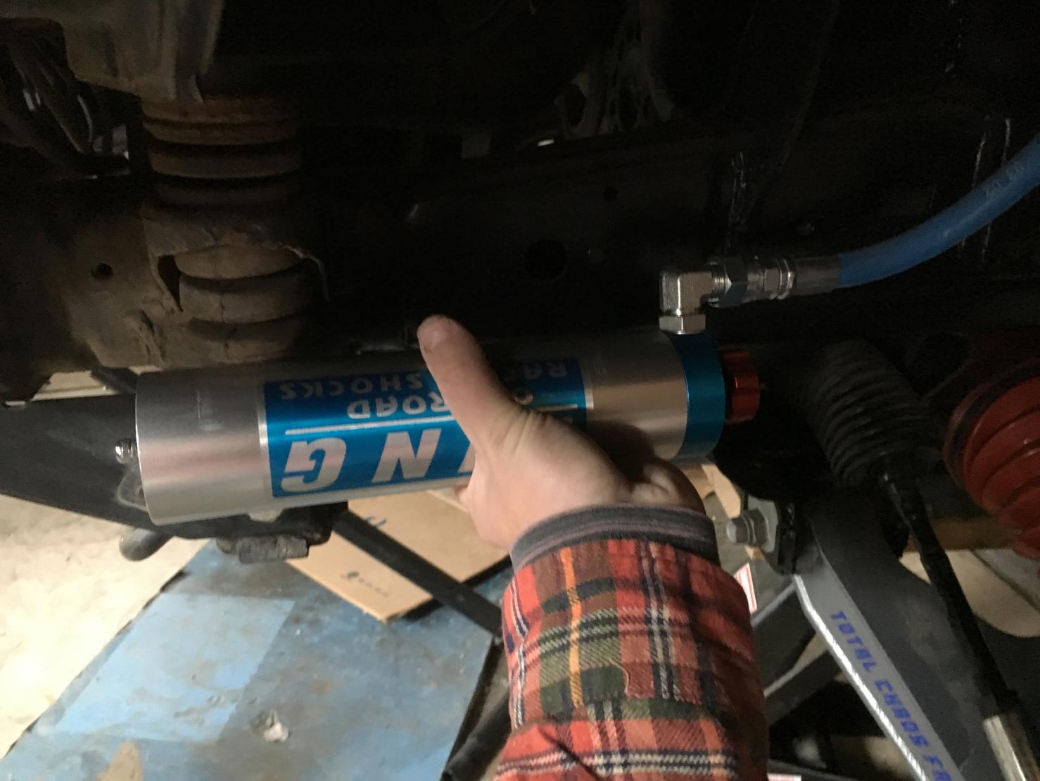

The Kings Arrived!! Rears went on with no problems at all. Fronts are another story, can't find a way to install the reservoirs. Hose length seems to be too long. Anyone have any insight?
Below are a few mock up photos and this is the best we could get out of them.

What kind of bracketry did they give ya? Only pics I can find of long hosed kings with a 90 degree fitting on them run them all the way forward then back like this but that would put your adjuster in a terrible spot. This guy says he relocated his windshield washer for it too.
P1020374Large.jpg~original
LTDSC has short lines with a straight fitting on the end and goes this way so no help there.
60983e1837aaa588728c49b3f9196ec9.jpg~original
Foxes mount vertical with a bracket off the sway bar holes, and some fancy line twisting. Looks like a much shorter line though too.
2c7247a4c8fa4f53b0993ff7bd0466d2.jpg~original
To bad you can't unscrew the fitting at the shock, drill a hole into the back of the shock tower, and run the line out back. (if that wouldn't interfere with the motor and exhaust I guess...)

You may have to make a bracket like Icon's remote reservoir and mount the resi upside down. I would link a pic but my phone is working against me.
Edit: Like this one, rotated a bit further than vertical.
