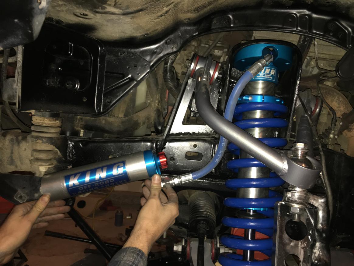

So its been a long day to say the least. Definitely a lot more knowledgeable then where I was last night. Needless to say Total Chaos has some work they need to do for their mid travel 'kit' when using kings with the adjusters on a 4Runner. The spec's that king has from them are incorrect for a 4runner but will work with a Tacoma or FJ. I ended up having to switch the passenger with the driver and vice versa. Then manipulate the fitting at the shock for the resi and rotate it. This helped a lot with gaining clearance around the shock and upper control arm.
The next thing I will need to do is fab up a bracket that can span between the frame and cross member so I can weld the rest mounts to that. Very very frustrating that this is supposed to be a kit...
The other thing that is different on the Kings for the TC kit is you end up with about a 2" larger Resi then the stock OEM Kings. Which = even more of a PIA.
Good news is that I won't be needing to send these back to King. So hopefully have it up and running by next week. Hard to get my buddies that have the welder to keep making these trips to me.
Will try to update with some better photos tomorrow and this weekend. Thanks for all the help guys! Definitely a fickle little guy.
Well I must say this has been a huge huge undertaking. Can't thank [MENTION=114923]tellurunner[/MENTION] and [MENTION=148878]Grateful4Runner[/MENTION] for all the help and the garage for 1.5 months. Still a few hiccups to sort through. Some reason the TC uppers had thermal cracking in the powdercoat so TC is sending me some new ones to replace (just my luck this happens but Total Chaos is a great company and stands behind their product). The weld for one my limiting straps popped off when setting the height for this (really difficult to get a gun in there so might be relocating this in the coming weeks. Other than that extremely excited to see how it does on the trail. Road manners have been pretty amazing considering no sway bars on her.
As far as the resi mount, we ended up using some flat stock to span between the frame and cross member (of course I forgot to take photos) and then welded the resi mounts to that. Turned out pretty great in my opinion.
Definitely some fine tuning left to do but at least she is out of the garage now!

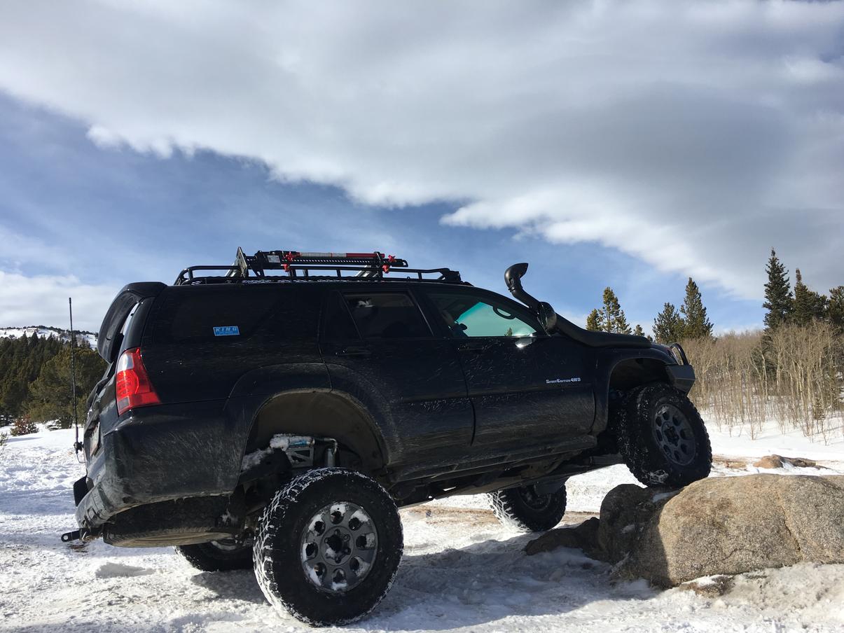

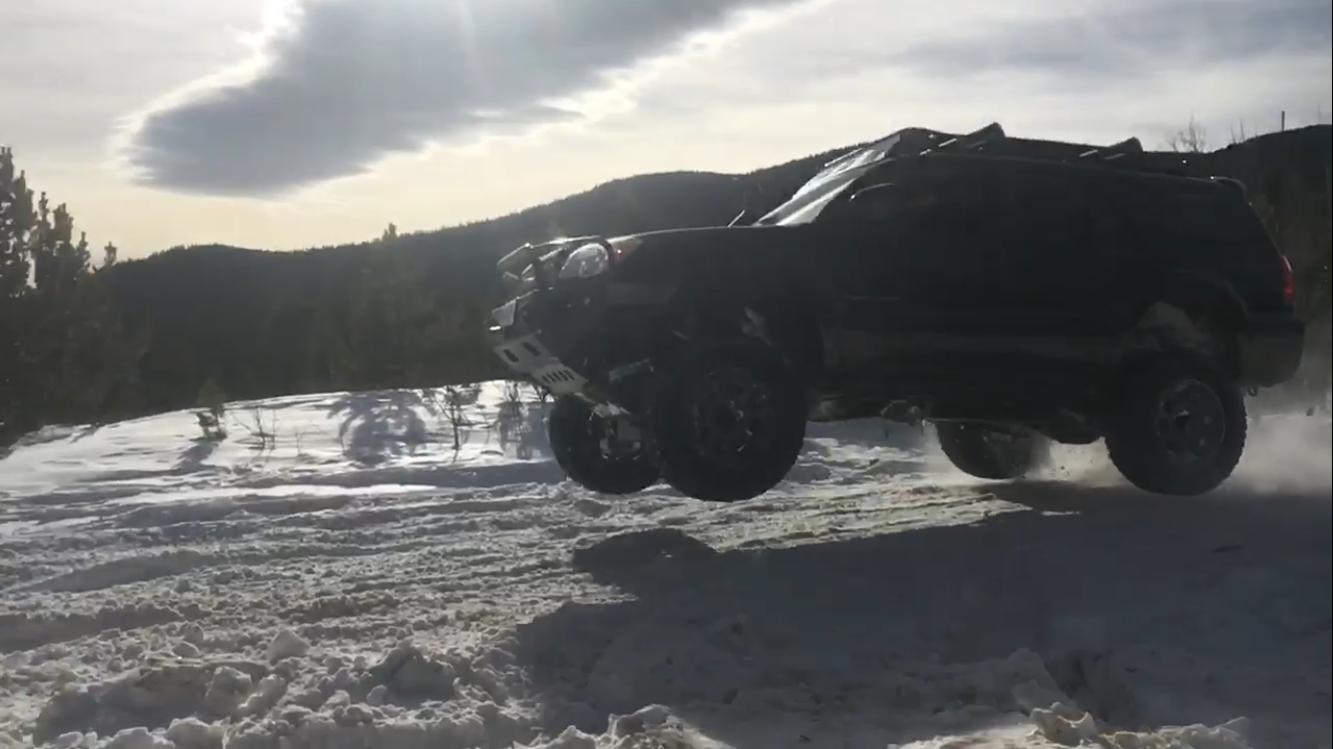

So a little update: Finally got to go with a bunch of Toyota guys up on a trail and test her out a few weekends back. DAmn! All I can see is it rides like butter. Just dropped her off with Insain Fabrication last week and getting the bumper all fab'd up! Stupid excited for this final touch! Also looking at the Matte Bronze Stealth 6 Rims, not too psyched running a 2" spacer (currently) in the rear to even the track width out. Figure I can go up a size in tires too to finish off this massive build. 285/75/17 Nitto Ridge Grappler. Should be all sorted here by the end of the month!!
Here are a few Teaser photos for ya from this past weekend:

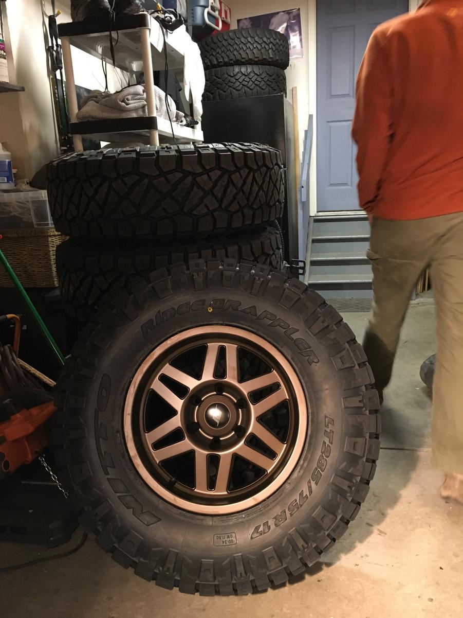

Literally counting down the days till I get the truck back from Insain Fab! Got the rims and tires last week. Here is a teaser of what the rims and tires look like. Hoping I get her back by the end of this week. So curious to how the rear bumper is going to come out!
