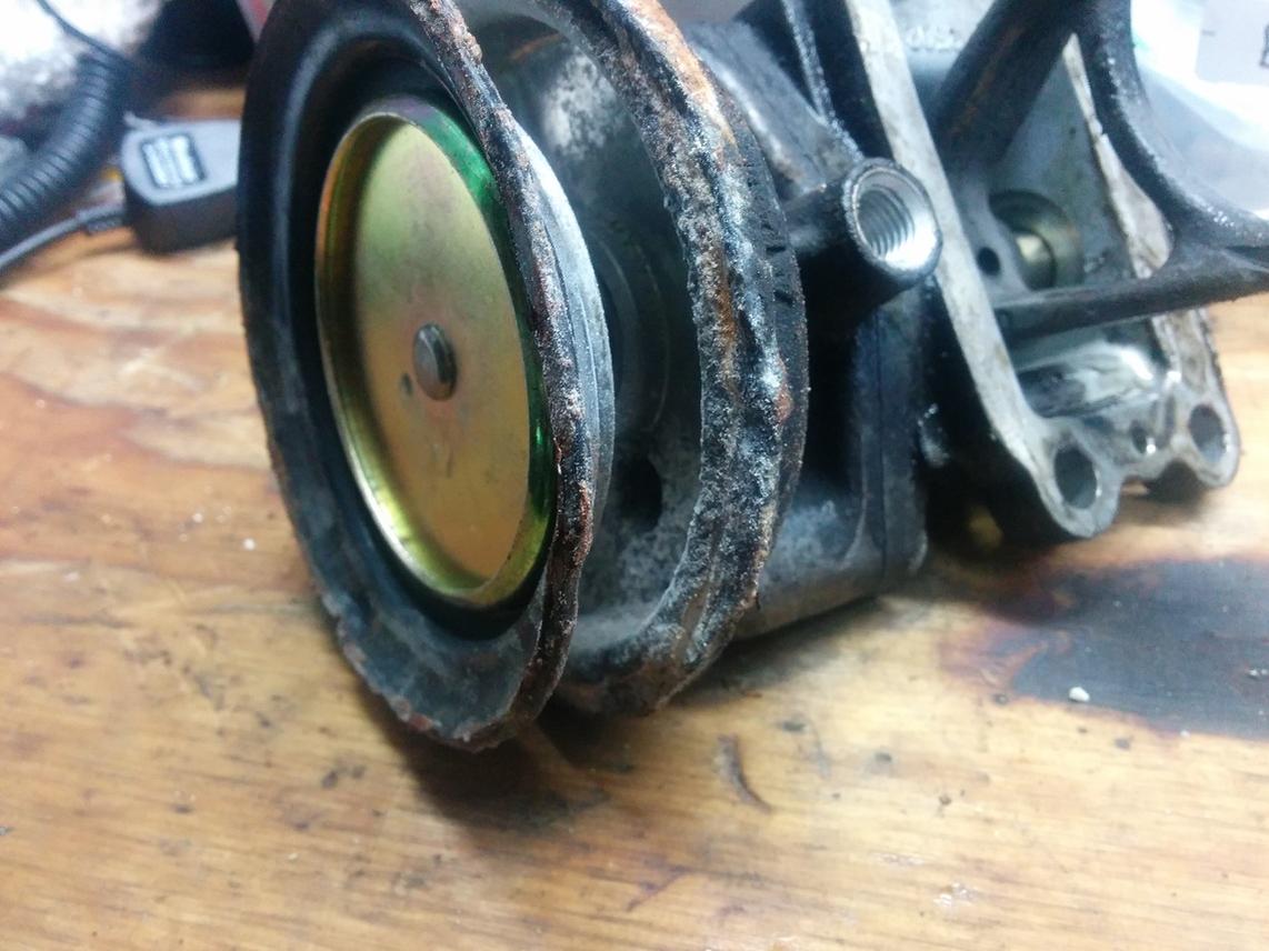

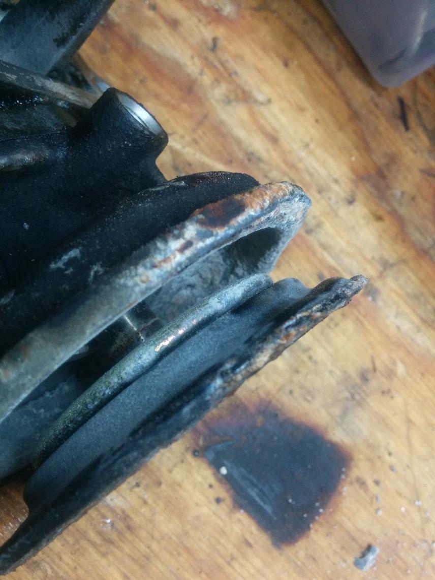

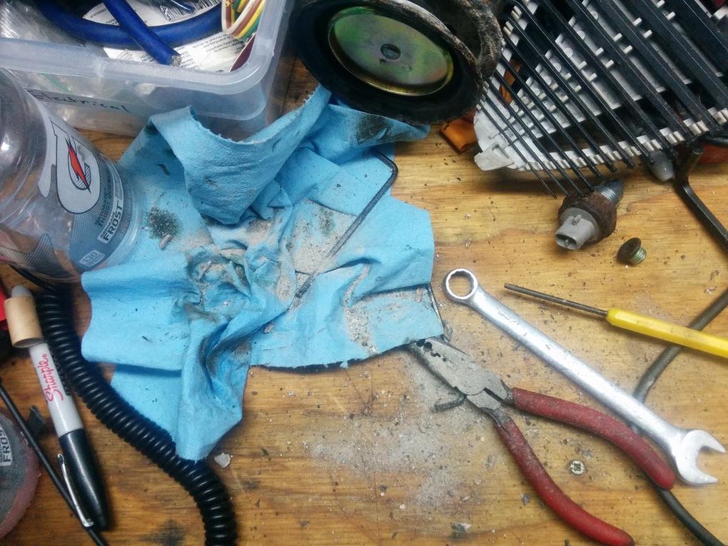

And since have the views of this thread are probably just people looking for interesting pictures (I mean, that's how I surf forums...), here are some pics of the corrosion hate...
First pic is what fell out after is removed the crimped on end cap
Second and third are the corroded sealing surface, supposed to be a groove for the gasket.
