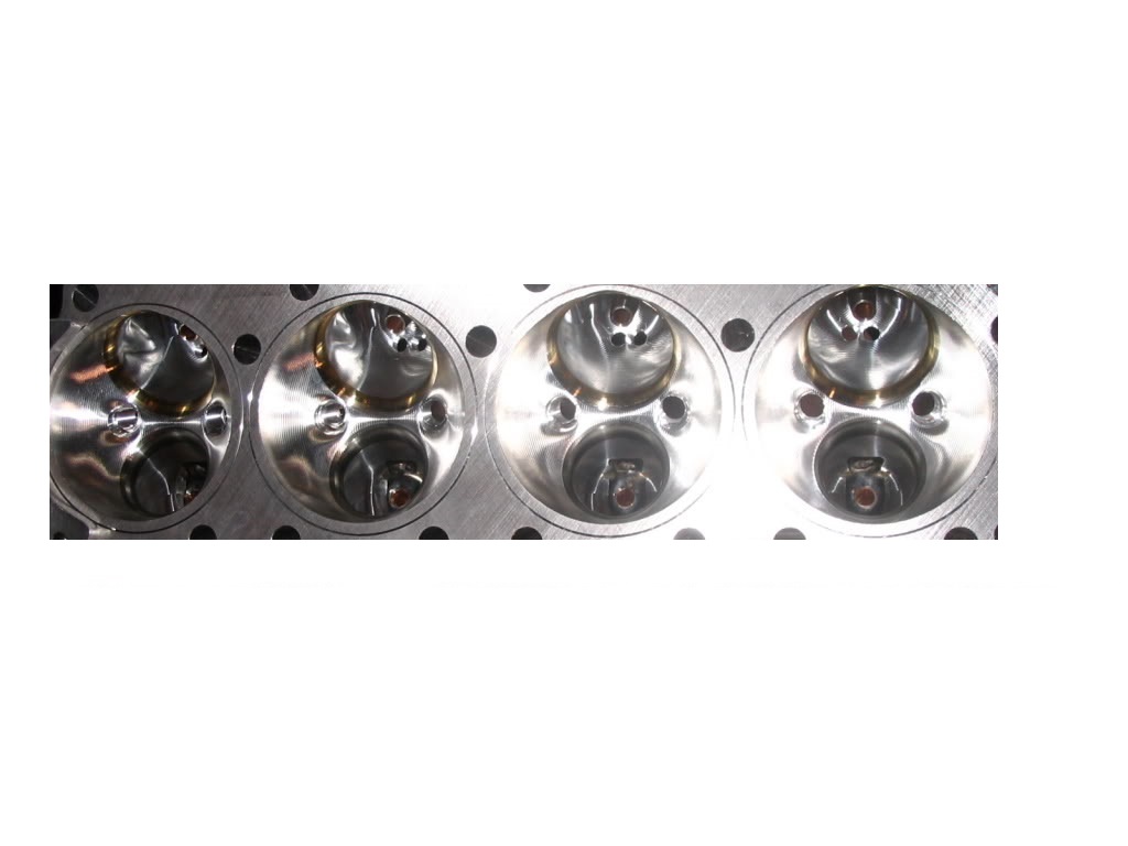

I don't have any pics of a 5VZ-FE cylinder head.
But if you just want to see valve seats installed in a cylinder head, here's a cylinder head I recently repaired. The combustion chamber 2nd from the left had extensive damage to the combustion chamber and both valve seats. Fixing it involved adding new aluminum to the chamber, machining it, installing new valve seats, cutting the seats, then a final cleanup of the combustion chambers.

Valve seats and aluminum heads are always a issue. Especially if overheated. I lost a intake valve seat on my ZX9 engine and it never was overheated. The Mopar 4.7 has exhaust seat issues. For the 4.7 they fall out. For my ZX9 it walked.

Just to be clear, the above pic is not a 5VZ-FE. In fact it's not for any street legal vehicle.
It isn't hard to work on cylinder heads with the proper tools and experience. Like anything, you need to know what you're doing.
I wouldn't recommend replacing valve seats on your daily driver, with no tools or prior experience. By the time you bought basic tools just to install them, you'd have spent more than having a competent shop that works on cylinder heads do the job. Then you'd still want to cut the seats, which takes special tools and experience to do it right.
