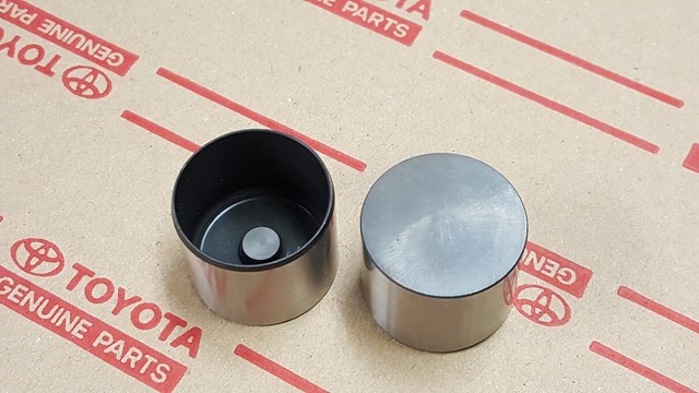

I know I'm late to this party but just in case anyone else runs into this. I recently ran into this issue. I took 4runner to the dealer due to valve tap I have been experiencing for quite a while now. They found the valve spacing was too far out of spec for shims. They recommended I remove the heads for inspection which was going to cost me another 4runner.
Luckily, the mechanic kept digging and found the wear was in the shim buckets which just pull out after you remove the exhaust cam. No need to undo the timing belt.
The nipple on the underside was worn smooth. After he swapped in new shim buckets and re-measuring with the original shims it was back in spec.
Also, shim buckets are only $20 a piece. I ended up replacing all the exhaust buckets since those were the only ones out of spec.
Engine sounds and runs like new now.
Common cause of this is running the engine low on oil.
Hope this helps.

Were your valves way loose? My exhaust valves are way tight, all of them, like 0.002 tight
If im not mistaken, these are shimless buckets you have pictured here, or shim under? The 5vz-fe uses shim over bucket style...
That's correct, shim under. You can convert a 5VZ-FE to a shim-under-bucket design from a kit from LC Engineering, that's on my to-do list when I re-do my heads to accomodate better my high-lift camshafts. I blew my last engine because a shim made its way out of the bucket. But stock, the shims ride on top of bucket in a small depression.
