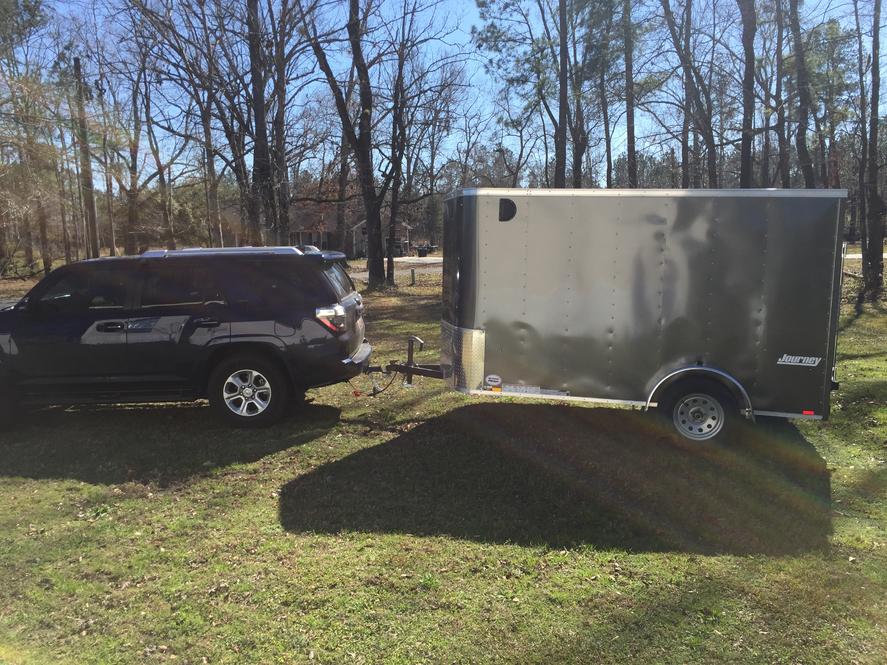

I didn't realize how much larger than my 4Runner it is
