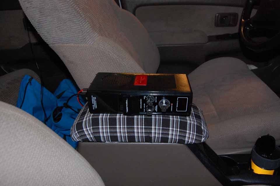

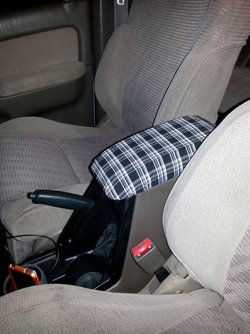

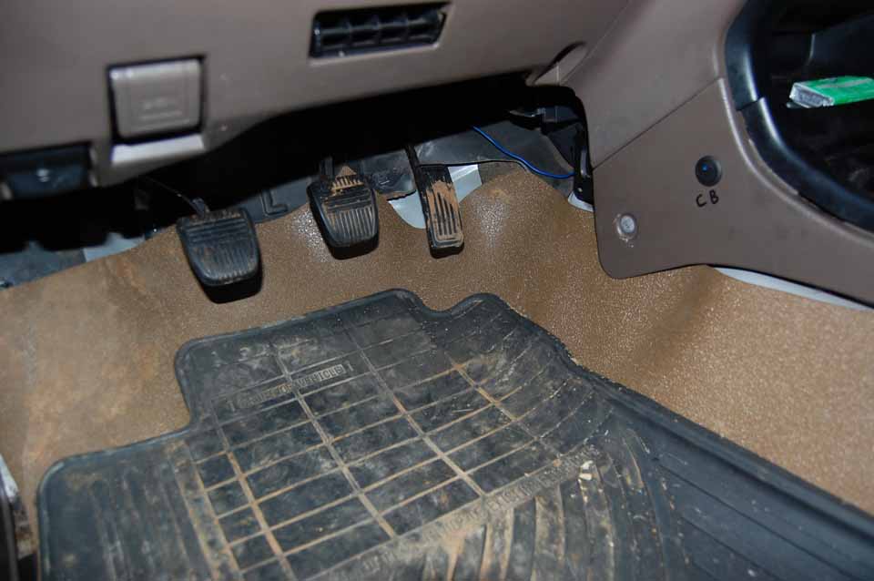

Pretty nice looking job, a little carpet padding underneath the factory mat will smooth all of that out. Is that plaid duct tape on the center console armrest????
Thanks! It has already smoothed out a little and there is padding under it. The plaid is fabric. I also added extra foam under the fabric on the center console.

Awesome....was only asking cuz, was gonna tell u to mail that SOB to me and let me recover it for you !!
Thanks! It was my first upholstery job and i think I did it pretty well. It's a lot better than cracked vinyl with a big hole in the plastic!

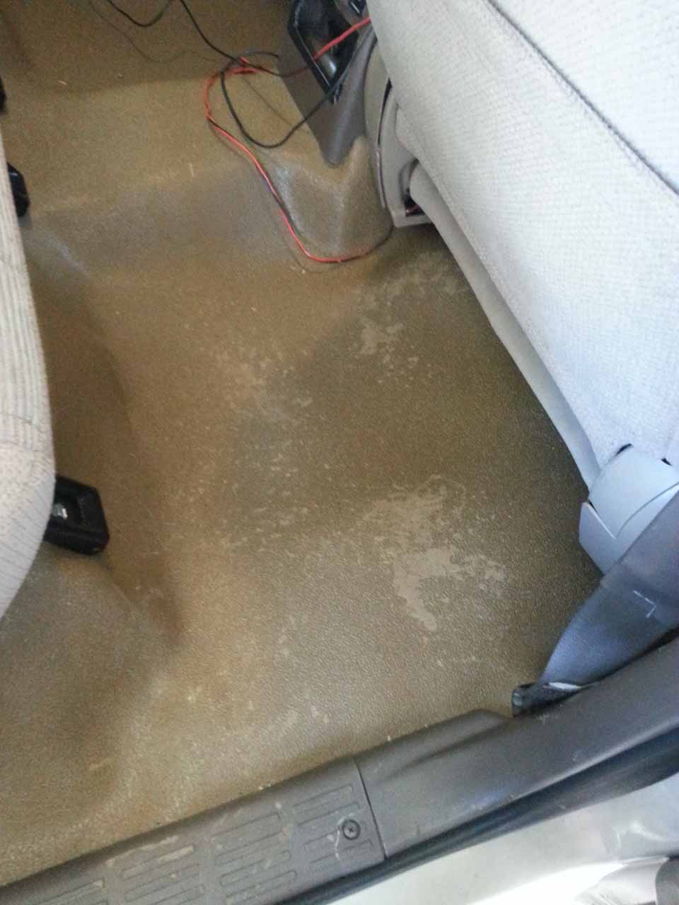

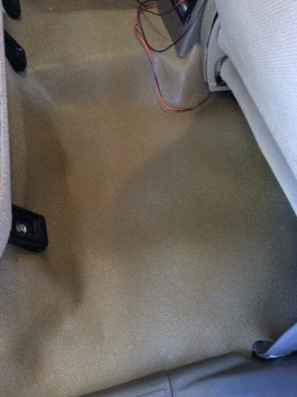

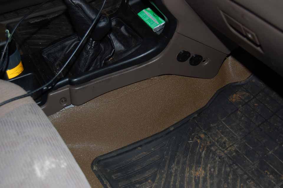

Cleanup
Very easy cleanup! Just sweet the chunks into a dustpan or vacuum them. Then wipe with a wet paper towel and dry with a hand towel.

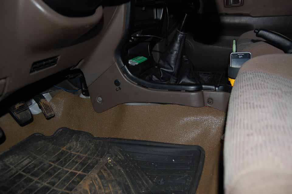

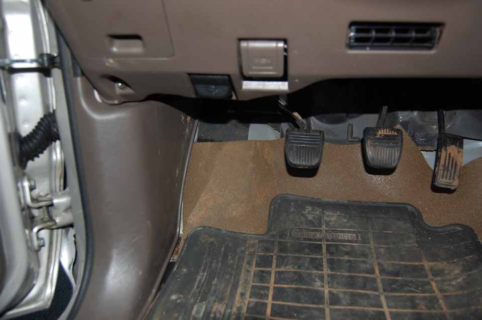

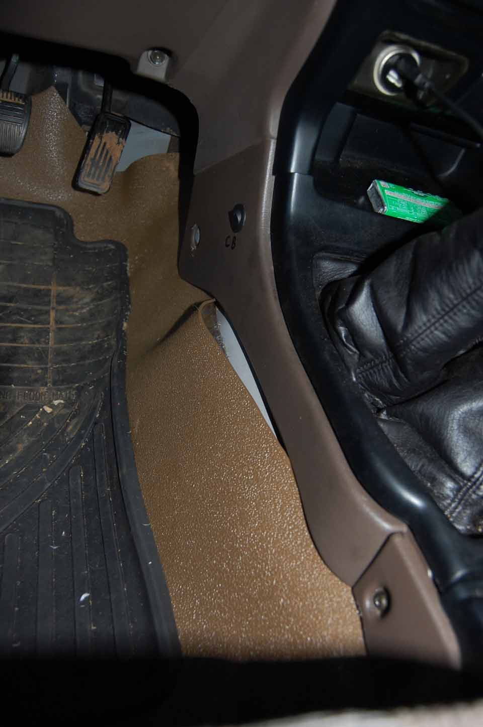

Update!
For anyone looking to do this, make the cuts smaller than the original carpet. Once it has settled completely with 100+ degree interior temperatures, it has revealed some open spots. Other than that, it has held up great and is something I would definitely do again.

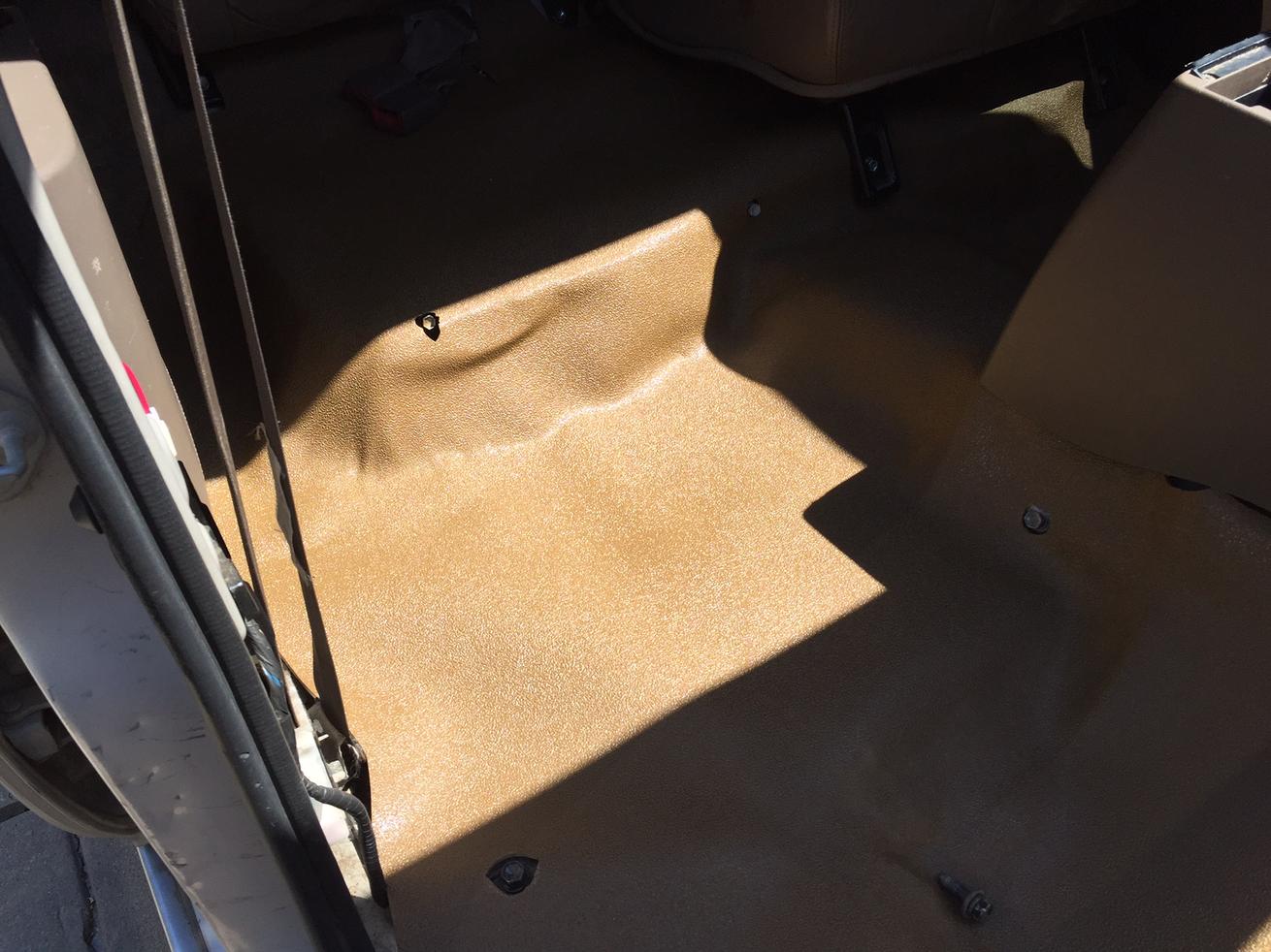

I wish I would have read this before I installed my vinyl floor. It came out pretty good, but had one little spot on the passenger console where I cut too close. I shoved a piece of vinyl behind it and will glue it, to clean up the look.
These floors are very moody with temperature, so measure 3x, cut once!
